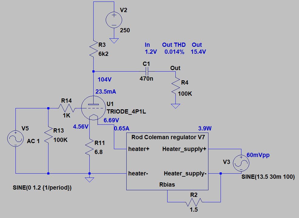

If you see the EL12n datasheet, the -recommended- bias is -7.5V (250V a-c, 72mA anode, 11 mA G2 current, 90R cathode resistor), so any driver tube fulfils 15Vpp swing (about 3-5x gain).

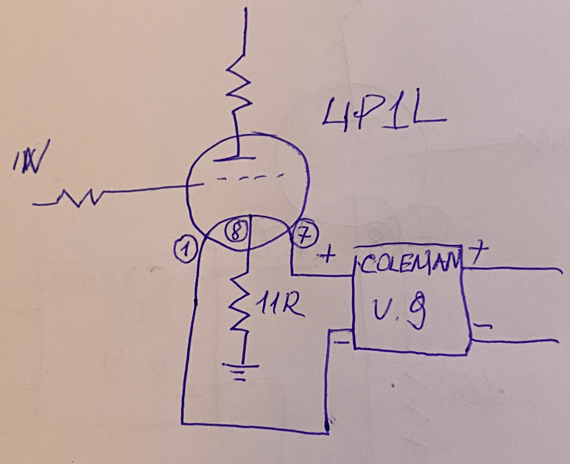

Unfortunately, I'm still focusing on powering 4p1l tubes with 4.2V due to the lack of the necessary power transformer and space. Please help me change the schema for 4.2V.

Simple Ohm law using.
4.2V, 0.325A filament.
If you want -about- 5..5.5V bias the filament bias resistor value:
5.5V - 2.1V (half of filament voltage)= 3.4V
3.4V/0.325A= 1.1R
If you use 1R, the estimated bias voltage is -about- 3.25+2.1= 5.35V.
The raw supply voltage of (0.325A) Rod Coleman regulator at least:
3.25V + 4.2V + 5V (R.C headroom)= 12.25V

Perhaps you have an error in the calculations
3.4V/0.325A=11R. and then there will be another bias offset accordingly

4.2V has a different connection than the 2.1V version for the Coleman regulator, as I know.
Bartola 4p1l
I have not found a connection in this version anywhere, everywhere they all show the connection in version 4.2V.
@Rod Coleman
Is it the right connection 4P1L + 4.2V + Filament bias?
Joined 2004

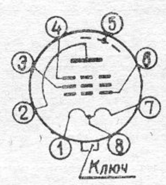

it's only the filament with center tap.
1-7 4.2V
Tied 1 and 7 - 8 2.1V
The sketched schematic is NOT filament bias device, the filament current flows between 1-7 (4.2V, 0.325A).
The tube cathode current via 11R makes (cathode) bias ... but only few hundred mV!!!

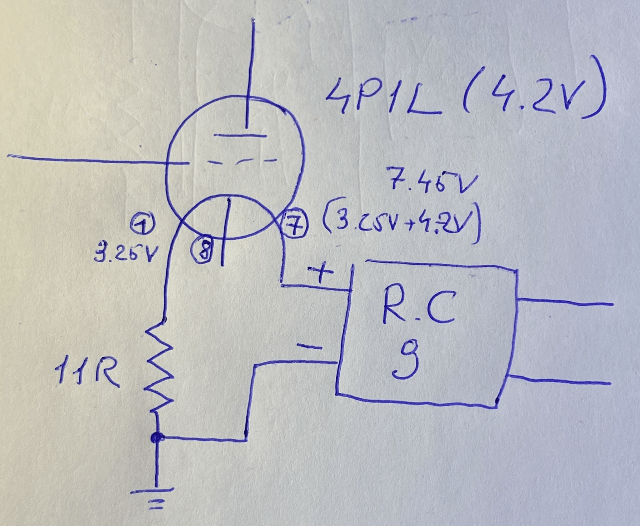

Joined 2004
My calculations relates to 10R in #1807, #1810 posts!
If you use 11R, the calculations as lower.
Really via filament bias resistor (11R) flowing the filament current + cathode current.
In this case the cathode current (about 25mA) vs. filament current (325mA) not negligible.
The correct current via filament bias resistor about 350mA.
On the 11R resistor (filament 1 pin) the voltage is 11R*0.35A= 3.85V
The voltage on filament 7 pin is 3.85+4.2= 8.05V.
If you want to use 10R, count it again, but as you can read later it's only theoretical calculation.
This -voltage on filament 7 pin- voltage can vary, depends of tube condition.
In case of worn DH tube the filament (cold, and hot too) resistance may increase (the filament thins out), but it's negligible. The important value is the filament voltage (in this case between 1-7).
If you adjust R.C. regulator to 0.325A (test it with filament bias resistor on R.C. output, set voltage V=R*I), must to check filament voltage (1-7) after few-ten minutes, and readjust R.C.
BTW in case of DH tube the -estimated- bias voltage not essential, in practice the anode current and anode voltage measuring gives the operating point.
p.s. Usually DIYers prefer 2.1V filament for 4P1L (better tone).
Reactions: 1 users
(7) : 7.45V (3.25V+4.2V) Coleman Reg +
(8): Float
(1): 3.25V > 11R
The V9 kit for 4P1L is supplied with R1 value for 4P1L with parallel-connected filaments. This gives less bias-skew for the triode curves, and should mean lower distortion.
RC-V9 R1 = 1.5Ω (2,1V 650mA).
Connect:
4P1L (7) + (1) = RC-V9 FIL+ output
4P1L (8) = Fil. Bias Resistor
(0V) = RC-V9 FIL- output
For the calculations, euro21 has already given a perfect answer.

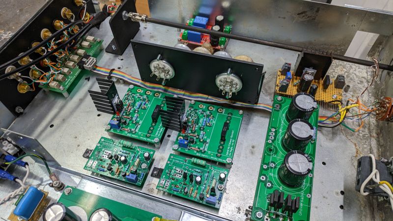

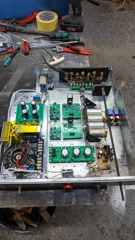

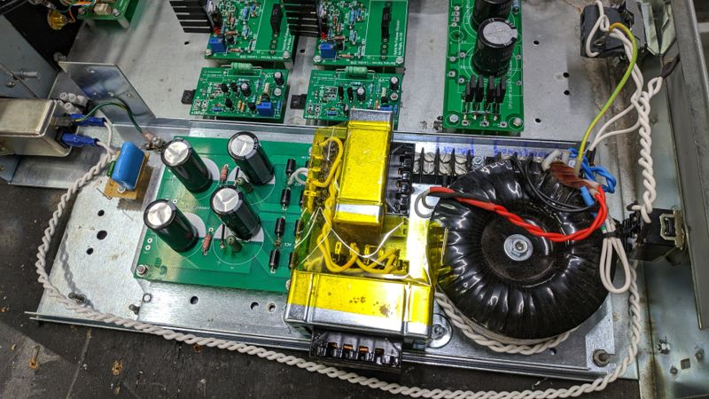

I've started putting together my 4p1l preamp. No moulds being broken here, I intend copying Ales gen 4 shamelessly, probably going to screen mode. Gyrator for the anode with Rods filament boards, and trying to keep transformers/rectifiers as far away from the signal parts as possible. Relay input switching and pot right at the back to keep paths short and hopefully address noise as much as possible. I have made up a bracket to hold the valves, it's angle brackets glued with silicone to a alu plate, and the whole thing is fixed to the base using rubber mounts. I think I'll use some ft3 in parallel giving 0.2uf for the output caps.
The transformers and filament raw DC are on a separate tray and I can mount this on some sorbothane or springs if vibration is an issue. I have a toroid for hv and two 15V transformers for the filaments.
So now to my questions:
Rod - will fixing the filament regs to the floor of the chassis (steel, thin enough) be good enough or do I need to add a thick alu plate for dissipation?
Filament bias resistor - I have some of those russian 10w 10r resistors, and was going to try a few sic diodes with them to get up to 13-14V. I see people talking about 25W resistors, but 10W seems heavy duty enough for 10r?
Heat burn for 4p1L is only 2 - 2.5W typically, so thin sheet is ok. But the interface to the transistor should be rust-free, polished smooth and flat. A very thin layer of thermal grease to finish.
