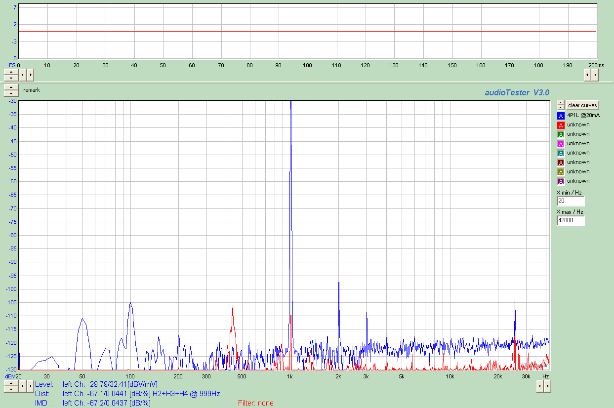

Well, fixed the Salas HV regulator. Set the shunt to nearly 70mA. Had to tweak the current set resistor to two 33 ohm in parallel (simulation suggested a 33 ohm resistor though).
Now the 50Hz and 100Hz peaks are even lower than before

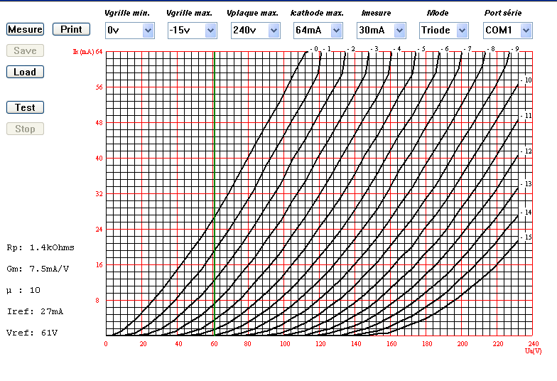

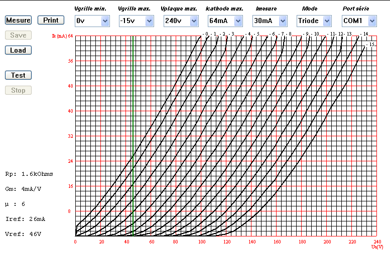

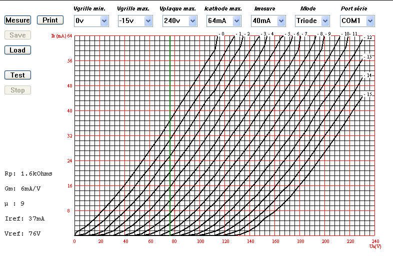

Hi Anatoliy,
Traced some curves on both 4P1L and 12P17L to compare both triode strapped performance. See attached.
12P17L is really linear albeit it has greater gm than the 4P1L. Valve book says gm=6 for 4P1L and gm=8 for 12P17L.
I thought you may find the 12P17L plot useful.
Also plotted the 4P1L with filaments running at 500mA which is how I used them on my Siberian Preamp. You can see that curves are flatter than when filament current is 660mA (both filaments in parallel).
Ale
