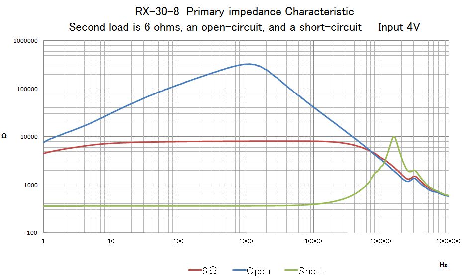

Is is not even good enough at 50Hz because the reactance is too similar to the resistive load. In fact I put a real measurement of an OPT where it can be clearly seen that with open secondary it does have quite higher impedance at low frequency when the secondary is unloaded. Regardless of this reflected impedance drops inevitably even when the secondary load is such that the reflected primary impedance should be 3-4 times lower!
This is it again: 8K/6R PP transformer. Such transformer is rated for 270H minimum inductance (with 4V applied voltage) and 560H maximum inductance. Frequency is not specified.
Actually the frequency for which inductance is specified can be derived from the curve with unloaded secondary. It is 50Hz!
In fact the impedance with unloaded secondary at 50 Hz is about 85 Kohm which means that L=85000/2pi50=270H that matches precisely the specs (i.e 270 H for 4V input).
If I did the wrong math as Mr Pieter did, not accounting for the resistive load, I would get a lower value for sure even at 1Hz....
