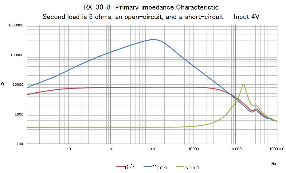

Hi Pierre,
since the schematic shows an unloaded interstage transformer, it does not have an impedance of it's own. the impedance values given by transformer manufacturers are a guideline for the usage. You would want something like 20k for the 6N7. What is of concern is the primary inductance. You want a value well above 100Hy for the 6N7.
Best regards
Thomas

Hi!
Yes, but what limits this impedance are the parasitics, primary inductance at the low frequency end and winding capacitances at the high frequency end. Of course there are other parasitics as well.
Every component has parasitics, capacitances and resistors for example have inductances.
Only when loaded on the secondary you get a useful impedance as with the red line in your graph.
Best regards
Thomas

As a rule of thumb you can consider the impedance at 20-30 Hz which is given by the primary inductance as this is usually the lowest value in the audio band.
Manufacturers usually specify a range of source impedances for interstage transformers that will work. Higher source impedance will have more limitations at low frequency of course. However it could behave better at high frequency.
I would go for something like the Lundahl LL1660/10mA for the 6SN7 because has got 130H primary inductance and 80 Vrms headroom at 20Hz before saturation starts. Running the 6SN7 at 220V/10mA there would be enough headroom to drive the 45 even at 20Hz with acceptable distortion. At 220V/10mA I have found that NOS 6SN7GTB's have a typical gm of 3.3 mA/V. So I would expect -1dB around 15Hz using the above IT. It could well happen that one gets harmonic cancellation too....
