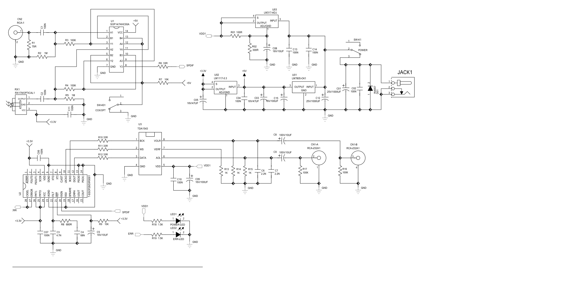

I have no experience with those, so no comments to offer here. If you're just starting out then begin with the simplest design - a single TDA1543 and DIR9001 like this one:
High end DAC TDA1543 DIR9001 kit DIY WH-1 | eBay
That board was my starting point for developing beautiful NOS sound.
Does anyone have the schematic for this? I would like to run this dac with two seperate power supplies. I have 3.3v running from an external source (post regulator) to existing 3.3 regulator that powers the digital circuits. I would like to power dacs isolated with the LM317 already onboard.
I think this requires digital grounds to be kept separate on the board. The whole board has a ground plane built in though. :|
I've managed to work out the GND joints around the output side of the dac(s), however the LM317 is an adjustable regulator type, i.e. the ground there is less obvious; there is a few of components dotted around the regulator, which powers only the 43s. I know the 43s have decoupling caps and ground pins themselves and would like to keep the ground at DC jack, dac and output section seperate from the digital section if that makes sense (?)
Any idea best place to contact? (maybe the expert can chime in)
