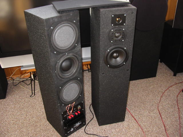

OK here's the latest 3.5 way.
On the back:
TB 8"
2 X 8" PR
plate amp
on the front:
MCM 7"
Foster 1.5" dome mid
1" titanium dome tweet
1" multi lam ply, 42" high, approx 90 lbs .
Initial sound check is good but way different sounding than the last pair.
I think I'm done for a while.
Cal

What kind of finish?
Cal,
Look very good.
What is the finish on those? Spray resin (truck liner)?
I thought about buying some Bryston Powerpac for the impending speakers, but little too expensive for my taste.
Now I must try to get some time build the cabinet soon.
Thanks Gengis,
It's "Accents" by Rust-Oleum. This is the "Stone Creations", black granite. Comes in regular spray can.
I like to give it two thick coats of regular black paint, applied with a roller and then use the stone creations. One can per cabinet, top, front and sides only.
Only drawback I see is that it takes forever to dry. A week and they are still a little tacky. The Coax units are now finally dry after 4 weeks.
