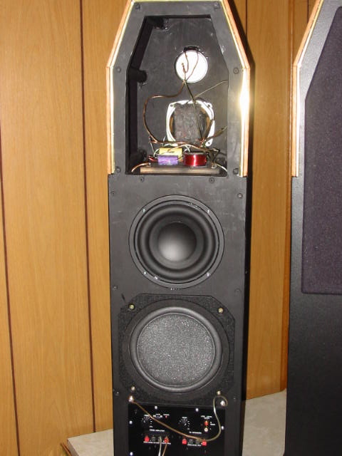

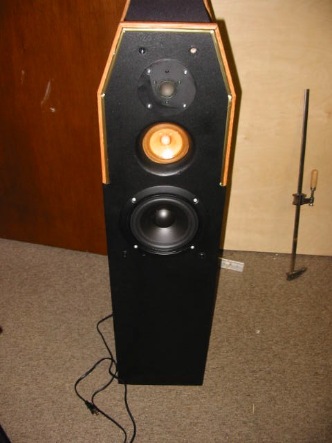

OK here's the latest 3.5 way.
On the back:
TB 8"
2 X 8" PR
plate amp
on the front:
MCM 7"
Foster 1.5" dome mid
1" titanium dome tweet
1" multi lam ply, 42" high, approx 90 lbs .
Initial sound check is good but way different sounding than the last pair.
I think I'm done for a while.
Cal

Thanks Gengis,
It's "Accents" by Rust-Oleum. This is the "Stone Creations", black granite. Comes in regular spray can.
I like to give it two thick coats of regular black paint, applied with a roller and then use the stone creations. One can per cabinet, top, front and sides only.
Only drawback I see is that it takes forever to dry. A week and they are still a little tacky. The Coax units are now finally dry after 4 weeks.
Cal

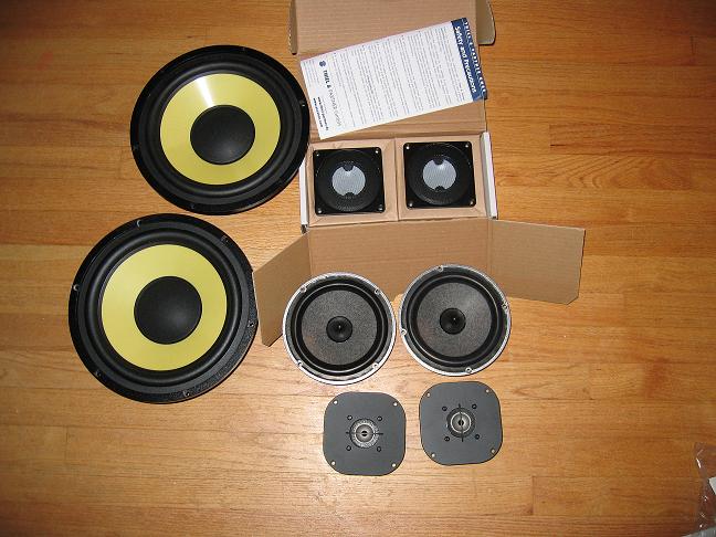

Cal Weldon said:I can't do the listening test yet because I'm waiting for the 16 ohm Coral mids to arrive
Now I can. And it only took me 20 minutes to extract them from the bombproof box!
Thanks planet 10 dave. The Corals sound great in their new home. Jimmy Buffett never sounded better.
