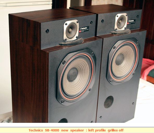

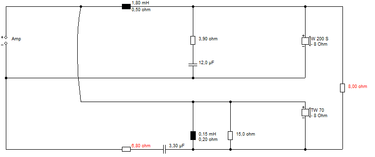

Rambling sort of thread, this. But I'm following it. I thought I'd look at a two way equivalent, and skip the mid altogether, which goes where the 8R resistor is. I also did it linear phase, because I can.
On a flat baffle you have to flip tweeter polarity. I did a bit of impedance correction on the cone tweeter too, but it's not compulsory. Not bad at all. :)

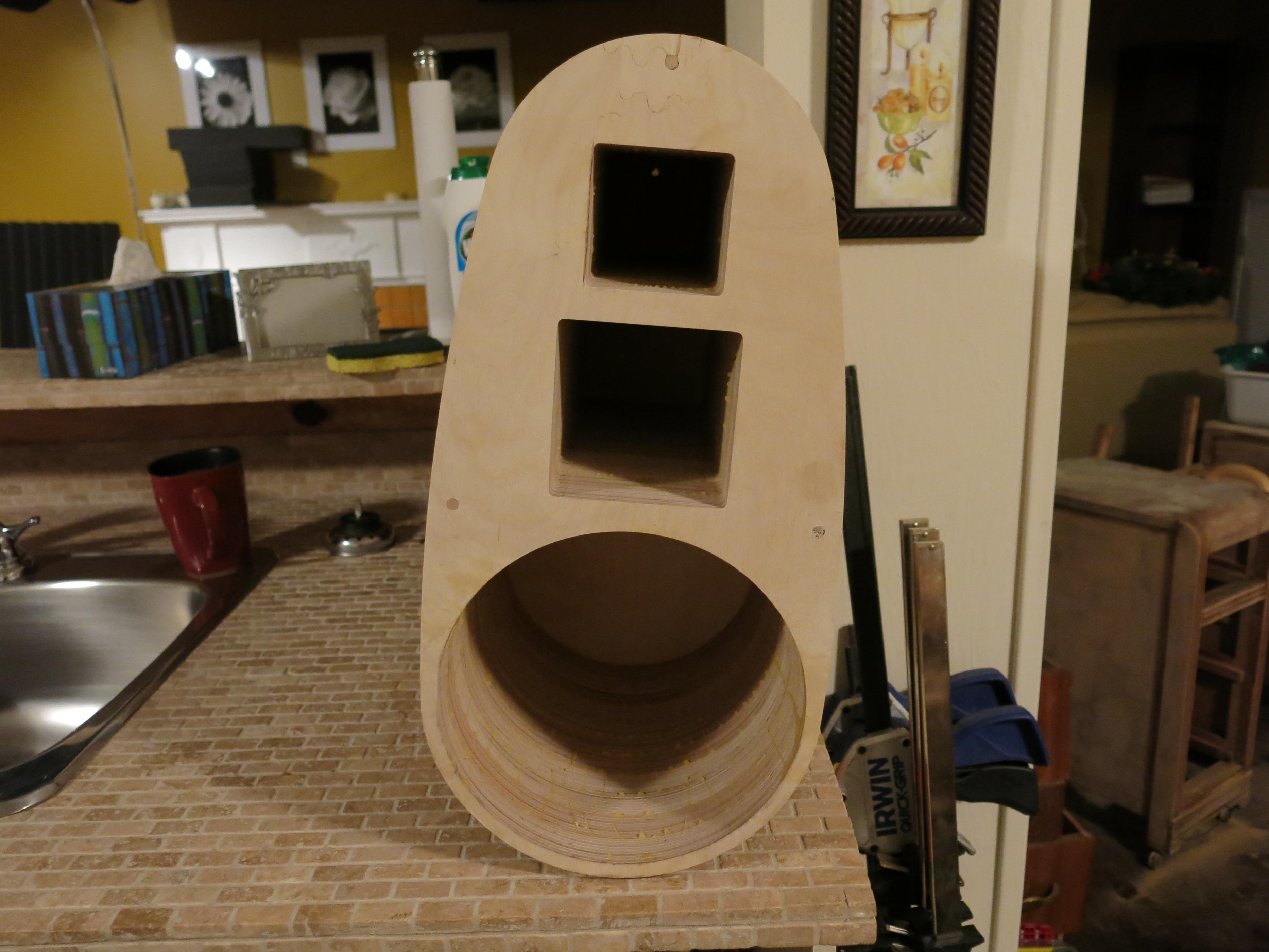

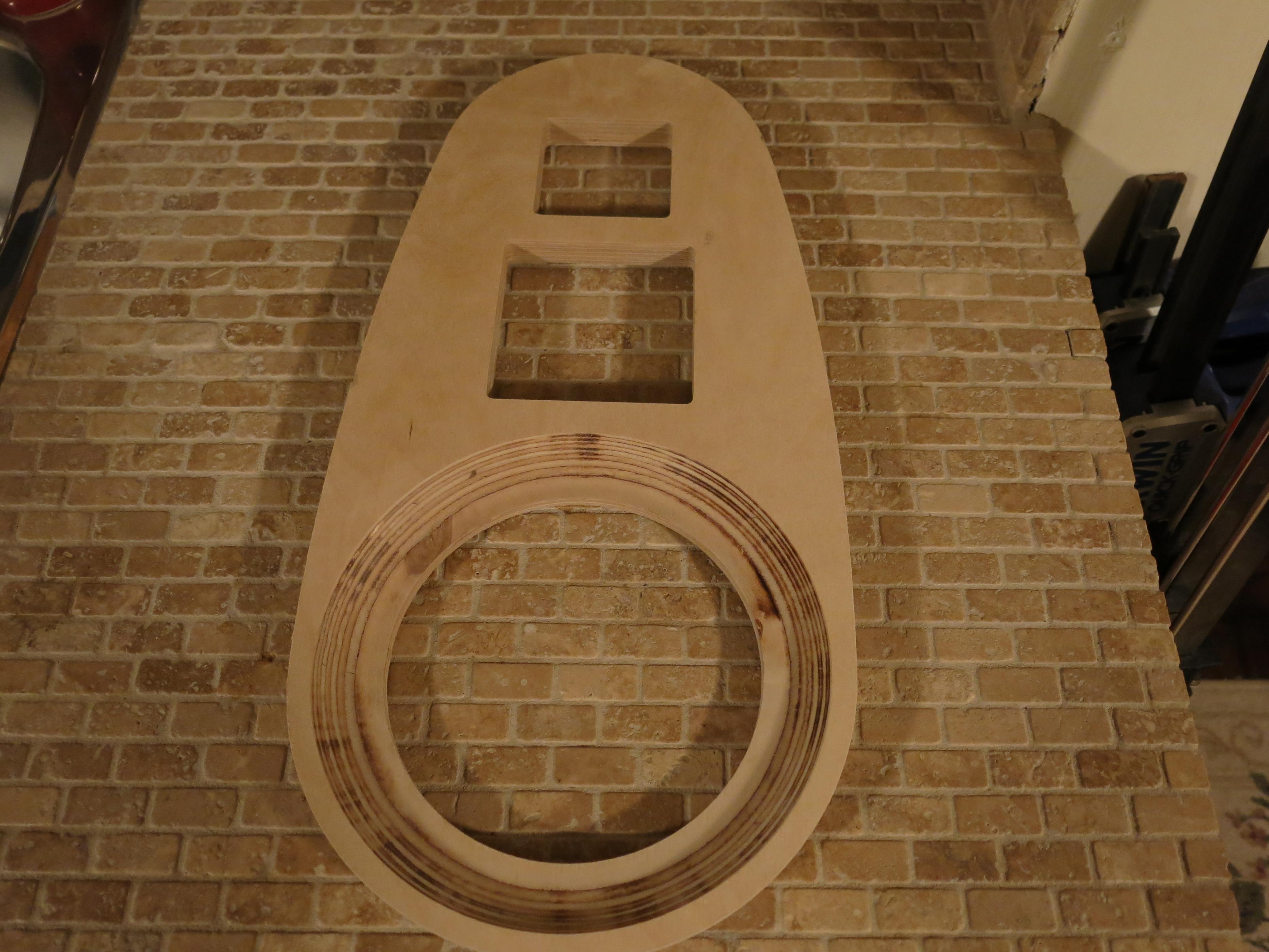

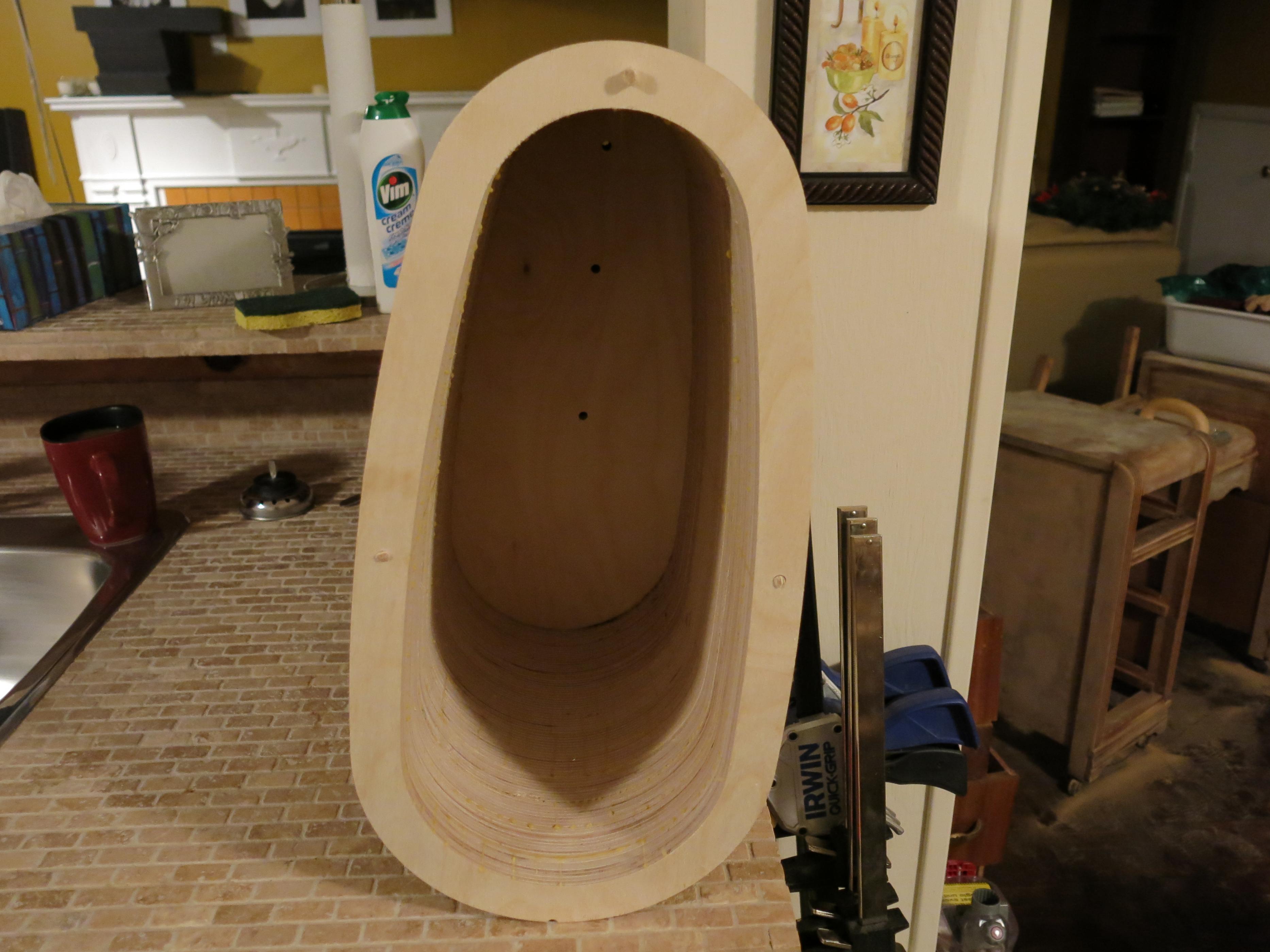

Picture 1) I've now chamfered the inside edge of the TD6M's opening.

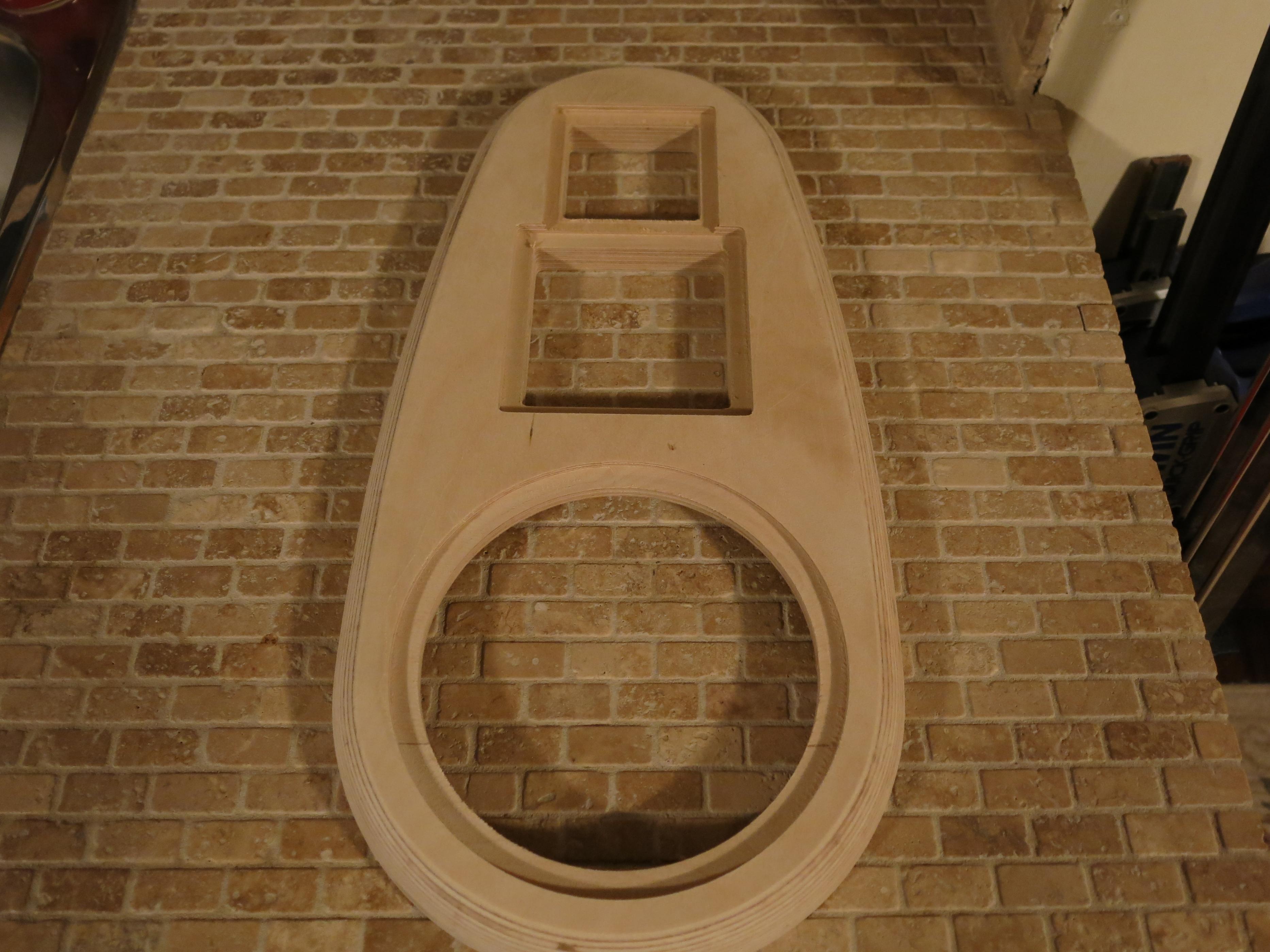

Picture 2) Front of the baffle with the partial 1" roundover. I think I'm going to 'round' it more. I had never used a router table before, so I thought I should get the hang of it first.

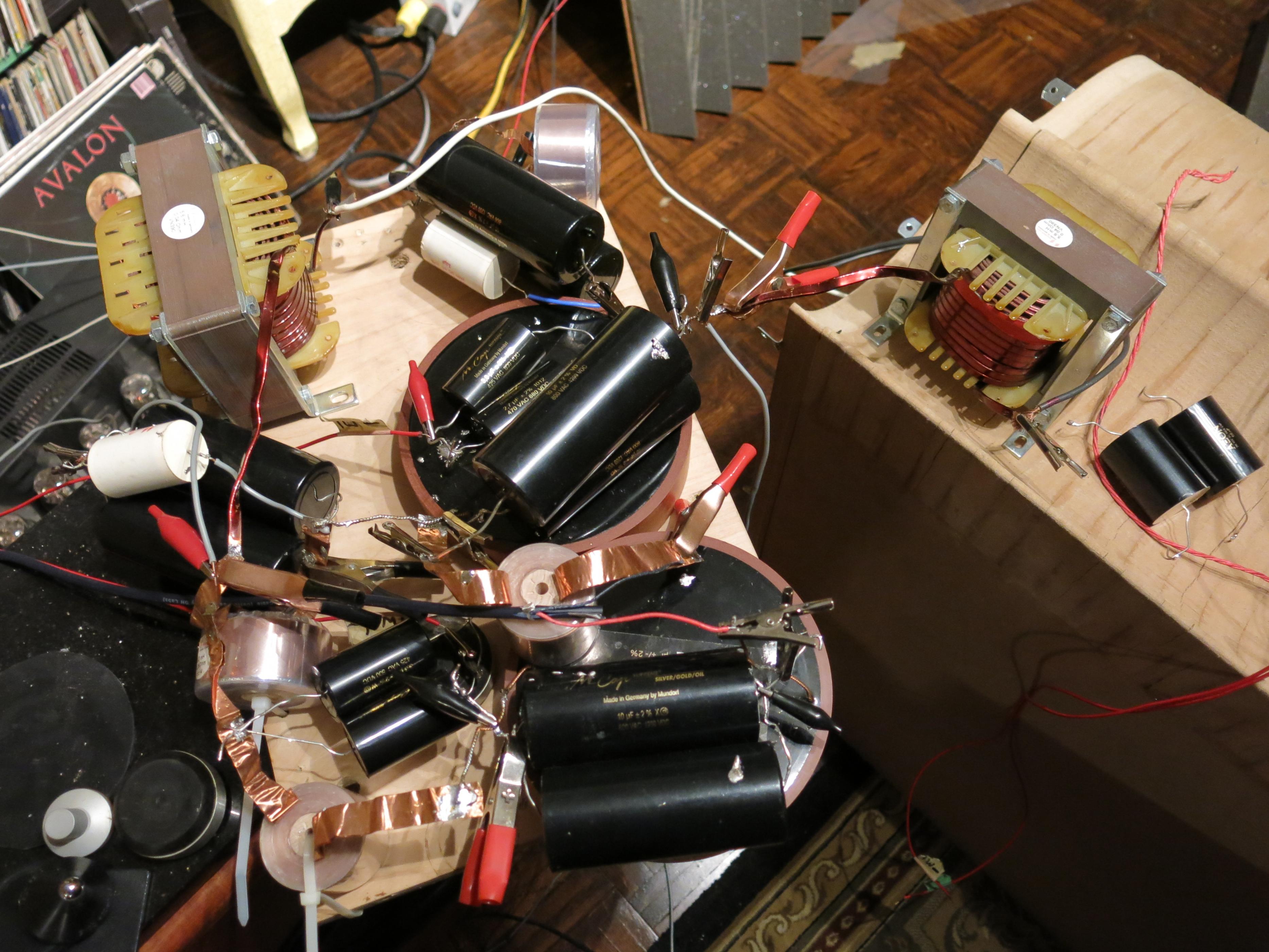

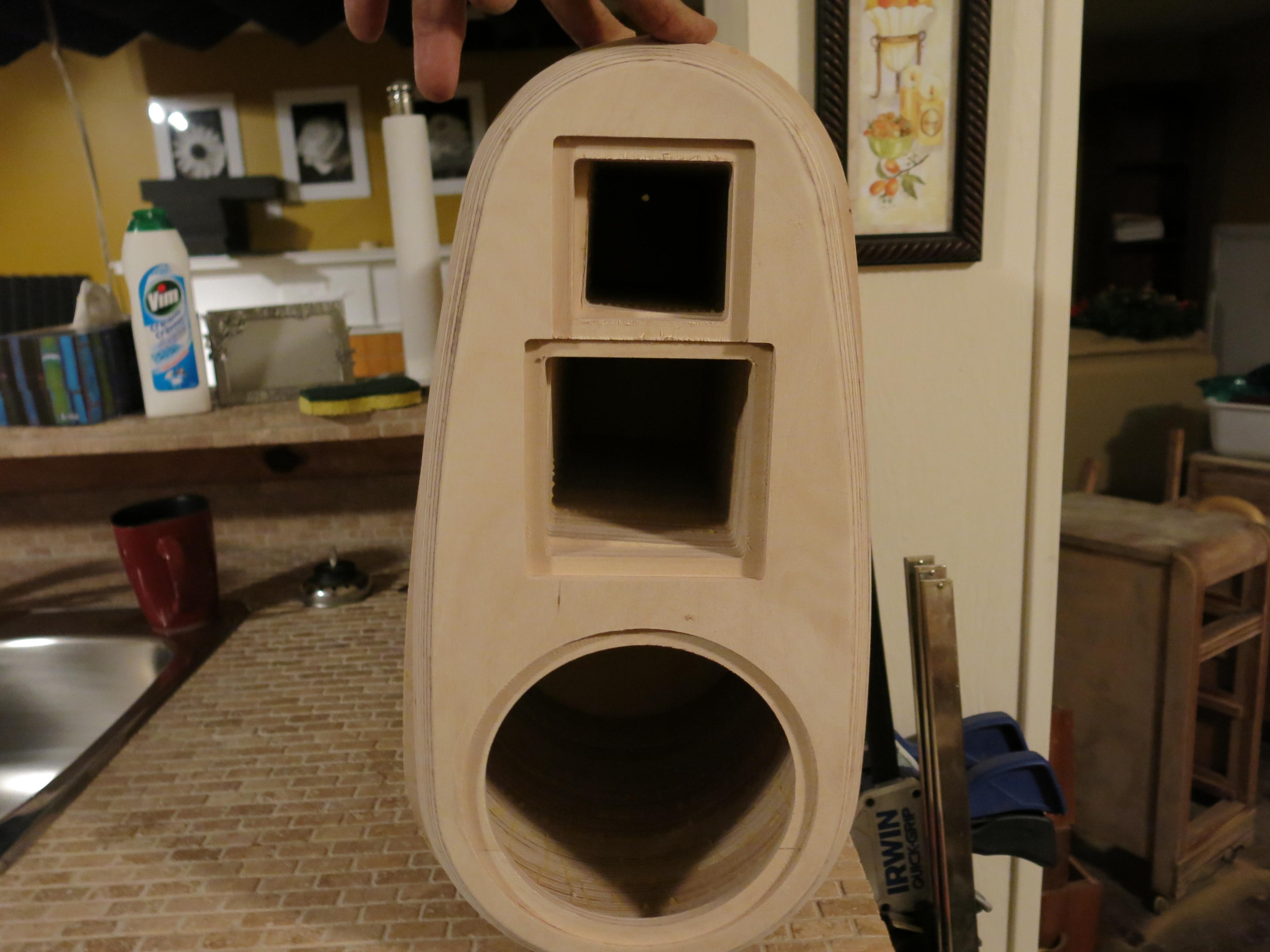

Picture 3) The back cavity for the crossover parts. I'm not sure all the parts are going to fit?
Picture 4) The crossover parts. The last thing I want to do is put one of the woofers inductors in the woofer compartment.

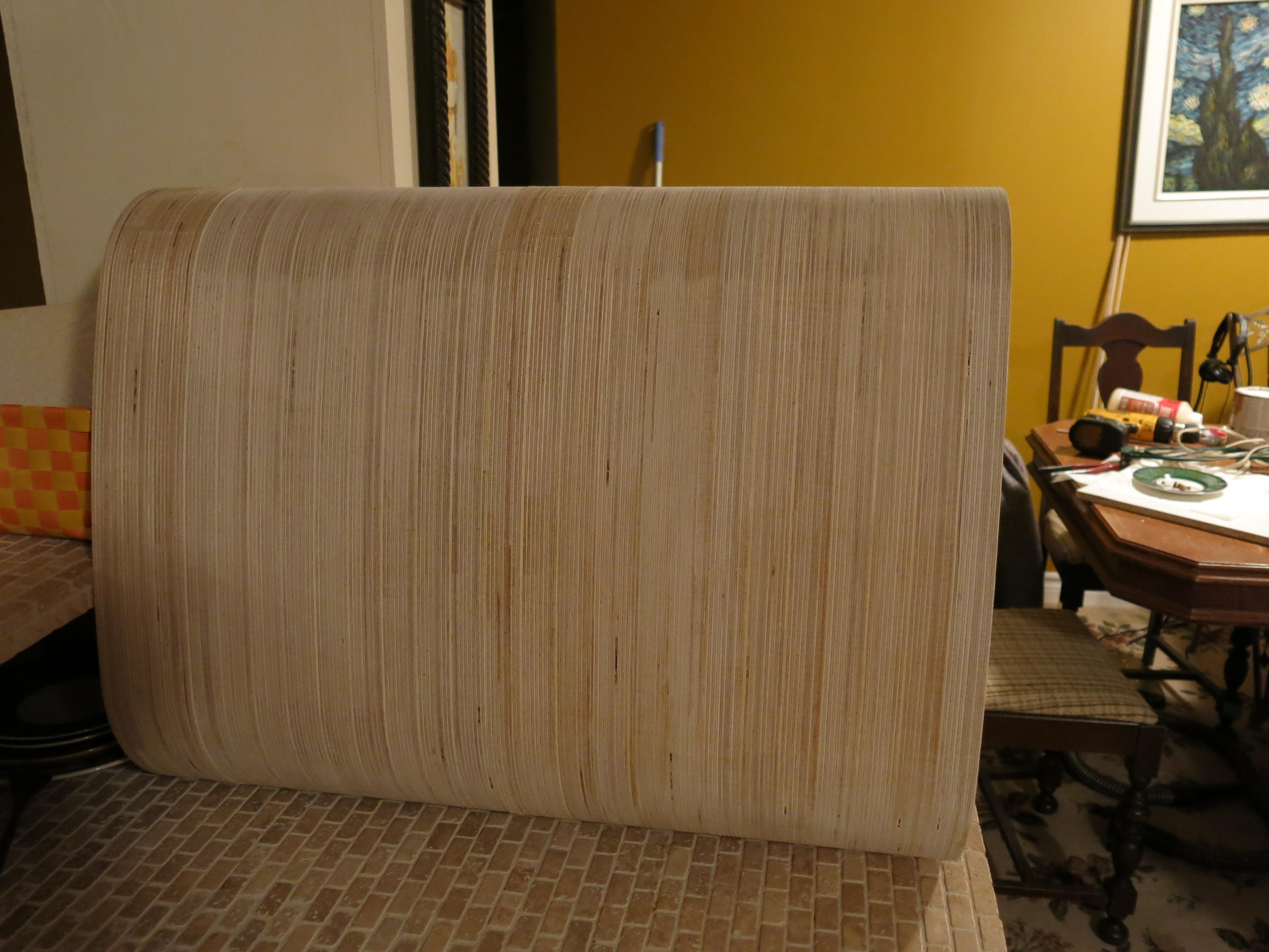

Picture 5) Front of the upper box, without the baffle.
Picture 6) Side view, 23" deep. The front baffle will make it 24" deep.
Picture 7) What the front will look like once I router and install the baffle.
Some of you noticed the tweeter compartment is separate from the mid compartment which is separate from the mid woofer compartment.
Some of you may think I am sane?
Why the separate compartments?
I'm going to cannibalize my $2,900.00 Accuton BD20 Diamond tweeters?.
I'm gong to cannibalize my Accuton C50 midranges?.
Curiosity killed the cat?

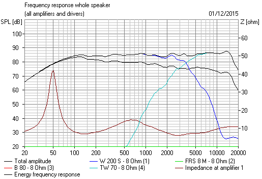

Steve

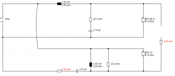

With your frequency response graph.
The low pass on the W200S woofer is impressive.
Would you say it's a function of the woofer itself, or is the crossover doing that?
It's a high inductance woofer with steep natural rolloff, around 2.2mH Le, so the shunt capacitor gets a damping resistor to keep it from peaking. You won't need that with a low inductance woofer.

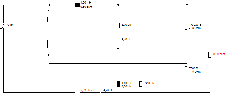

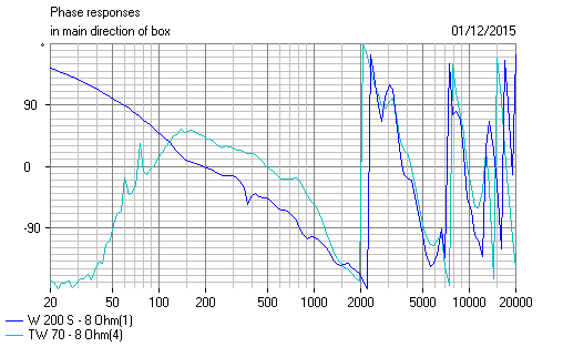

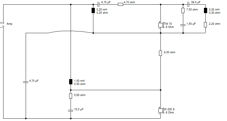

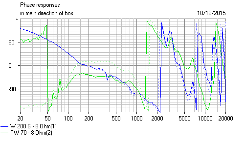

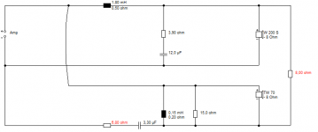

Good Morning, Bill. I've been doing some theoretical stuff on your crossover. :cool:
I set up a parallel circuit to replicate your series filter. It's a bit weird looking, but it IS a parallel circuit, just I've had to lay it out differently to do what I want. This is called the target response method.
Basically the tweeter and bass are given an interaction via the 8 ohm resistor. Sounds familiar? Then I twiddle a few values to match them with and without the 8 ohm resistor.
Your circuit does 3 things better than the pure parallel equivalent. It has better impedance. It has better phase, and it is much less sensitive to component values. I can't quite think about what the interaction does. Yours is the solid line. The parallel is the dotted line. Interesting, eh?
Hello Steve
Nice work.
At this point, I am the student, and you are the teacher.
With regards to your second picture, phase.
Am I safe in making the following observation and statement; the woofer has its phase shift at approximately 2200Hz. The tweeter has its phase shift at approximately 1500Hz. Is it theoretically ideal to have the two lines (shifts) at the same frequency?
