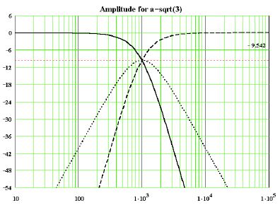

A quick recap.
This is for the Tweeter - Midrange x-over point. This is for our crossover topology.
The inductor value, which is typically 1/2 the value of what a parallel crossover would call for, is correct.
The capacitor, which is typically 2 times the value of what a parallel crossover would call for, is wrong. At least for our circuit.
For best distortion measurements, the multiplication factor from parallel to series should be 2.5 times.

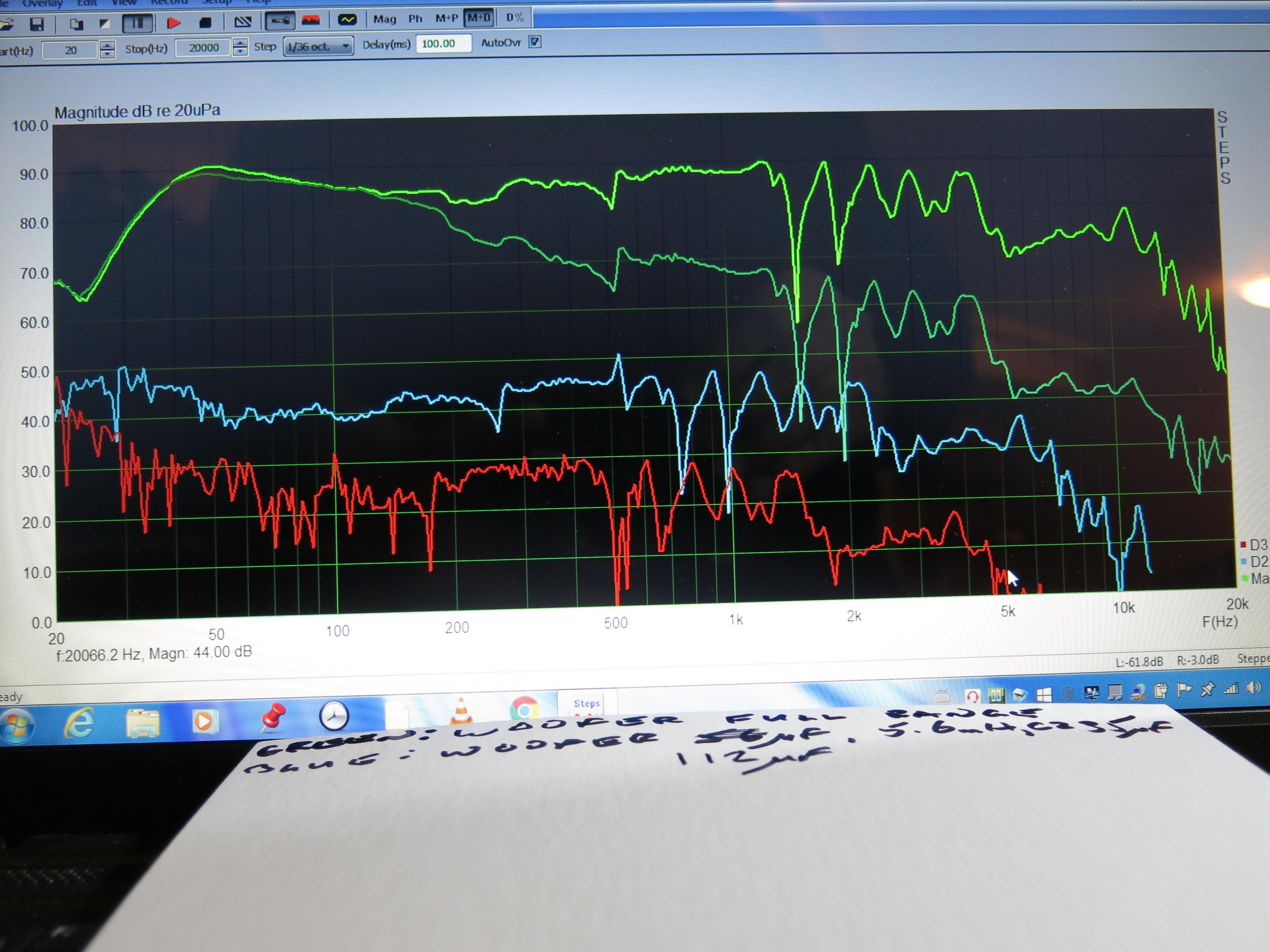

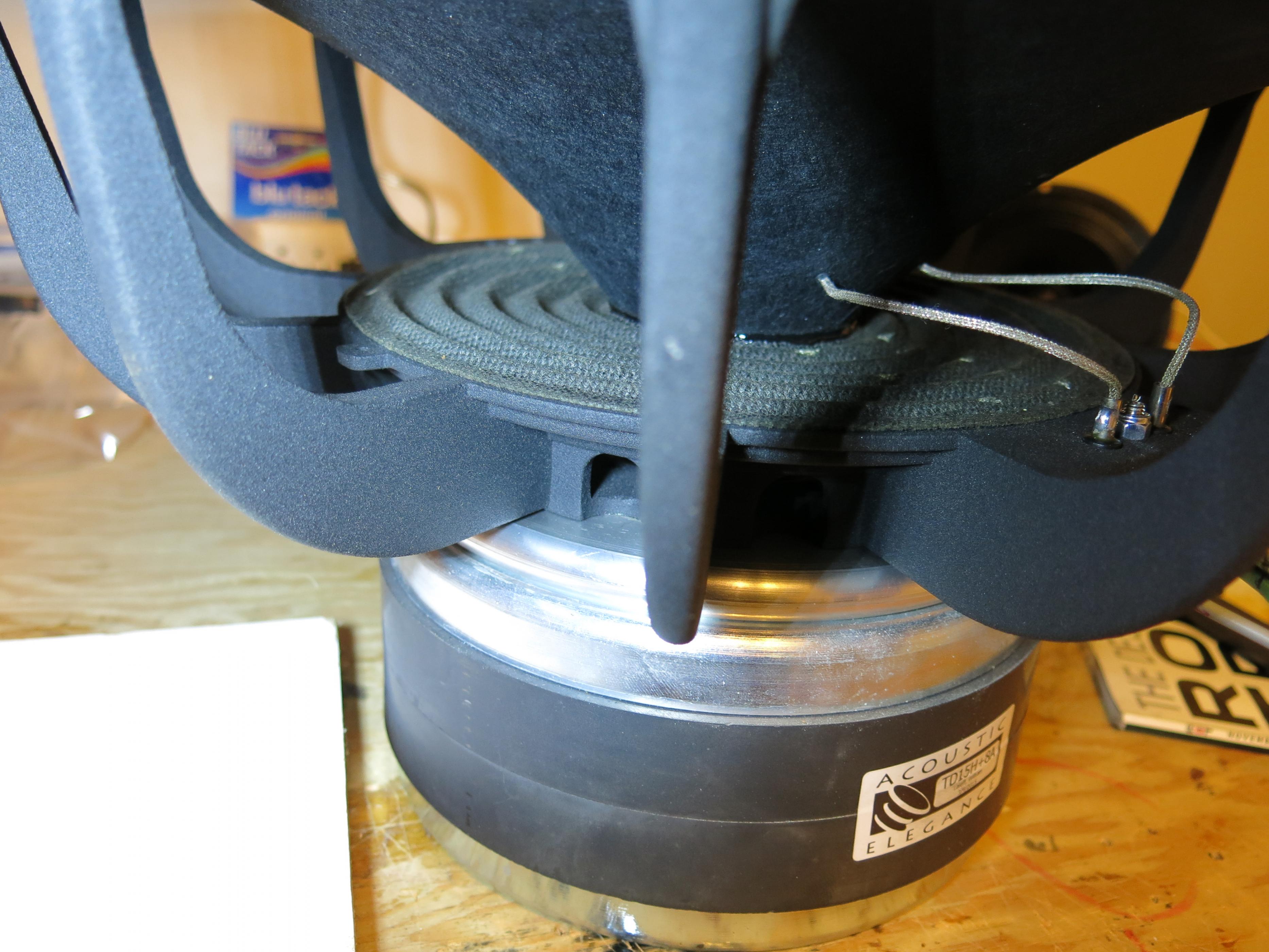

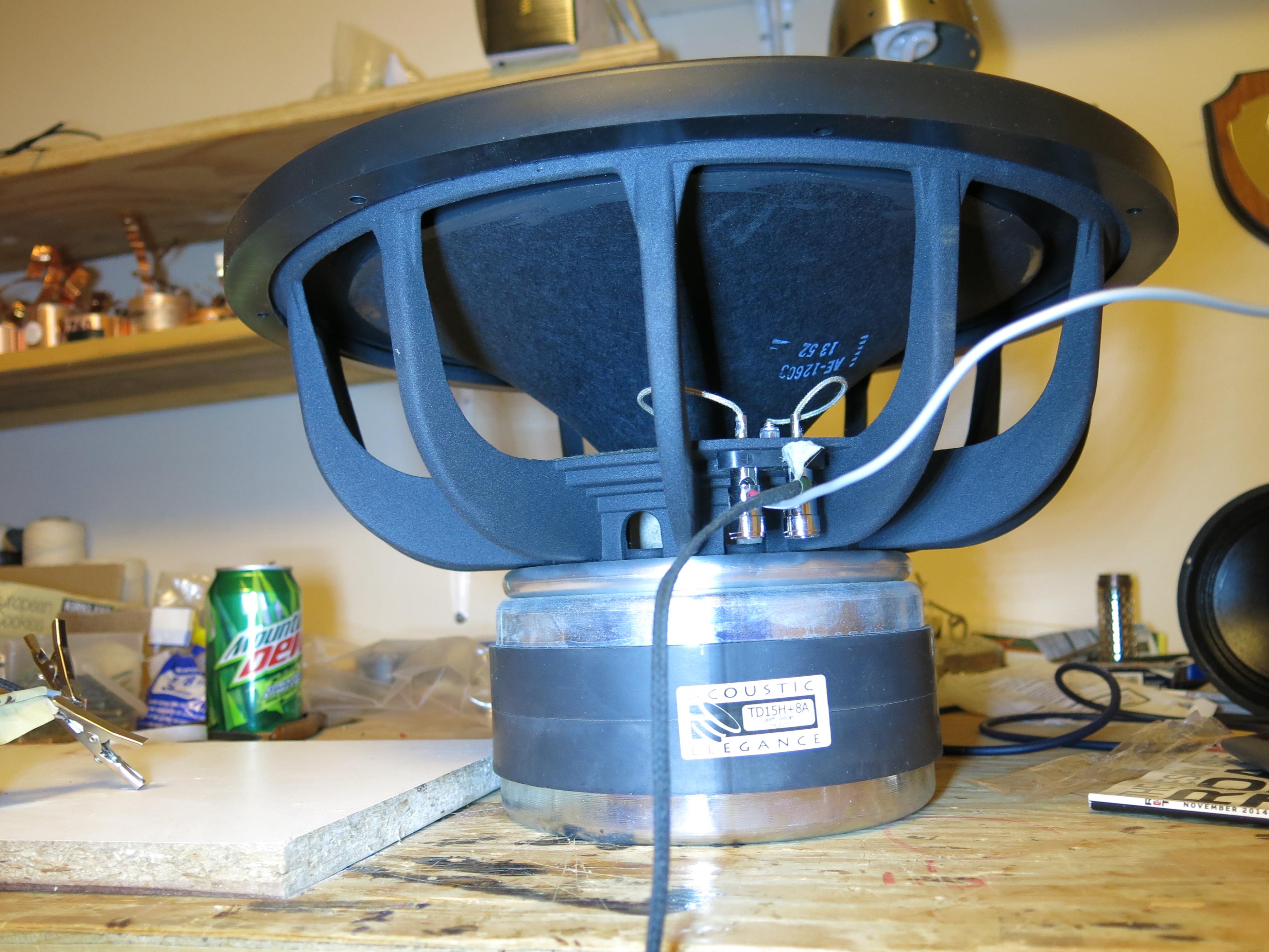

Let's look at our Acoustic Elegance TD15H+ driver.
Picture 1 & 2) Very solid build. 40+ Lbs. We are going to have a lot of fun removing, adding closed cell foam in places, replacing the driver back in box, measuring, removing, adding more stuff, replacing etc. You getta da picture. These observation will come in the next few days.

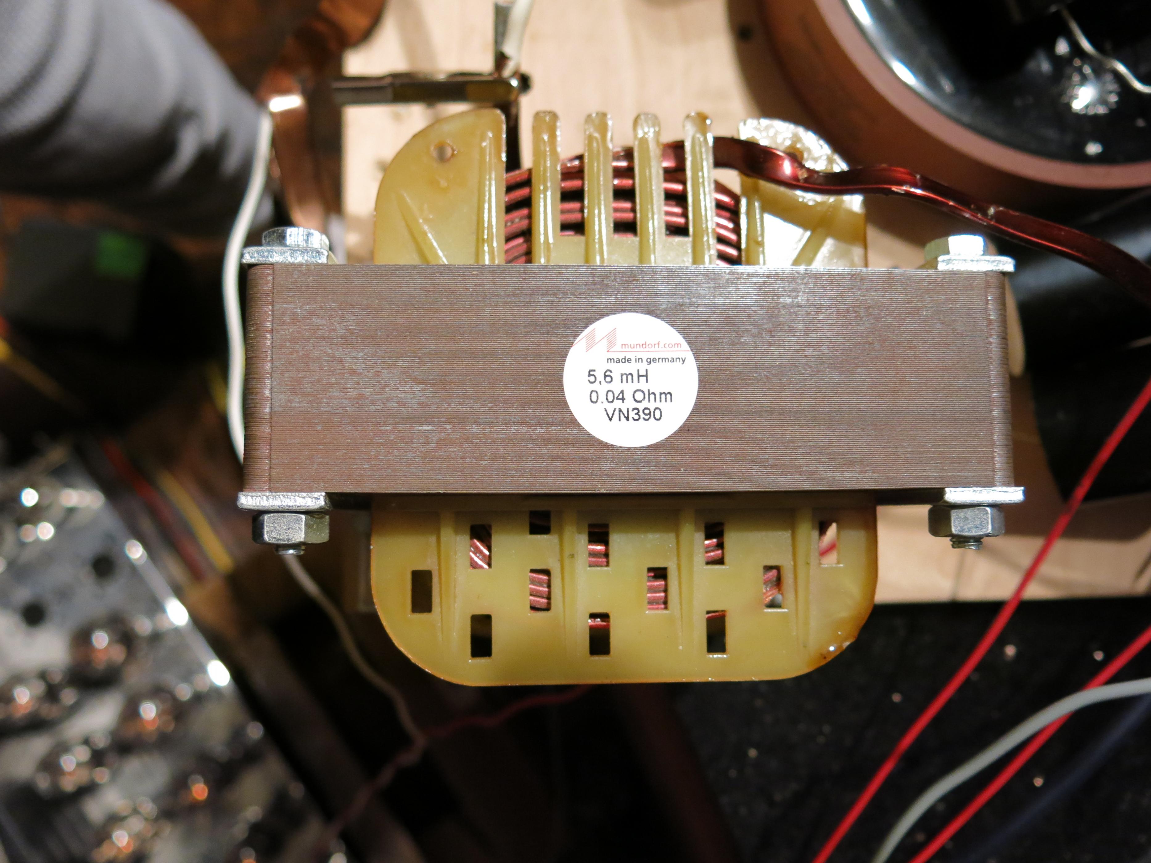

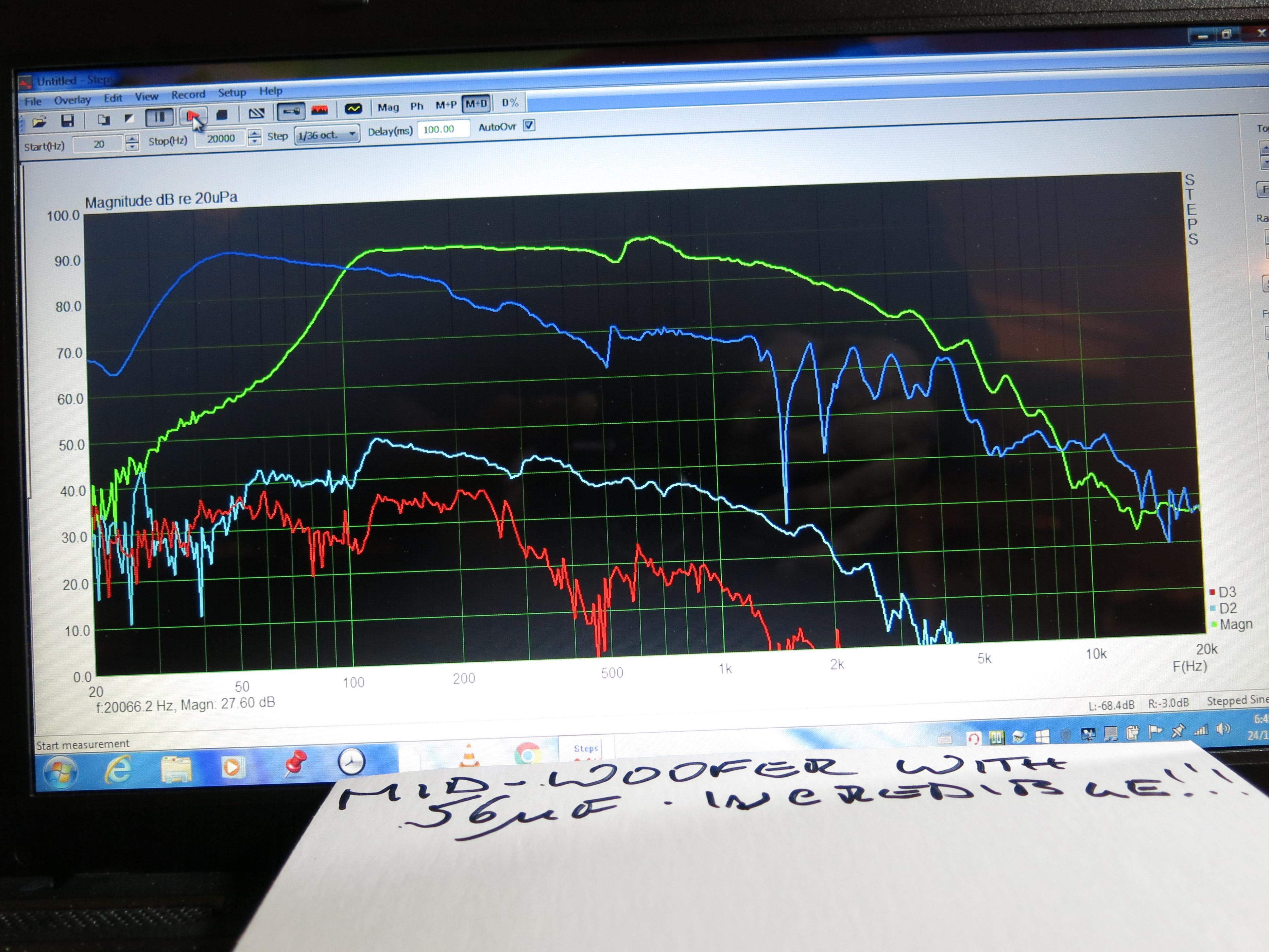

Picture 3) Series crossovers (it's said) benefit from large guage, low Rdc resistance inductors. For woofers, we have found 'cored' inductors sound best. Mundorf Zero Ohm Feron Cored, low Rdc (o.o4 Ohms) inductor. 5.6mH. Nice.
Our circuit has capacitor C3 (& C3B). This capacitor allows higher frequencies to bypass the woofer, and go on to the mid woofer.
We did a lot of waffling back and forth.

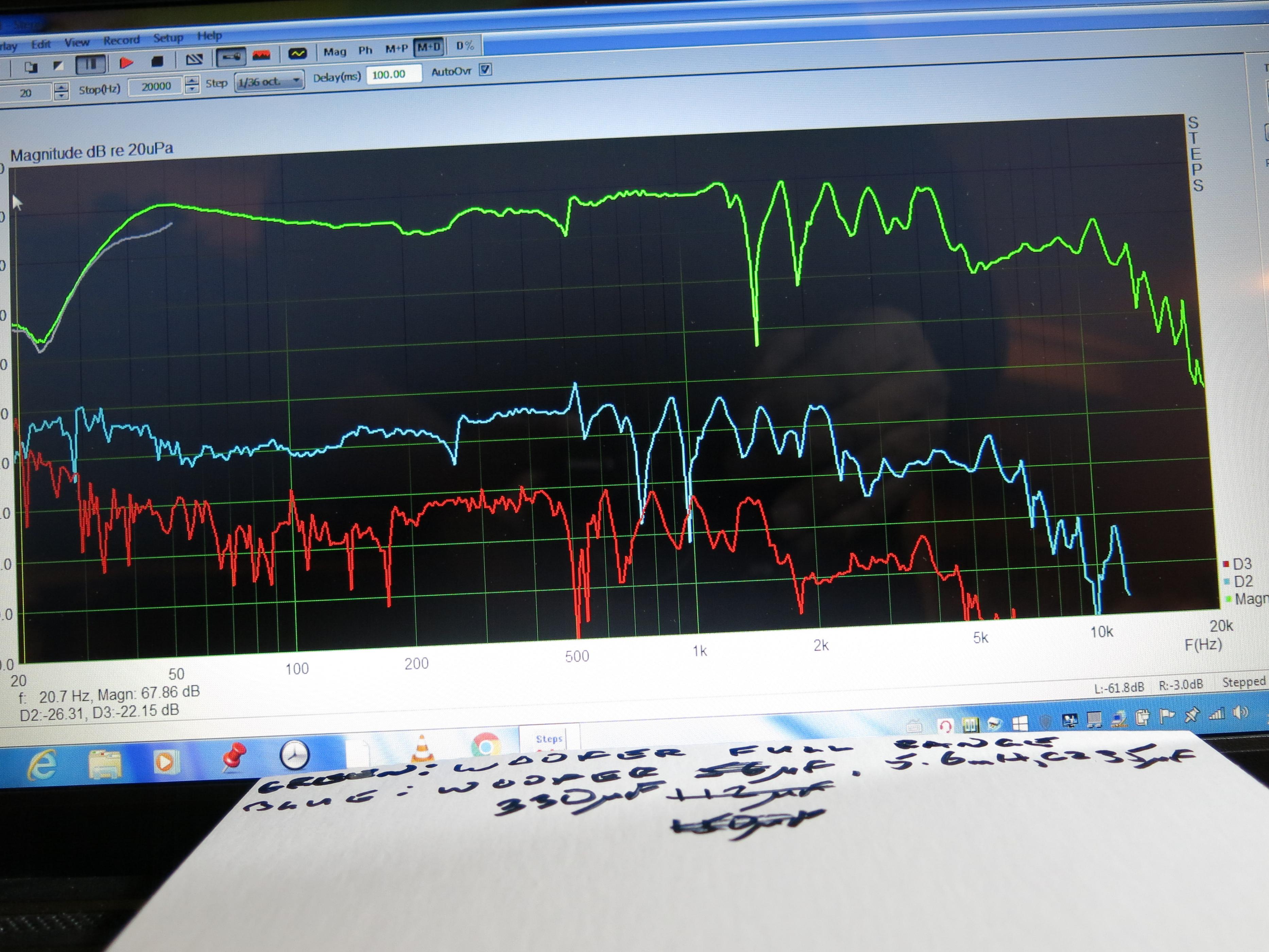

We tried a lot of values. These values ranged from 330uF down to 56uF. We'll show 4 of them.
The best of the bunch was 56uF. Let's show this first.

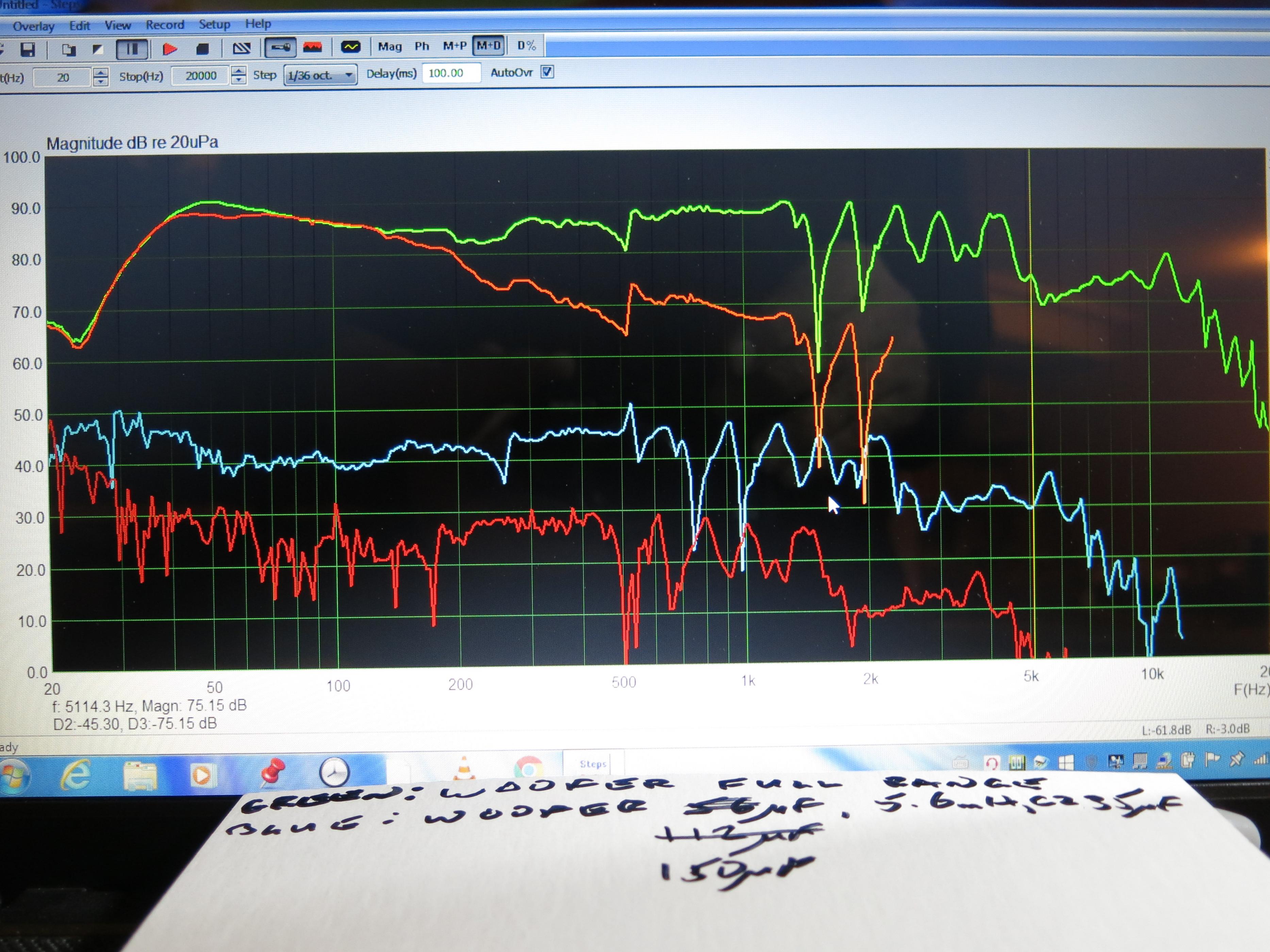

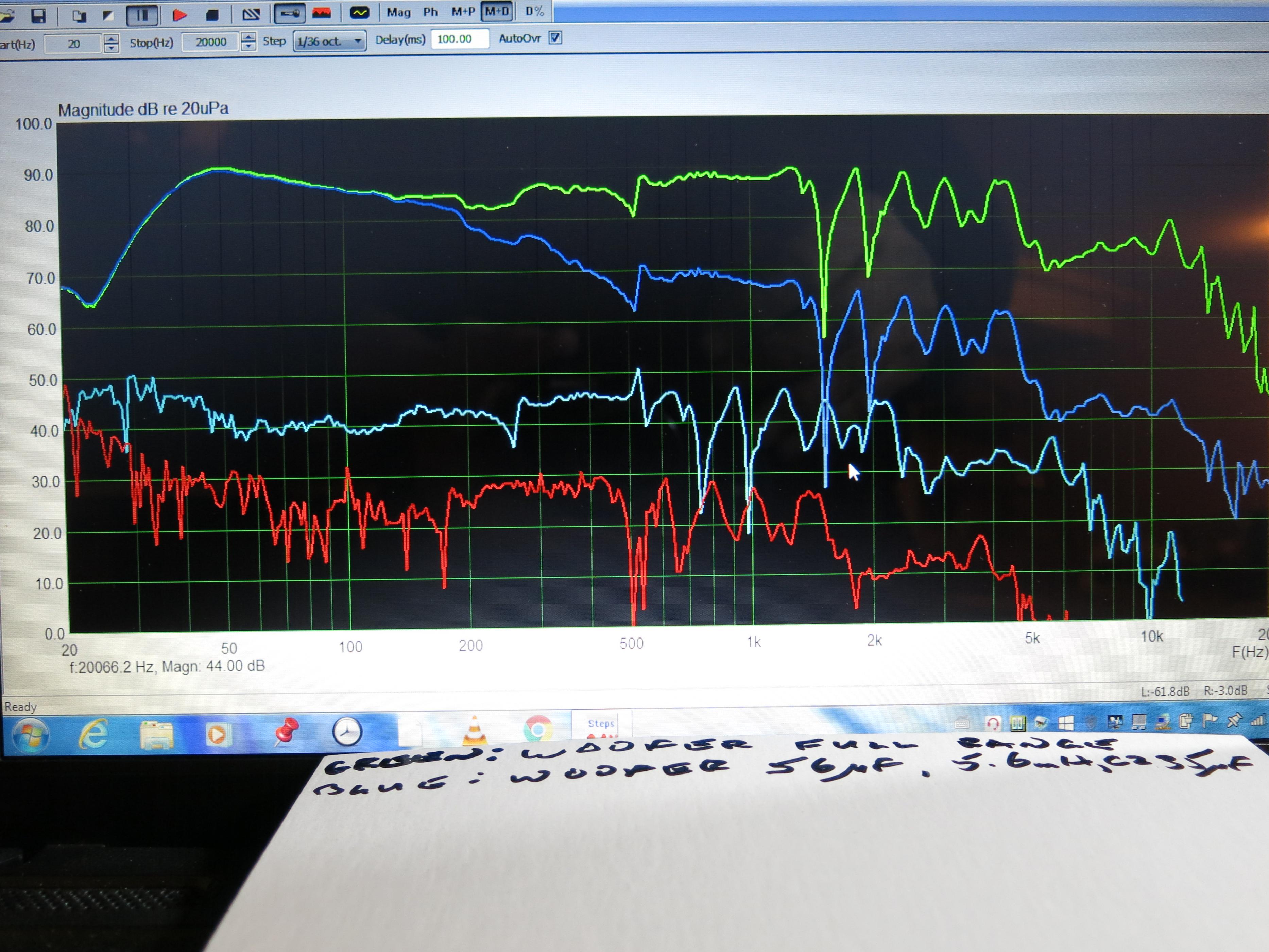

Picture 4) We start with 56uF (C3 and C3B), and add the TD15H+ full range. We like that this combination preserves the woofers output below ~100Hz.
Picture 5) We add another 56uF in parallel. This gives us 112uF. We notice a slight drop in woofer output. 40Hz -80Hz. Where did this 'music' go?
Picture 6) 150uF. Another small drop in output. Not good.
Picture 7) 330uF. We didn't even bother letting this continue. That bad.

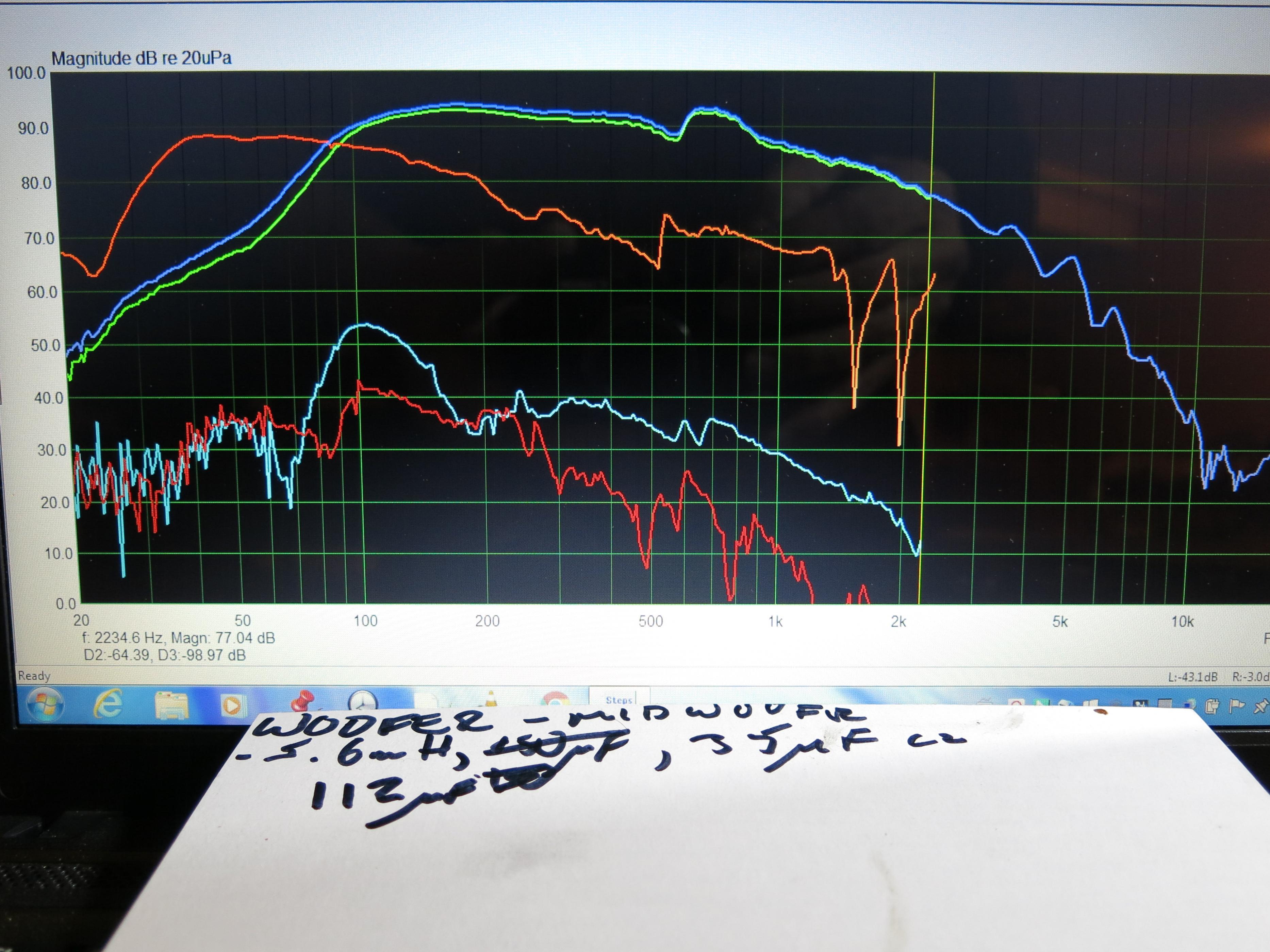

Picture 8) This is the mid woofer output. C3 is 56uF. We look at the distortion measurements, and put those in the back of our minds.
Picture 9) 112uF. Mid woofer measurement. D2 distortion has a bump around 100Hz.
I won't bother with the distortion measurements for the mid woofer for 150uF and 330uF. They where worse.
Conclusion; The mid woofers distortion is lowest when the capacitor C3 is optimized.
Until the new upper cabinet is finished, I won't worry about the mid woofer output from 500Hz to 1000Hz. This might be a box issue.
Our x-over point is ~110Hz.

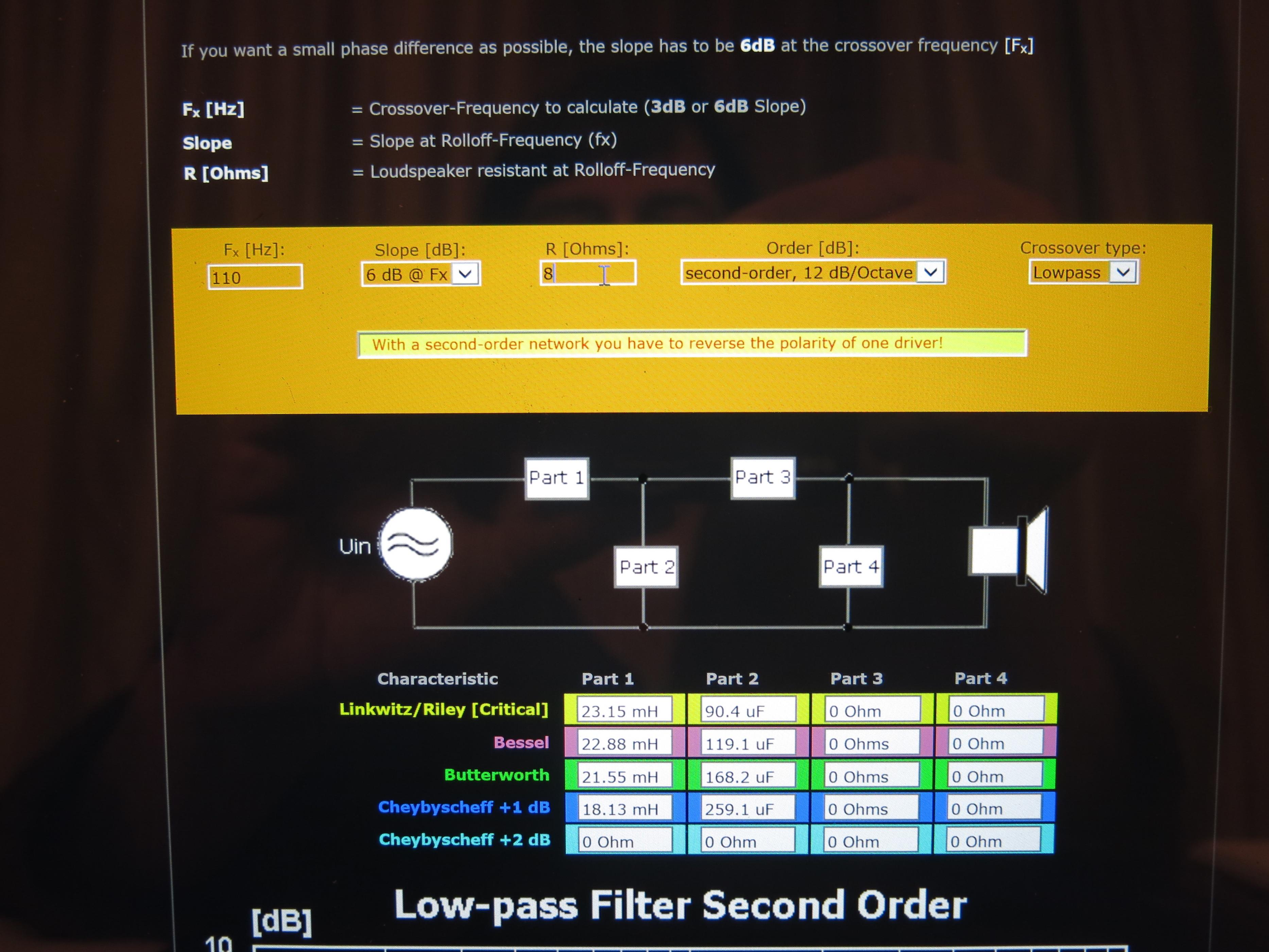

We go to MH-Audio.
We go to the section 'calculates 6dB, 12dB, 18dB slopes'.
We input; R = 8 Ohms (best guess average from manufacturers impedance plots)
We know; our measured x-over point is ~110Hz.
We look at LR (critical) values; L = 23.15mH. C = 90.4uF
If we divide this inductor value by 4, we get 5.78mH (close enough to our 5.6mH).
If we divide the parallel crossover capacitor value by 2, we get 45.2uF.
This might imply our measured best C3 of 56uF is still not the optimal.
I need to start measuring values below 56uF.

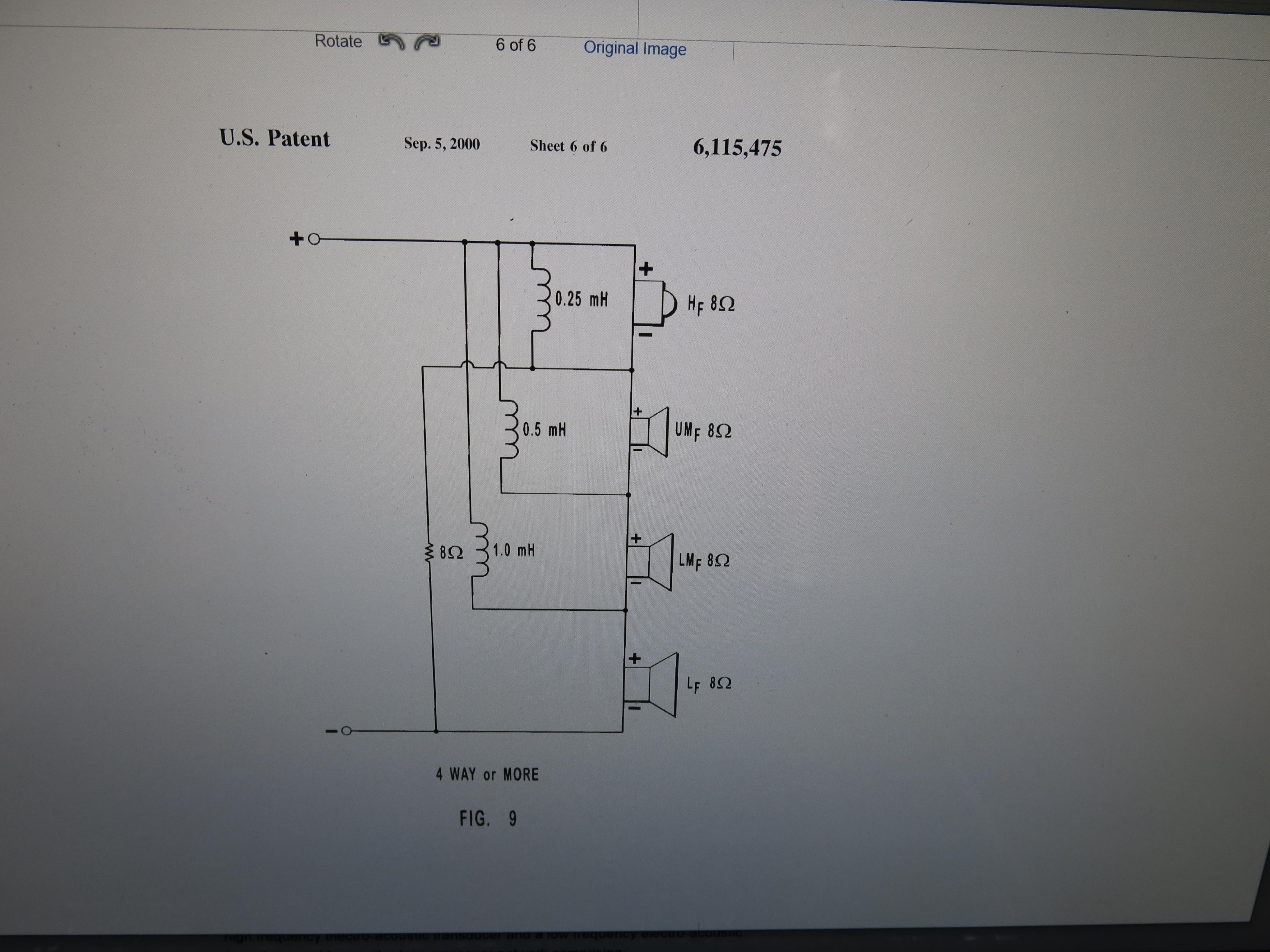

Let's concentrate on a 4-way. My topology.
We'll use what we've measured, and therefore what we've concluded, from what we've observed.
Tweeter - Midrange; 1/2 parallel inductor. 2.5 time parallel capacitor.
Woofer - Mid Woofer; 1/4 parallel inductor. 1/2 parallel capacitor.
It will freak me out if;
Once my new upper cabinet is finished,
and we do our measurements,
Mid Woofer - Midrange; 1/3 parallel inductor. 2 x's parallel capacitor.
Inductor; so far 1.2mH gives me the best response. Mh audio, for 8.5 Ohm average impedance at crossover, x-over ~800Hz, gives 3.38mH. 1/3 is 1.13mH (close enough for now)
Capacitor; tweeter is 2.5 times. This is 5/2. Woofer is 1/2. 5/2 minus 1/2 = 4/2.
This might imply our capacitor for the mid woofer - midrange should be 2 times the parallel calculation.
If it is higher, than we need to test out tweeter cap at 3 times parallel value, and not be content with 2.5 x's.

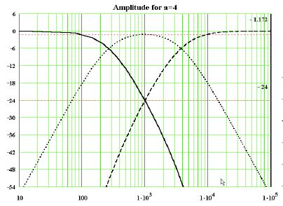

Let's look at this.
This is fun!!!!

What happens when we have a 16 Ohm woofer, 4 Ohm mid woofer, 8 Ohm midrange, and 6 Ohm tweeter.
The permutations are mind boggling.
Is there a relationship between L1, L2, and L3 for a 4-way?
Does my circuit fail miserably for a 3-way?
How would it look for a 5-way?
Is there a way of putting together a simulation program?
What if? What if? What if?

I did some more poking around and found this by Kimber on the subject of Dopler distortion.
Infinite. Have you tried simulating or are you trying to get started?The permutations are mind boggling.
- 4-Way Series Crossover. Accuton and Acoustic Elegance Drivers
