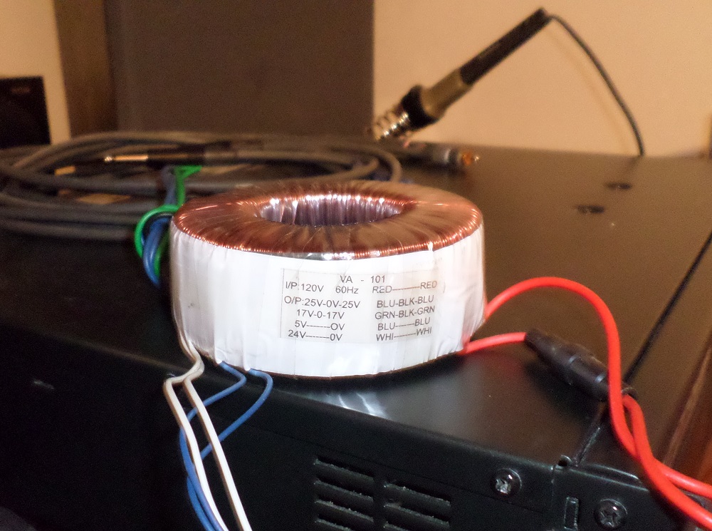

Edit: Would 17-0-17 work? I've got one of those white van scam receivers sitting here one of my friends gave me, which for all it's junkiness, has a 10-0-17 trafo in it I can scavenge.
It won't work -. you can't use a center tapped transformer with the gain stage board. You need either a transformer with dual (indpendent) secondaries or two identical transformers such as those inexpensive MCM transformers I mentioned earlier in the thread. Here is the link once again:

Aha, ok. Figured I'd check the spare gear for parts, just in case :)
Edit: Just for educational and window shopping purposes, I'm still looking around online to see if I can find a single transformer with independent secondary windings.
Edit2: Just so I'm sure that I've learned the right lesson from this, this diagram (image) is what I'm looking for, yeah?

Something along those lines will probably work. The only problem I have is that the specs are not clear in the datasheet. Let's say that we have the Tamura 3FD-424 (12V dual secondary) model. What is the no load voltage and what is the voltage under the specified load? The regulation is approximately 18% in the datasheet. So does that mean that the voltage will be 1.18*12V = 14.16V under no load conditions and 12V when loaded with the rated current of 0.25A on each secondary? I'm never sure about the MFG specs, even with a pretty complete datasheet like the Tamara example.
Those MCM transformers are a known known, meaning that I own some of them and I have measured them. I have also measured the performance of the circuit connected to them. They are also very, very inexpensive.
My reliable source, Antek, is out of stock of the appropriate type. Otherwise that would only be $11 for 25VA or $17 for 50VA.

Yes, that is the representation of a dual primary, dual secondary transformer.
If you have any questions about how to choose an appropriate transformer in terms of the VA (power) and secondary voltage ratings, just ask.
