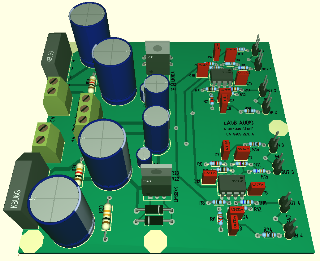

I've completed the first rev of the board design. I decided to base the power supply section design on the PS from my headphone amplifier board, so it requires a dual secondary transformer (not center tapped). You can take off DC power from a terminal block and use it to power other boards, should you use any.
I came up with a nice compact layout for each channel of the gain stage circuit. I implemented a separate ground plane under each channel and tied that back to the main ground.
See screen shot of the board mockup from my PCB layout software, Target3001, below. I plan to order some prototype boards soon.

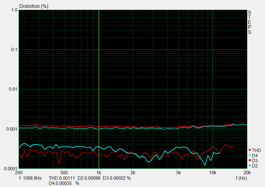

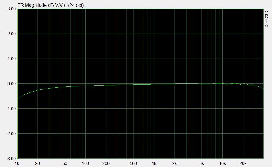

I finally managed to pull all the pieces together today. I hooked up the system and took some "first look" measurements on the board. This is the gain stage with on board PS.
The frequency response and distortion, measured with ARTA and STEPS respectively, are attached. Distortion levels are at or below 0.001% and flat across the audio band. Frequency response extends down to DC - the rolloff in the FR plot is probably due to the fact that I only used 500msec of the impulse response. There is no DC blocking cap. The board was intended to be used with the miniDSP, which should have no DC offset errors. The LME49720 op-amp that I am using should also have very low DC offset, and I measured 0.25mV at the circuit output with the input shorted. So the performance looks pretty good, and is an order of magnitude better than what I normally associate with the miniDSP itself.
I did find one odd thing - the negative rail is not at the right voltage, so I will have to look into that a little more to see what is causing the issue.

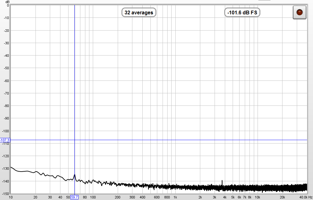

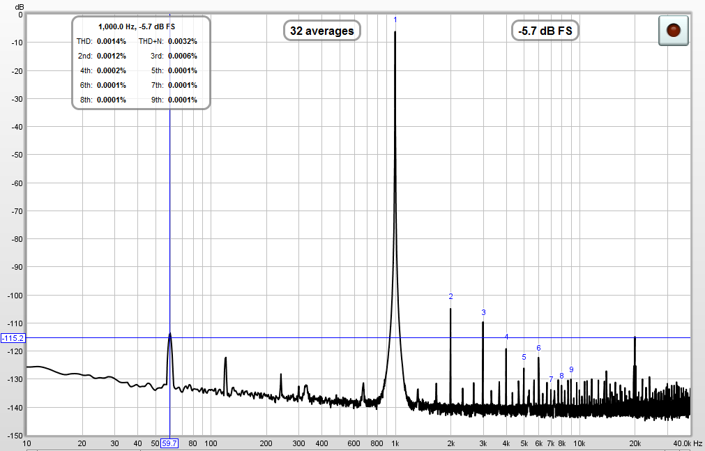

FWIW the spectrum and distortion levels of the board are shown in the attachment below. Not sure why there is a spurious peak at 20kHz, otherwise looks similar to the previous measurements. Mains (60Hz) is 115dB down and other noise/garbage is pretty low in level as well.
I managed to track down the issue with the negative rail. The problem was that the negative rail voltage was sitting at about -9.9Vdc when it should have been around -15Vdc. I replaced the regulator IC but this did not have an effect. I then checked and replaced the two resistors that set the output voltage - I thought maybe that the reg needed to source more current to work better, but in that case the voltage should have been more negative but instead it was more positive. The voltage was still not right... After a little more time I discovered in my schematic that I designed the board with the capacitor connected to the adjust pin backwards (polarity reversed) and it was passing a small amount of current. Oops. This still allowed the reg to function but threw off the voltage setting. I removed the cap and installed a new one with the correct polarity orientation. Now the rail is sitting just where it should be, -15V (to within the voltage regulation of the LM337 at least).
I re-measured the distortion levels and frequency response. These look the same as before, e.g. good. I also made a spectrum measurement. The mains pickup was slightly higher and that odd 20kHz blip was still there and bothering me. I then shorted the input and remeasured the spectrum and the 20kHz peak, as well as all of the mains related peaks, disappeared (see attachment) leaving only a very low level noise floor (of my measurement system). So all of those peaks are being picked up by my DIY twisted pair, non shielded interconnects and are NOT present in or being picked up by the circuit/PCB itself. That's great news. I should probably get a better measurement set up put together, but I am barely up and running at this point after my move.
