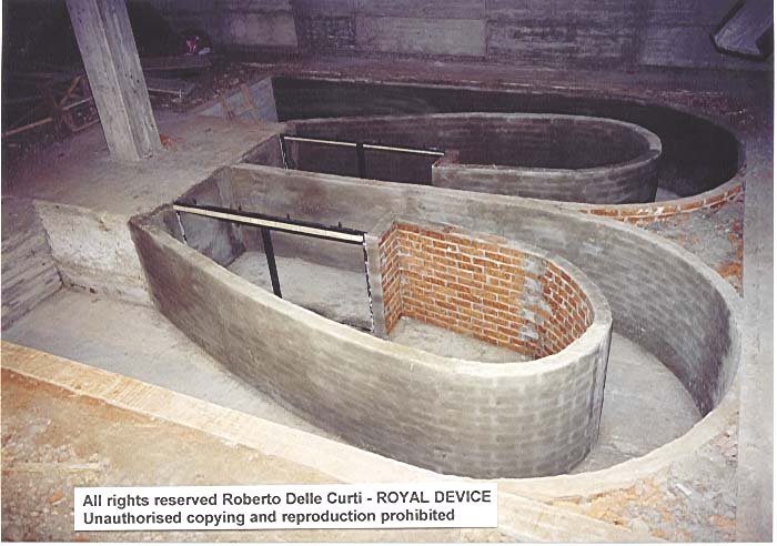

You need both massive length,corner loading,and large mouth area for efficient 20hz. See examples. A large tapped horn could be of use but I havent followed the latest threads on it.
http://www.royaldevice.com/custom.htm
http://www.geocities.com/xobt/basshorns/basshorns.htm

What i need to know now,
is what can be done with a 9high by 5 wide by ~7' deep spot for the horn ..
do i need to use more than one driver on each horn to get the best possible result ?
total displacement of air is what we are looking for in a sub-bass horn ?
how to design the horn ...?? :)
i can imagine folding and everything...that is no problem to me ..but designing it's accoustical properties, there i will need help!

If you have more drivers/cone area,the horn doesnt have to be as long.
Id get some one to design it for you with HORNRESP or mathcad.It looks like tapped horns are an option.
