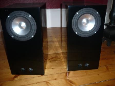

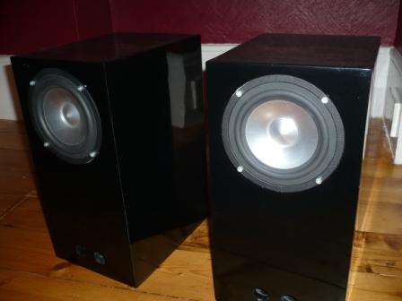

NB. Some pics of my finished Jordan JX92s in their cabinets (courtesy of WoodturnerFran, who did the piano black finish).
Excellent looking speakers, I think you'll agree?
