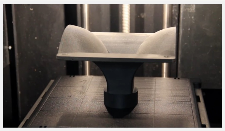

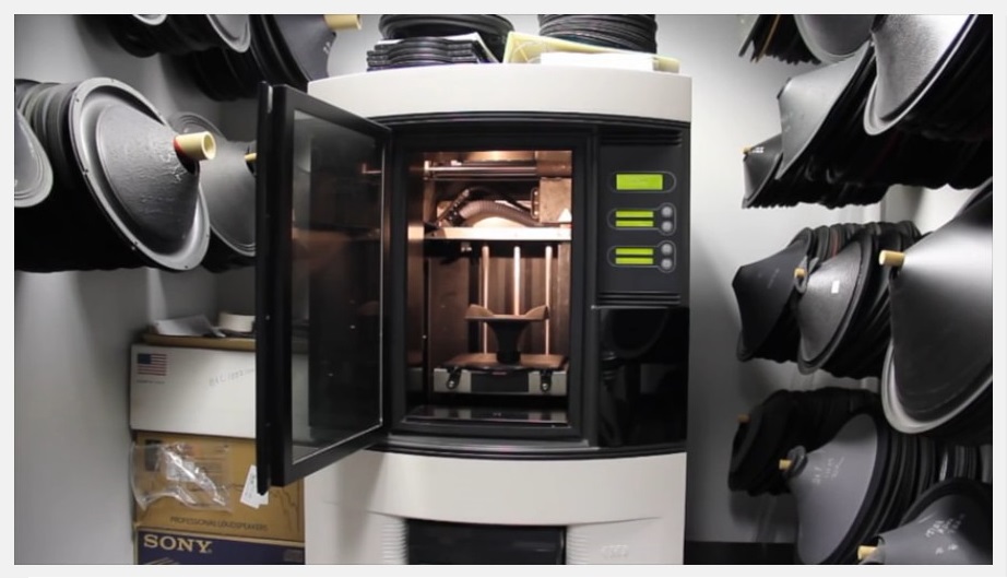

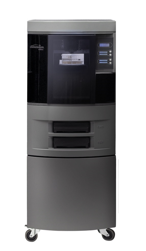

The Stratasys FDM 3D Printer from Eminence with 8" x 8" x 12" (203 x 203 x 305 mm) build envelope and ABSplus-P430 thermoplastic filament.

Ive been drawing up ideas for a easy way to build a conical, or elliptical synergy/tractrix horn, and been looking at the idea of 3D printing the entry for the 1" driver and the tricky mounting of the 4 other drivers.
Shapeways now offers porcelain as an option, and the early ideas have these coming in at about £75.
Now I just need to learn SolidWorks as Sketchup is rubbish for this sort of thing...
