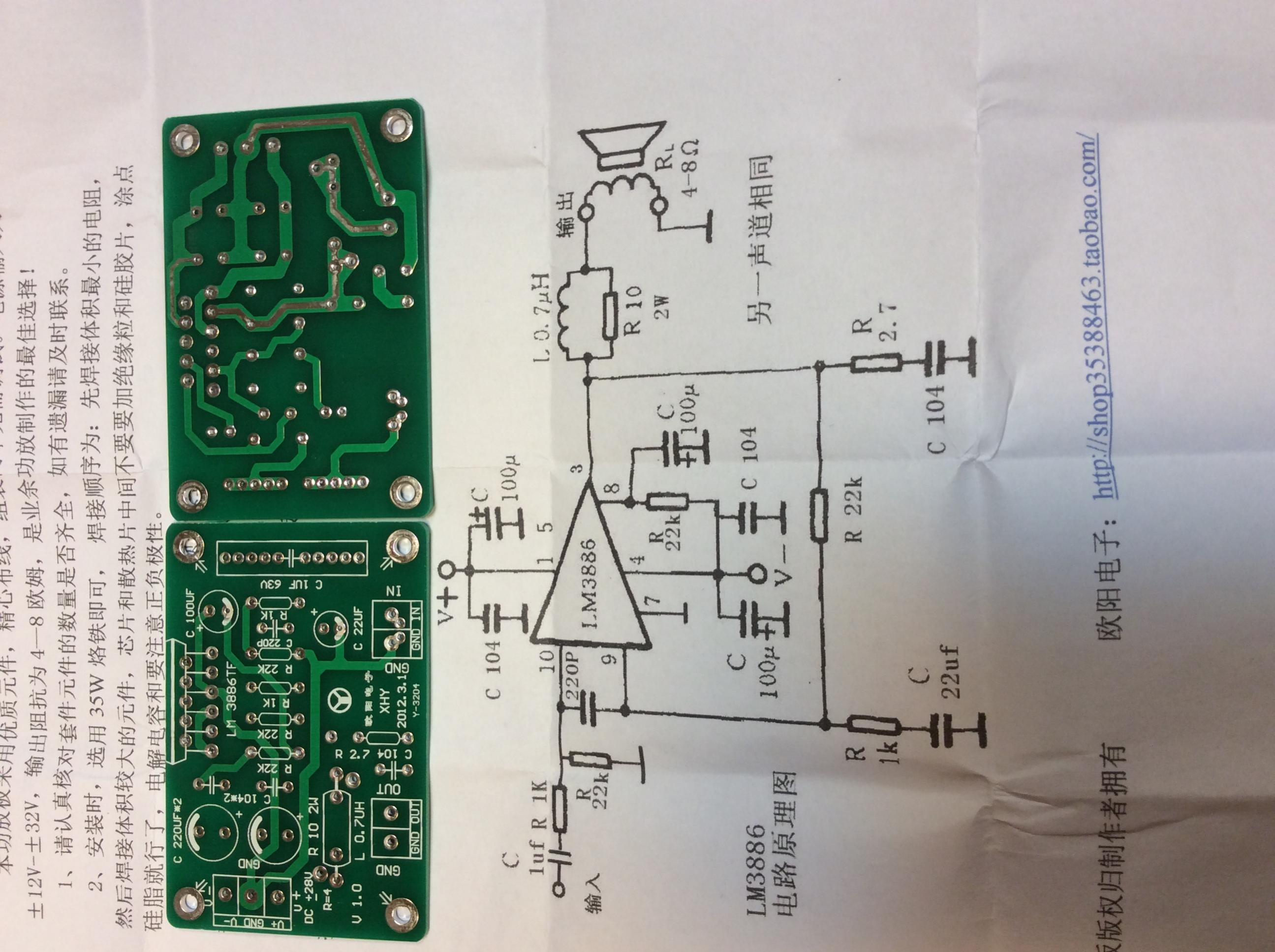

Just received a lm3886 kit from chinese seller. The circuitboard and scematics are attached. The only differences from scematics are input cap (2.2uF) and "big" power capacitors (220uF).
1) Any suggestions on this desing? Looks very simular to the reference lm3886 circuit, but maybe i missed something?
2) Where i should disconnect the signal ground from power ground on this board?
P.s: sorry for my english, it's bad, i know.
