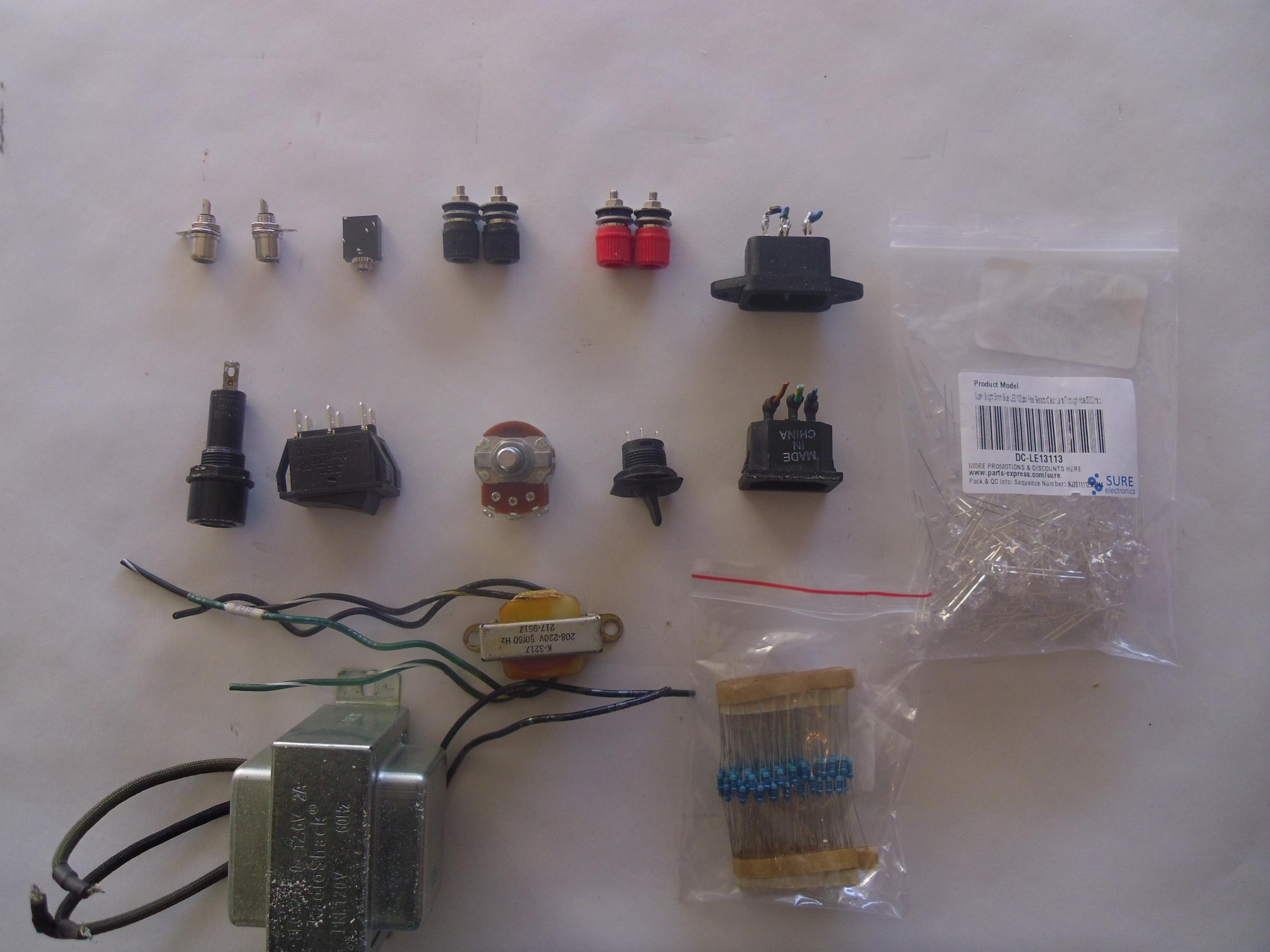

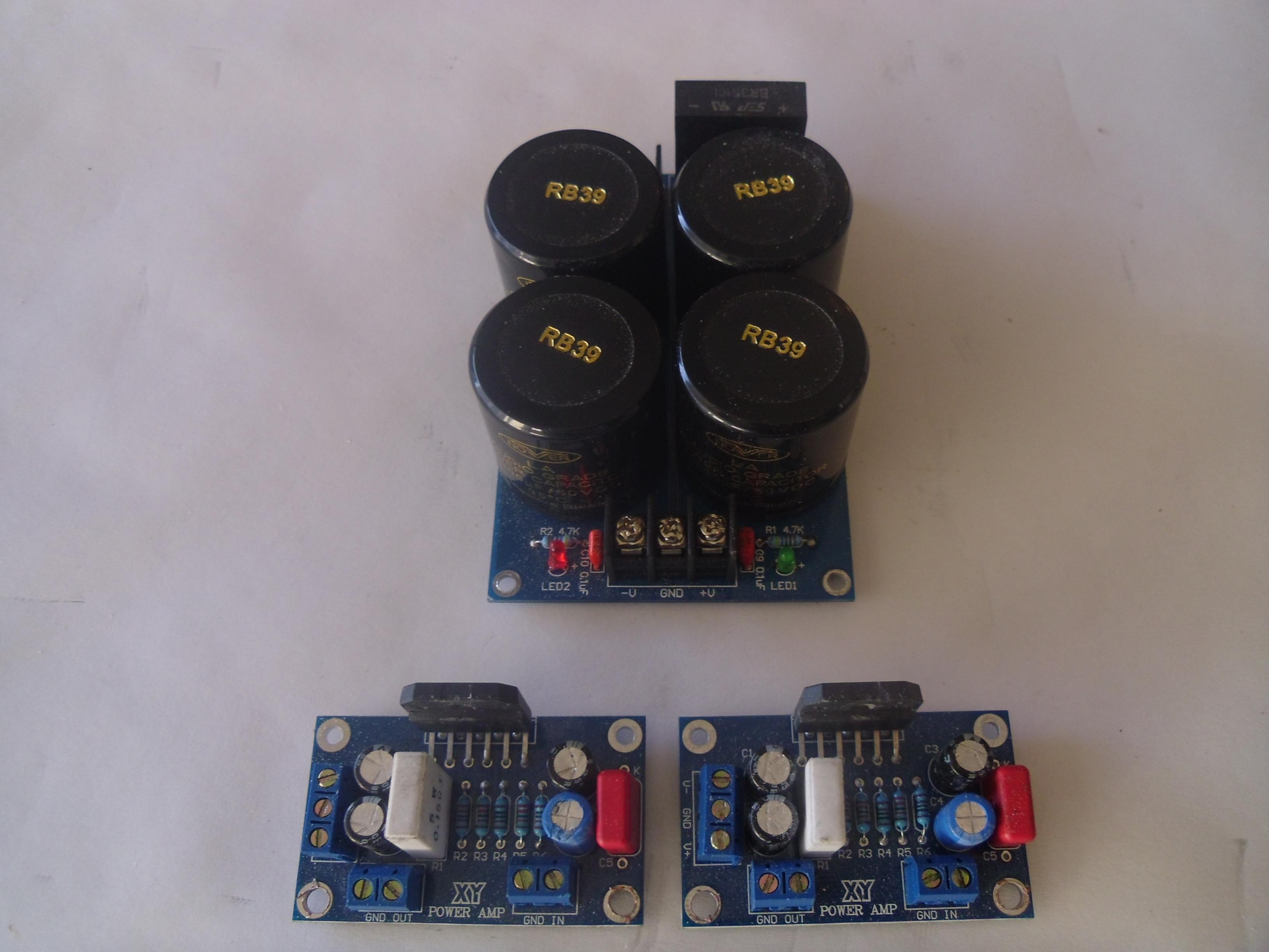

It's getting hard for me to keep track of my progress with 2 or 3 other threads going on this project so i decided to move it all into one.
This is a kit I puchased online for just over $30.00 usd. and the transformer is one i already had. I don't have alot of money to dump into this "side project" at this time due to another new member of my family will arrive soon and I am also in the process of purchasing a home. I will try my best at giving out the most accurate info I can along with pictures to help visually. There are several people here that have helped and are in the process of helping me understand certain circuits.
If I can get this correct and really enjoy my end results I might move on to a bigger, more challenging project down the road. Untill then, please bear with me as I am completely new to all of this.
The first picture is the kit I have...The second picture is all the components I have gathered and scavenged from other sources.

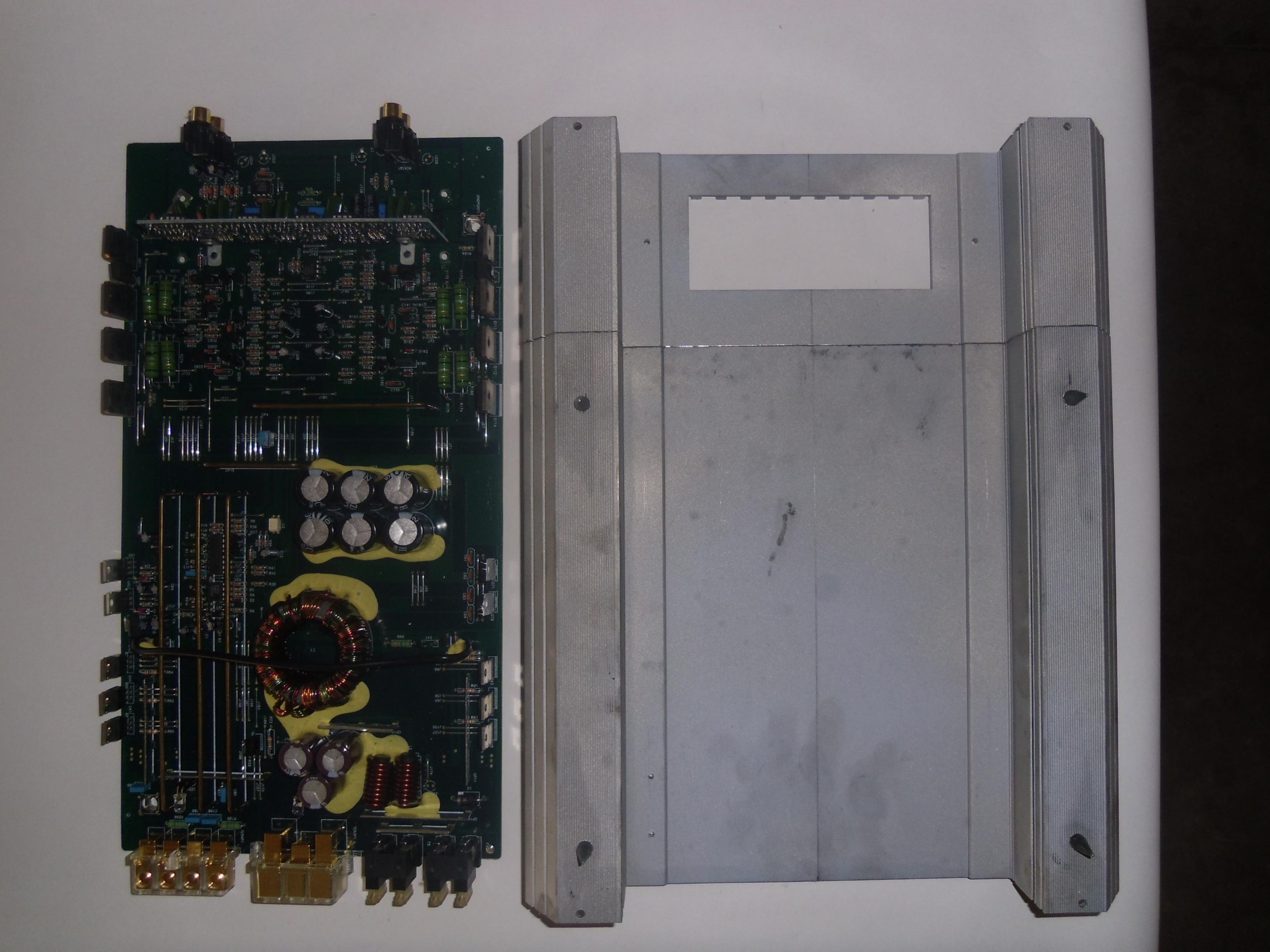

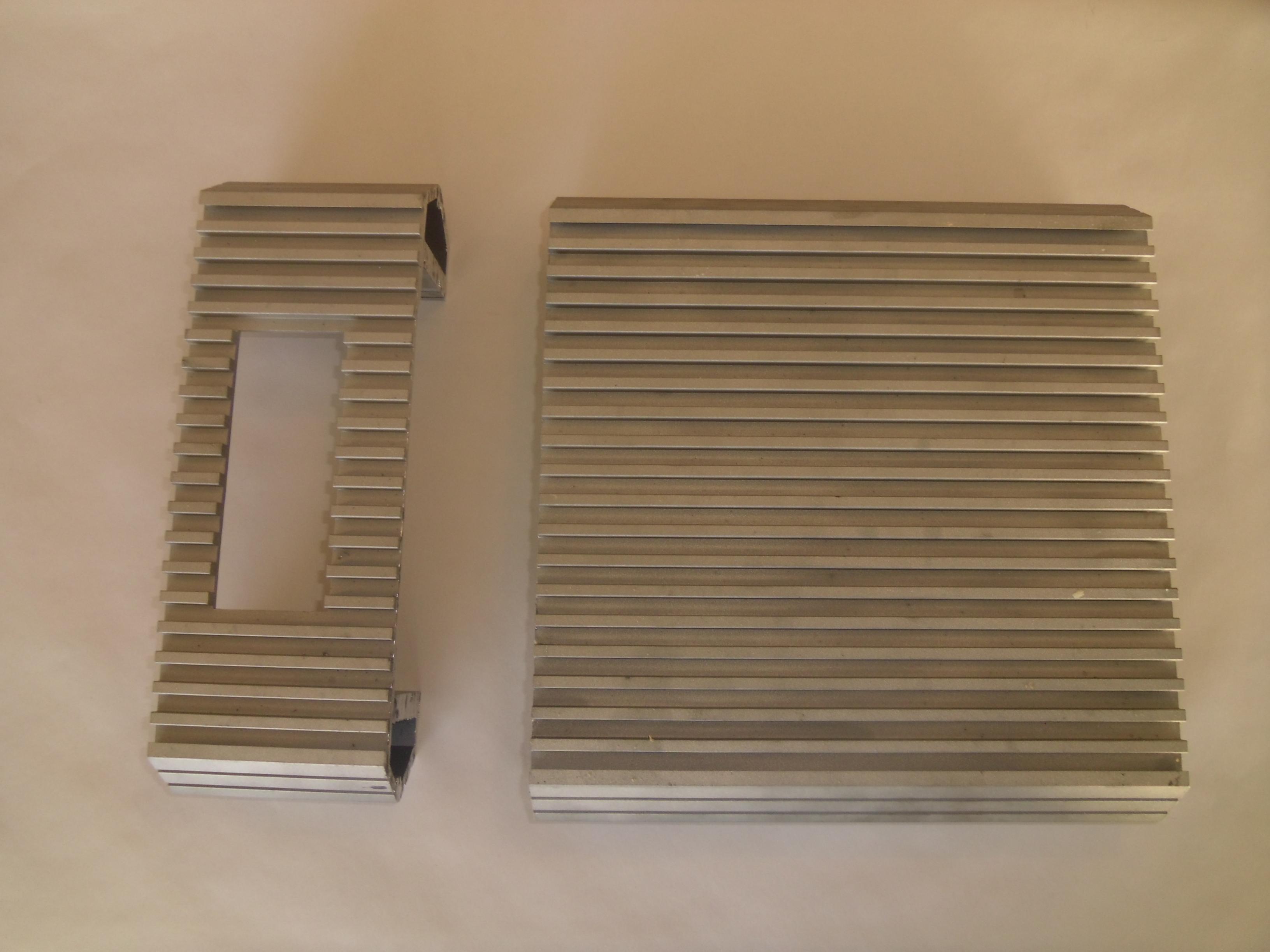

This is the enclosure I have chosen for this project. It is an old Power acoustick LT980/2 car amp I have had collecting dust for several years. I like the general finned look it had so I decided to sacrifice it for a "greater good"
Good thing is that it was working when i put it away the last time so maybe i can carefully canabalize the board for parts in another project.
As you can see I have cut it down with a band saw at work to clean things up a little. I have also drilled,tapped and added spiked feet from a salvaged display stand ready for the dump. I am currently in the process of bending and making a one piece bottom and end plates from 1/8" acrylic.
Did your retailer give any support on getting the kit wired together?
welllllll I got a list that tells me component placement but, they did not supply a diagram or schematic of any sort. It's it english but, still broken and hard to understand. I have put it through a test run on a piece of wood and everything sounds good except for the power on and off pop but, i believe i have the solution to that now.
Next time i will order differently
Let us know how it sounds, those chips look pretty rough for a LM3886. maybe it's just the photo.
The blue capacitor on the left amp board looks a little rough. Did you use these boards in another project?

Yeah the photo is a little rough, some of it might be from the spring clips that hold them to the side of the case.... From the test run I made, it sounds pretty good.
The blue capacitor has been replaced.....somehow something had fallen on it and dented the top...Good eye!
edit: I just took another look at the photo and alot of what you are seeing is saw dust..... everything is getting a "bath" before being installed.
The transformer is a 120vac 25.2v CT 2amp from radioshack that I had laying around.....I know everyone here prefers and uses a toroidal trans. but I'm trying to see what I can do with what I have. The other smaller trans you see is one that I'm going to use for Led's being integrated into the design of the case.
I was told by someone on another site that this trans would suffice for my amp.... Let me know if I've been misinformed
It will suffice but won't be that great. 25v CT equates to 12.5V individual windings? I think that's right with CT traffos I've never bought or really used them a great deal I remeber reading that somewhere! 12.5v * 1.4 = ~17V with some losses in the rectifier. So max power will be about 16W into 4ohm or 18W into 8ohm with reasonable distortion WITH JUST ONE CHANNEL DRIVEN. I may be wrong about the CT voltage thing though even so you're not gonna get much more power out of it.
At least 160VA at 2 X 18VAC for good power both at 4 and 8ohm.
Also for $30 for all of that, there's got to be sacrifices in quality somewhere...
Yes the transformer size looks about right for 12.5-0-12.5/2A, you'll have an amp with only a small fraction of its possible output potential.
It would work, to make a low powered amp, but what I would do instead is make two separate amps. It seems a suitably sized transformer may not fit in the cut down car amp casing, while your amp and PSU circuit is overkill for the power level the transformer you have will allow.
So, what I'd do is make a lower powered amp with a more basic/cheap design using that transformer and case, and a different amp with a higher voltage and current transformer in a different case.
Edit: Here's the transformer, one good thing about Radio Shack is they keep the same stock for years; 25.2V CT 2.0A Heavy-Duty Chassis-Mount Transformer with Lead - RadioShack.com

Also, hard to say for certain based only on a top down picture but a lot of the solder joints look like they didn't flow well at all, like maybe adding some flux and reflowing them might help... after washing the dust off the boards.
Well if I have to I'll bite the bullet and by the proper transformer. I'm not too concerned of the size as I will build a case to better suit.
The soldering isn't all that great and I do plan on reworking alot of it. The iron I had was of the cheaper variety and have a better one on order from Parts-Express along with some "Kester 44" I believe it is.
