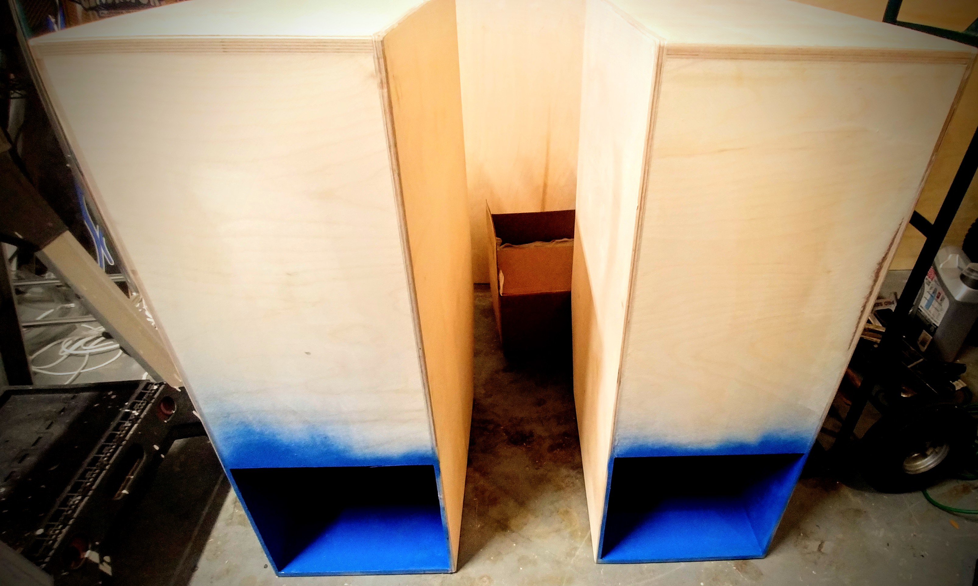

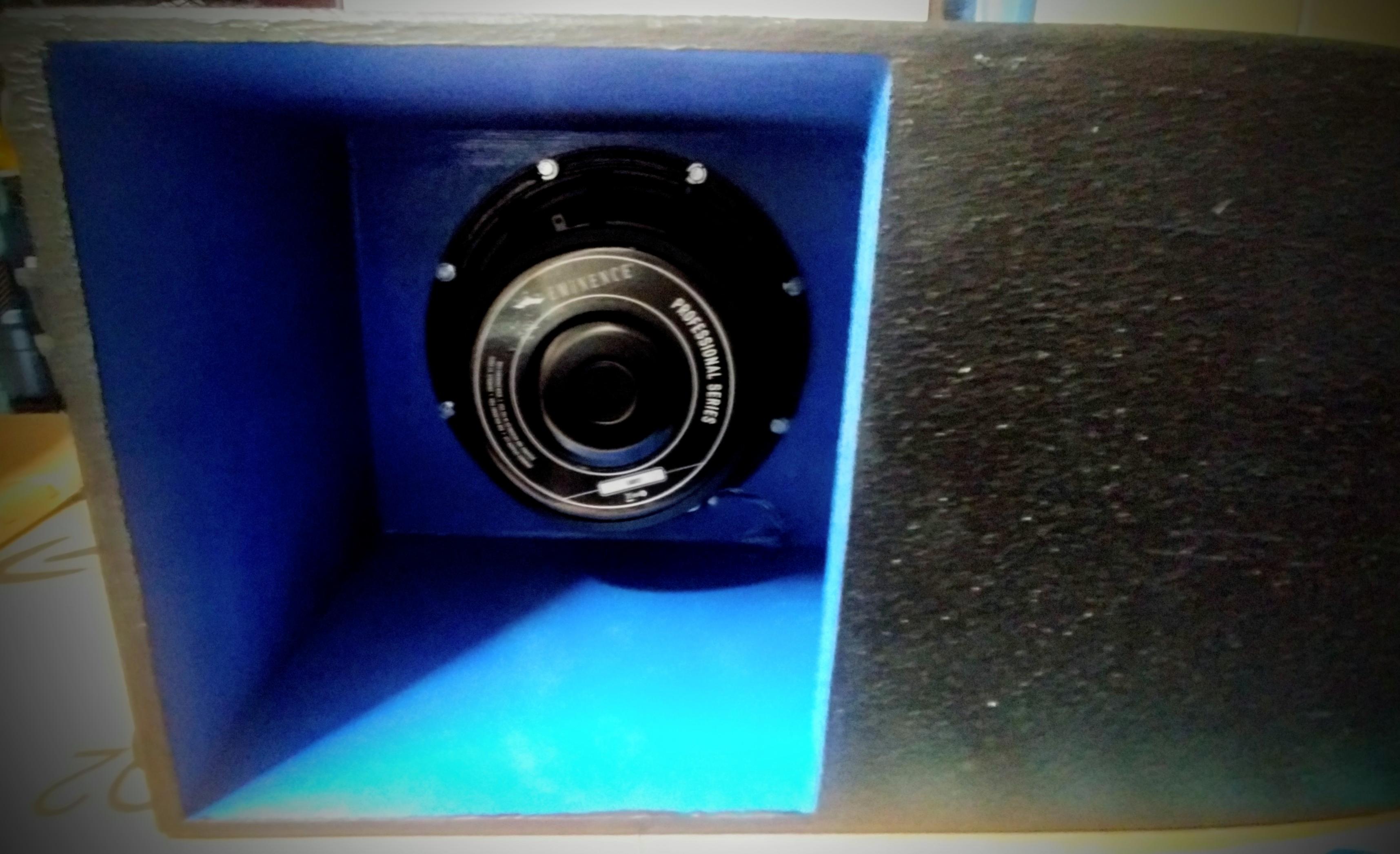

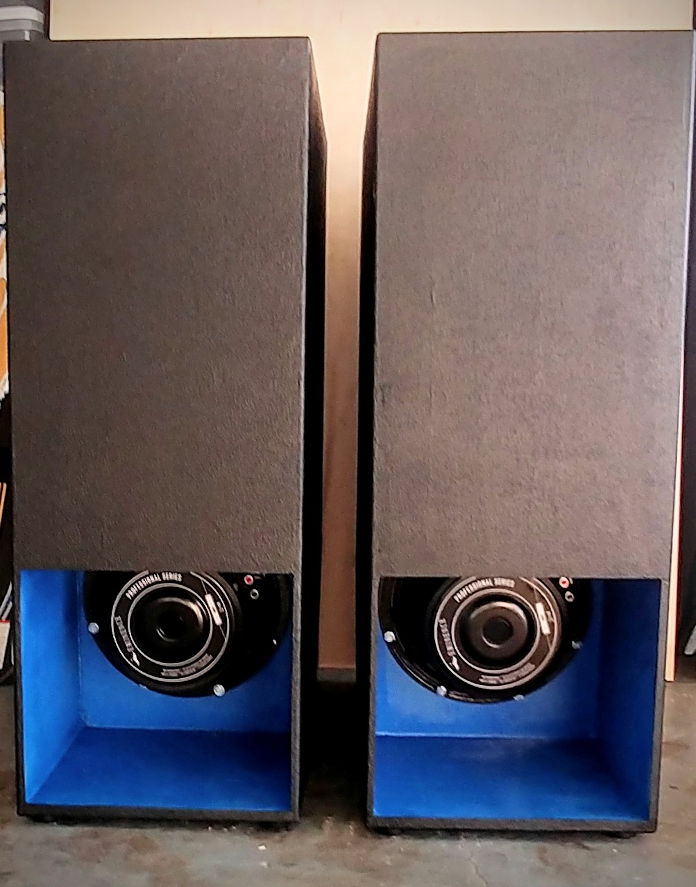

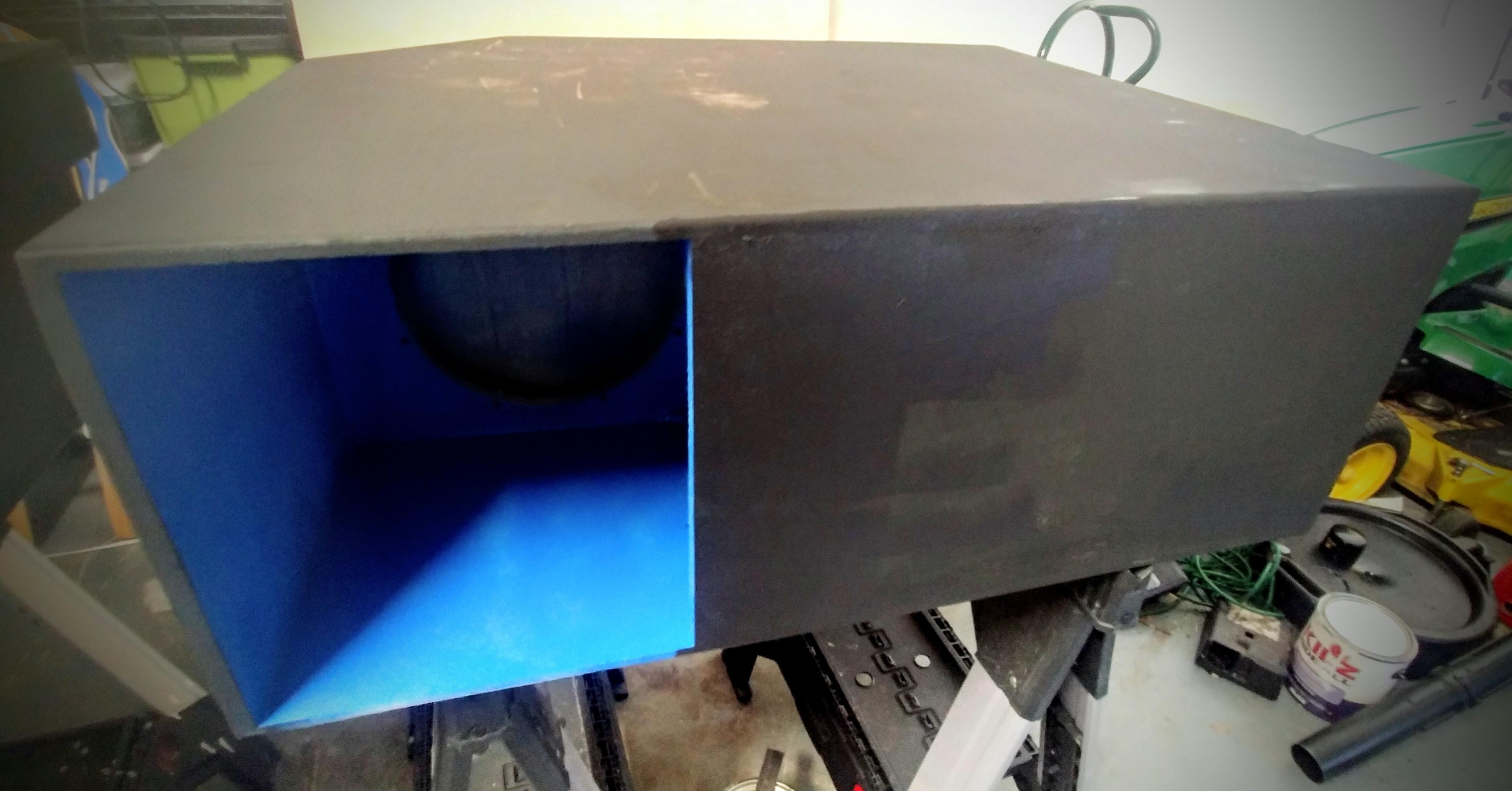

The painting has commenced. 1 coat of primer and 2 coats of duratex, then final assembly and testing
Love the Blaupunkt blue!

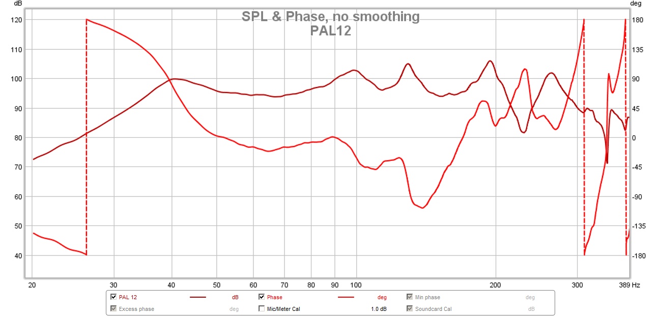

Finally was able to do a sweep outdoors today. Pretty close to the sim. A little EQ to smooth out the dip and they sound great.

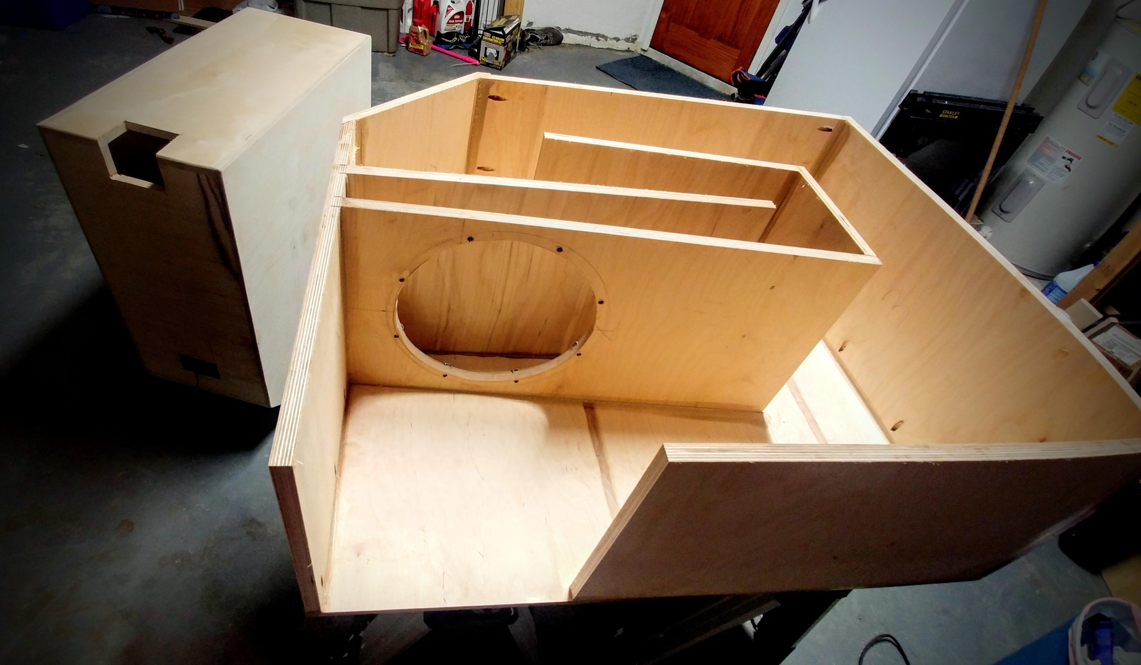

The 12mm baltic birch sides don't seem to be an issue from my perspective. Not much flex and shaved a lot of weight off the boxes.
