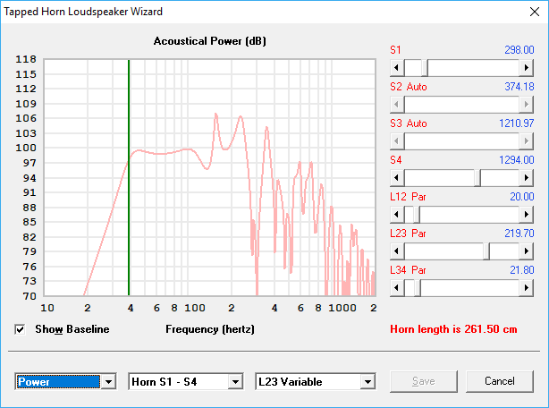

My point for posting the OSTL option is that, going with the PAL12 TH instead, you only gain about 2dB in the passband for a box that's over double the volume, AND you end up with a higher cutoff point as well. And bear in mind that I've actually given up a bit of passband gain in the OSTL design to widen the bandwidth.
I don't think the LAB12 is a really good match for a TH designed for 40 Hz pro audio use. Yes, you can get "good" results, but I think you can end up with better results using a driver that's a better match for that type of use.
I assume the Fs in the 20s has something to do with your comment about the LAB 12 in a TH for PA use. I'm looking at home use down to 27 hz (lowest note on a piano) and can get drivers needing a reconing free, plus I'm not interested in dealing with the limited bandwidth of the TH. Yet, anyway.
Not just a TH, but a 40 Hz TH. The LAB12 was designed for use in a FLH with a small chamber (which results in an Fb > Fs). There's no such "chamber" in the PAL12. The result is a particularly non-flat response, if you build the box as simmed.

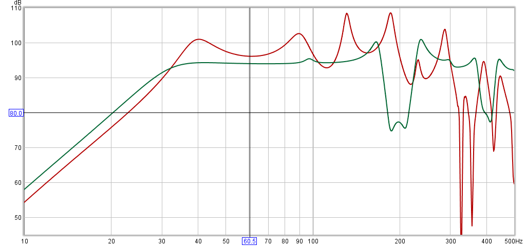

I've attached a sim of a simple TH of around the same volume, using a 15" driver that's a better "fit" for a 40 Hz TH. This is the Dayton Audio PN395-8. This can be built using a THAM or MTH type fold (and using the workbooks from my site to come up with the appropriate dimensions for the box). The passband is a lot smoother and the midband gain is better.

I'd consider building 15" compact TH, smooth & loud sounds great! A couple of those would probably kick butt for the main bands I'm running, as well as more electronic music if I decide to perform with them.

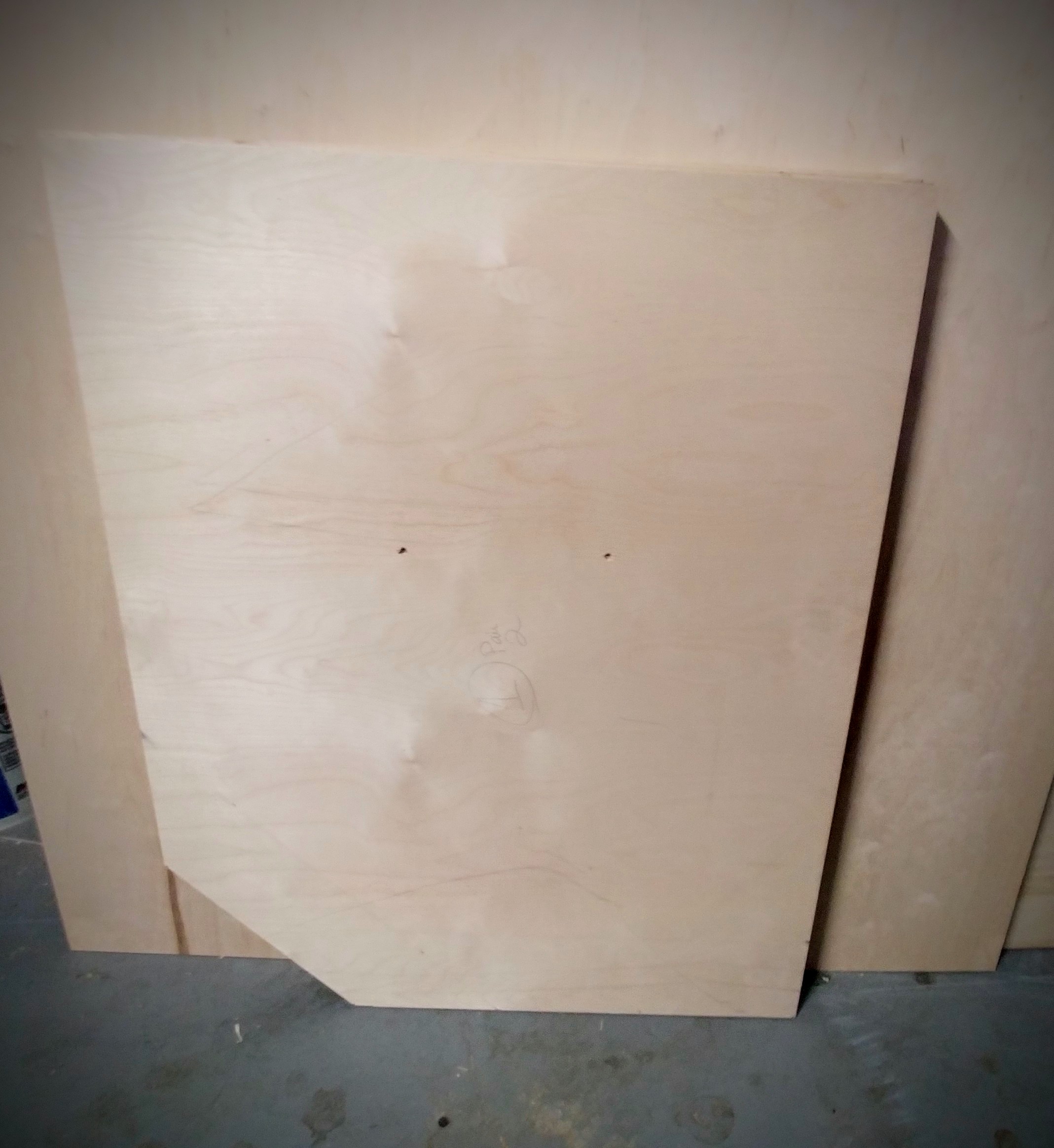

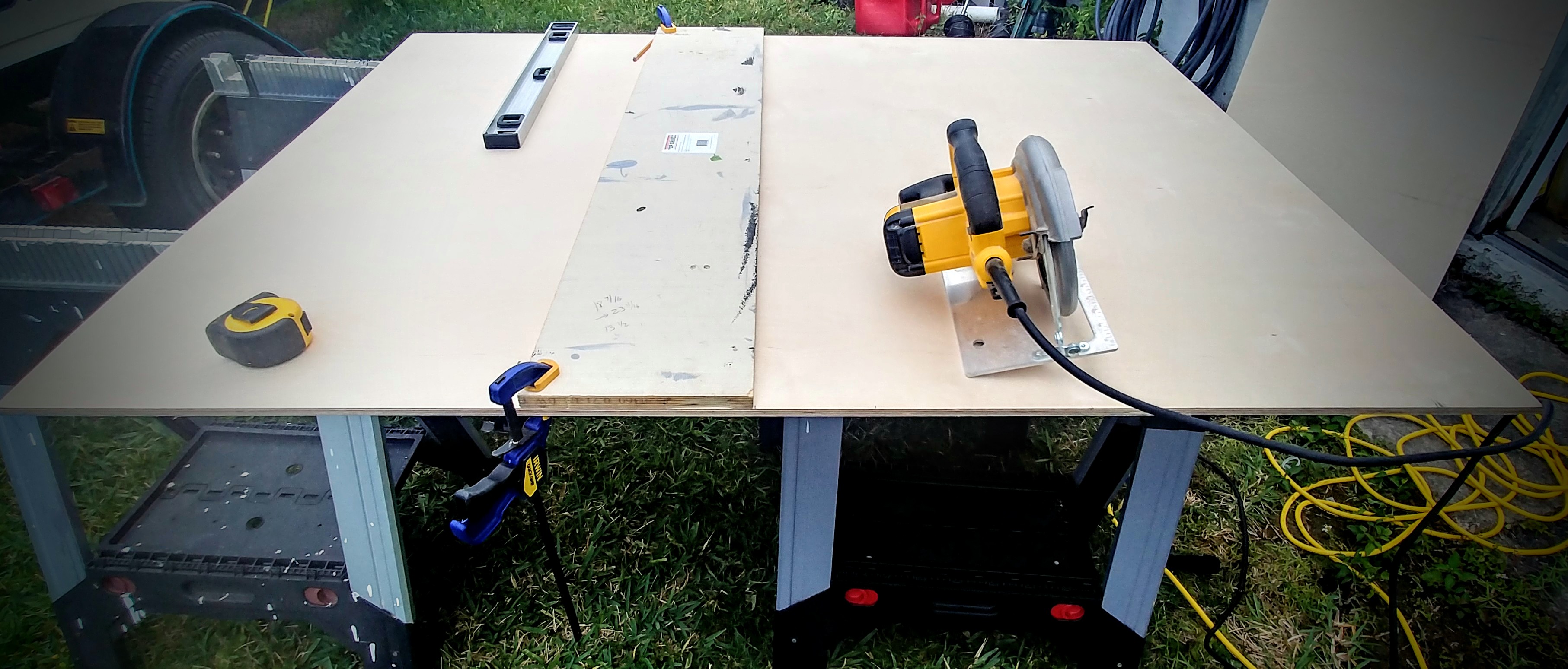

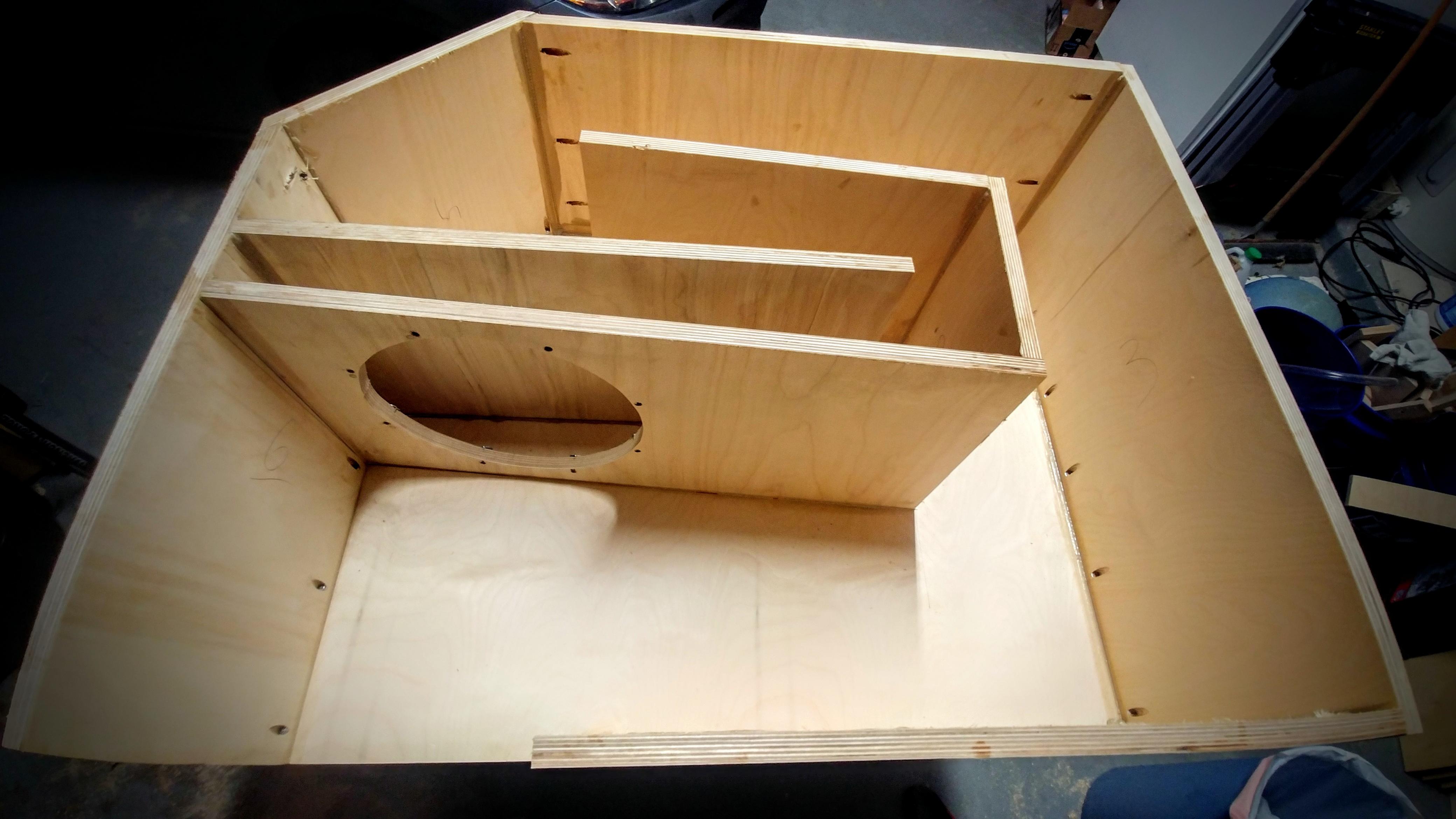

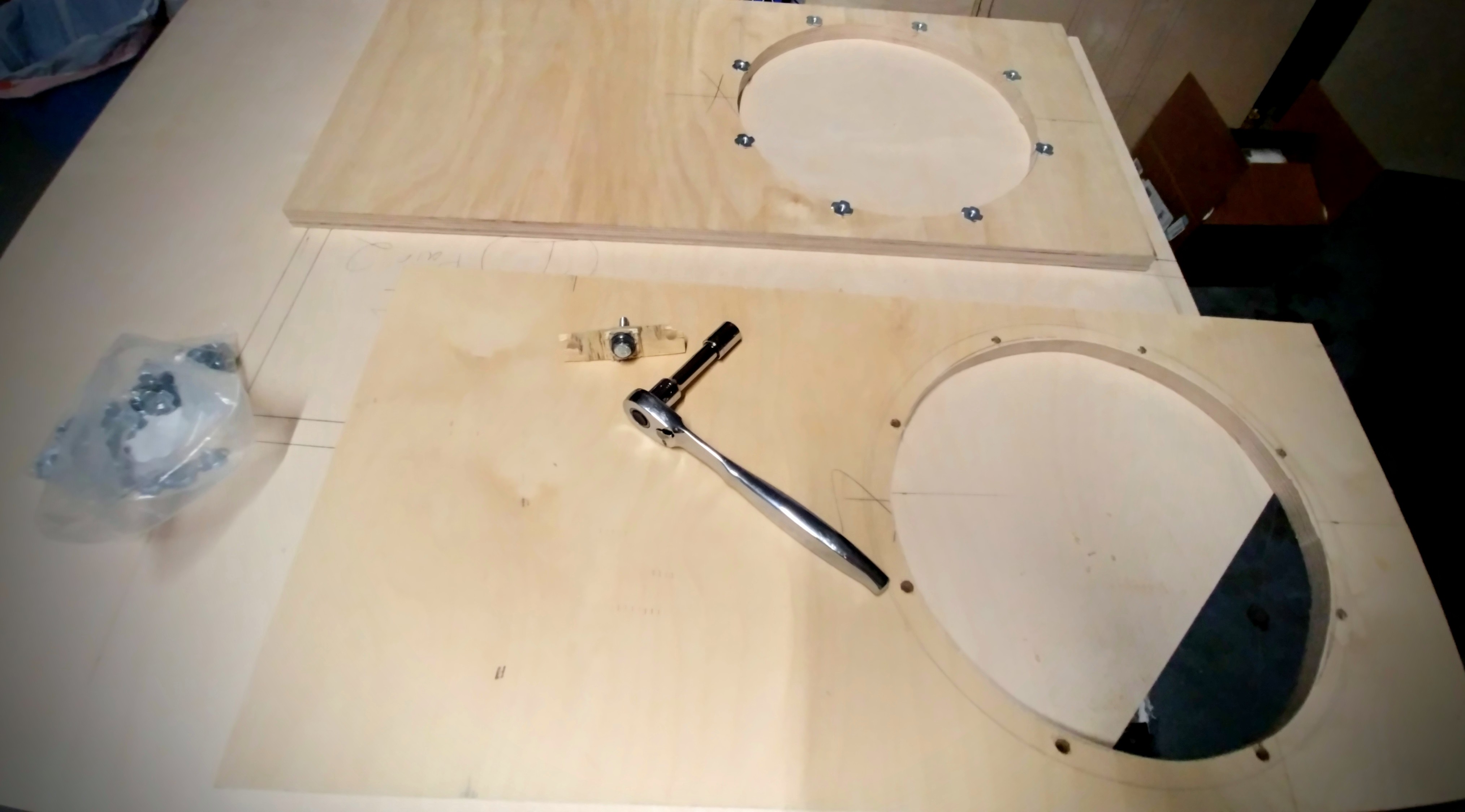

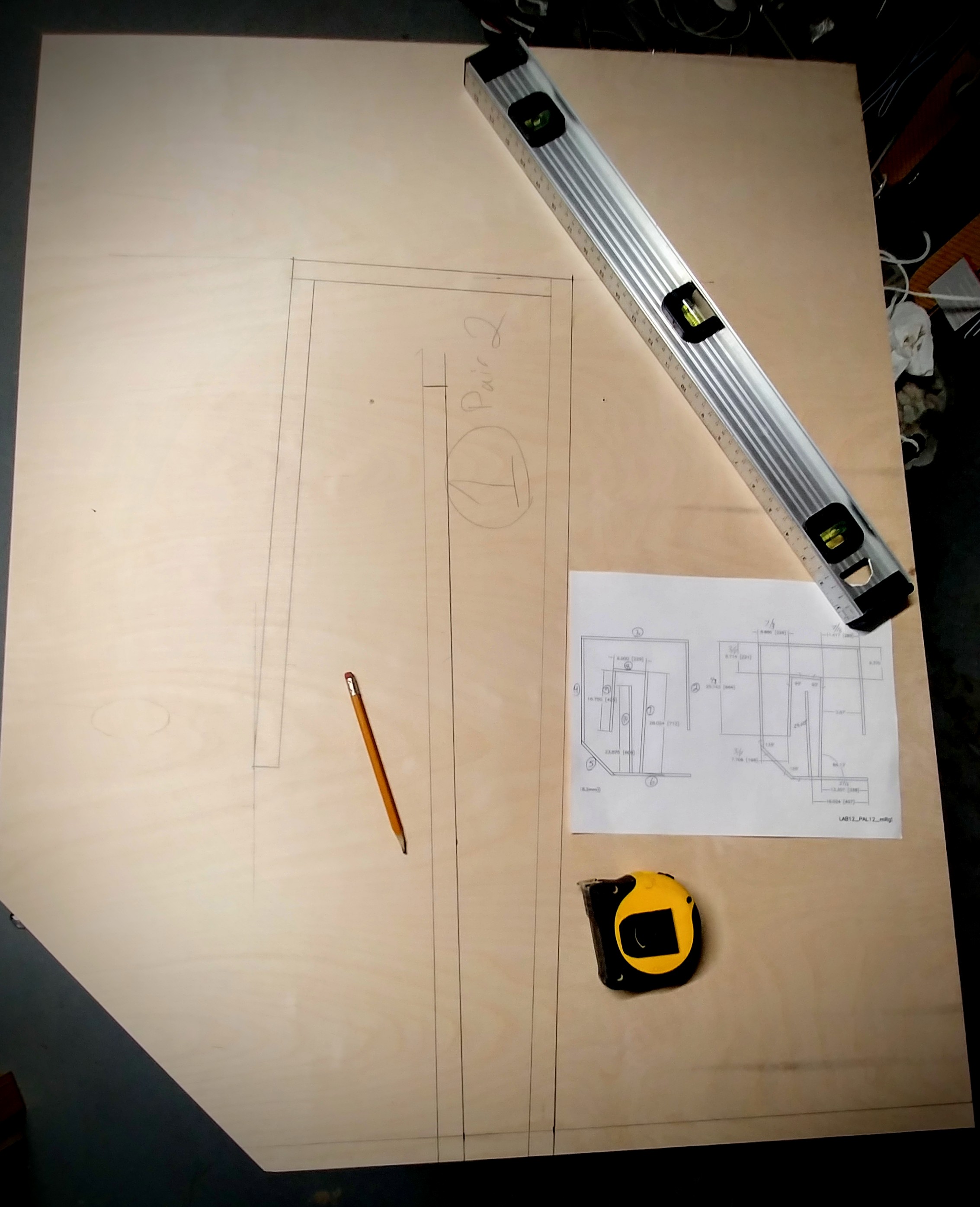

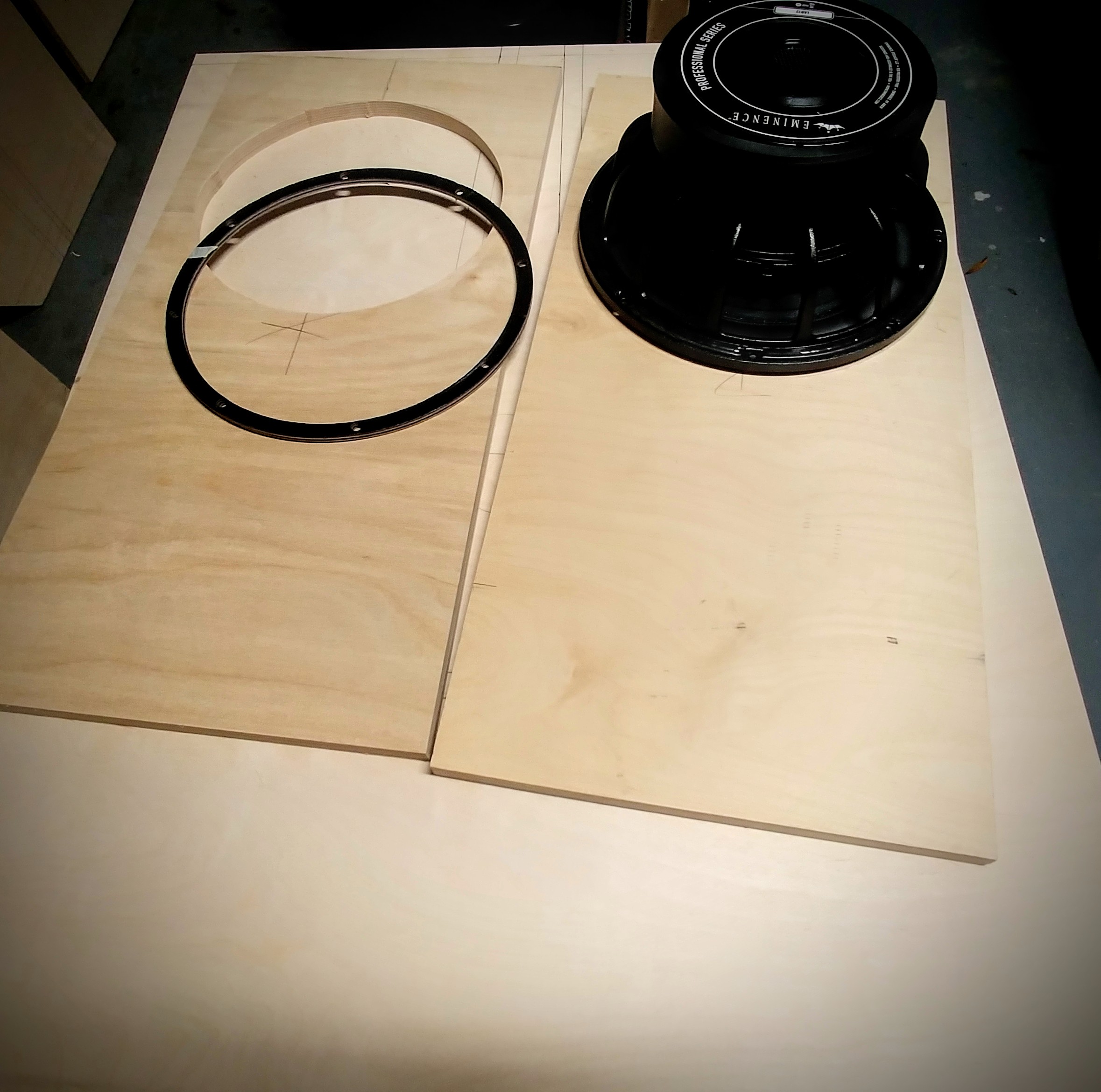

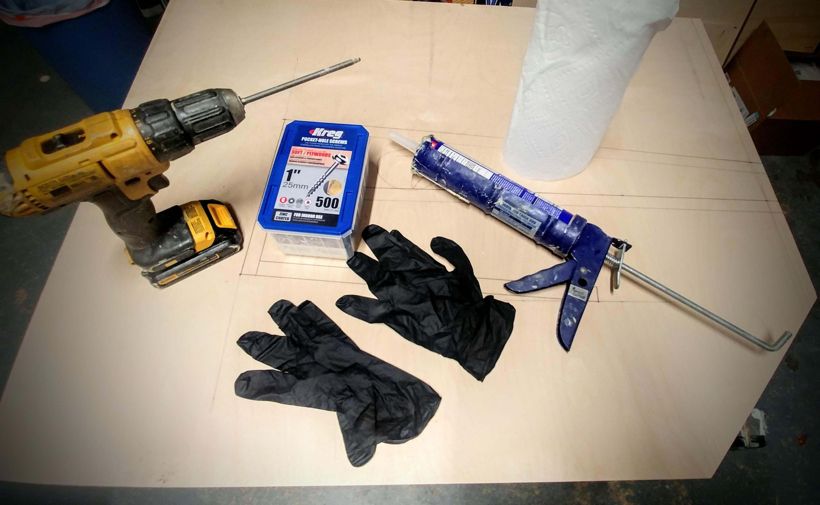

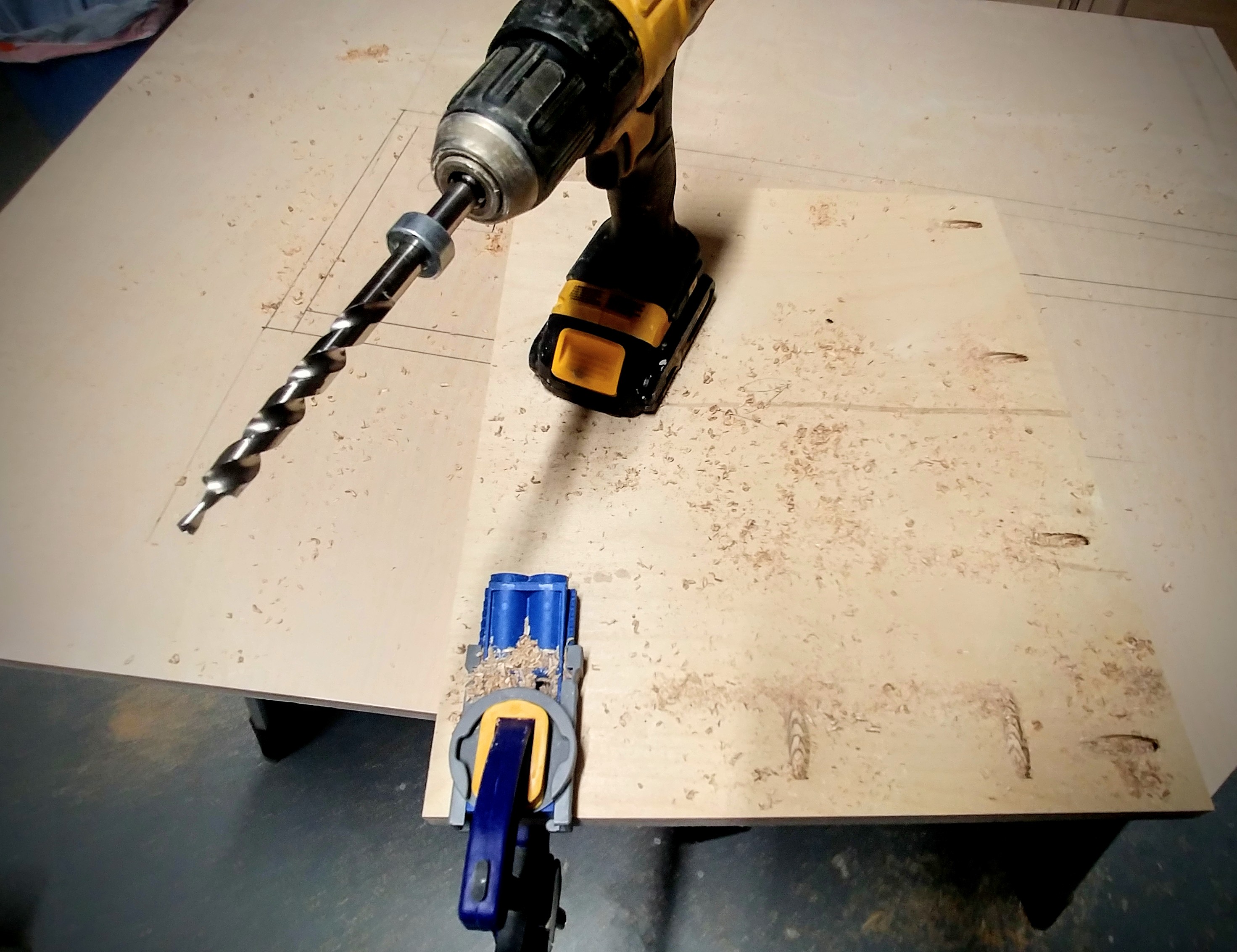

Assembly pics
Here are some photos from my PAL12 building process. About 5 hours in so far.
