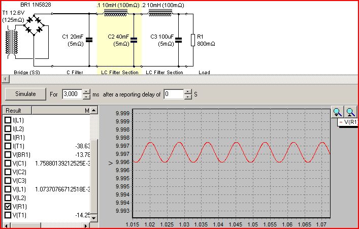

It's a CLCLC..... 20000uf / 10mH / 20000uf / 10mH / 20000uf.
parallel to each cap is a 470K ohm (or will be when built) bleeder resistor.

Like you mentioned before.. sometimes PSUD doesn't match the real world, but when I modeled with PSUD I had to make some assumptions... The Hammond 167 filament tranny is rated at 18v, but I had to assume a 20V unloaded value for PSUD, as most tranny's I've tested always measure the unloaded voltage from 10% to 20% higher than the published RMS rating. So Assuming I have 20.5 volts realworld unloaded ( and PSUD says to use unloaded voltages in their model), if I had just a LCLC, the output voltage was a bit too high. so changing from a choke load to a capacitor load using the SS rectifier, I actually got a voltage drop in the PSUD model to where the output voltage needed to be. Also I had a couple of recomendations from a couple of 304 amp builders that they uses a CLCLC filter for their supplies.
The chokes have a 12.5 amp rating and that is what the filaments in series require. The tranny is able to put out and is rated at the 5v up to 15 amps, of which only 12.5 amps will be drawn from it from the filaments, so the chokes should be fine as they aren't going to be used at the 15A.
Once I get the actual physical transformer in my hand I can take actual unloaded voltage measurement and plug them in the model. Also I have some bigazz 300watt .8 ohm load resistors that I'll use to do a bread board model of the supply to dial in the voltage.
The heaters static resistance in series is .8 ohms.... with 5 volts @ 12.5 amps, thats 125 watts... So the schematic is still "fluid" untill parts are in hand, meaurements are taken and bread board mockups are finished to see actual occurances.

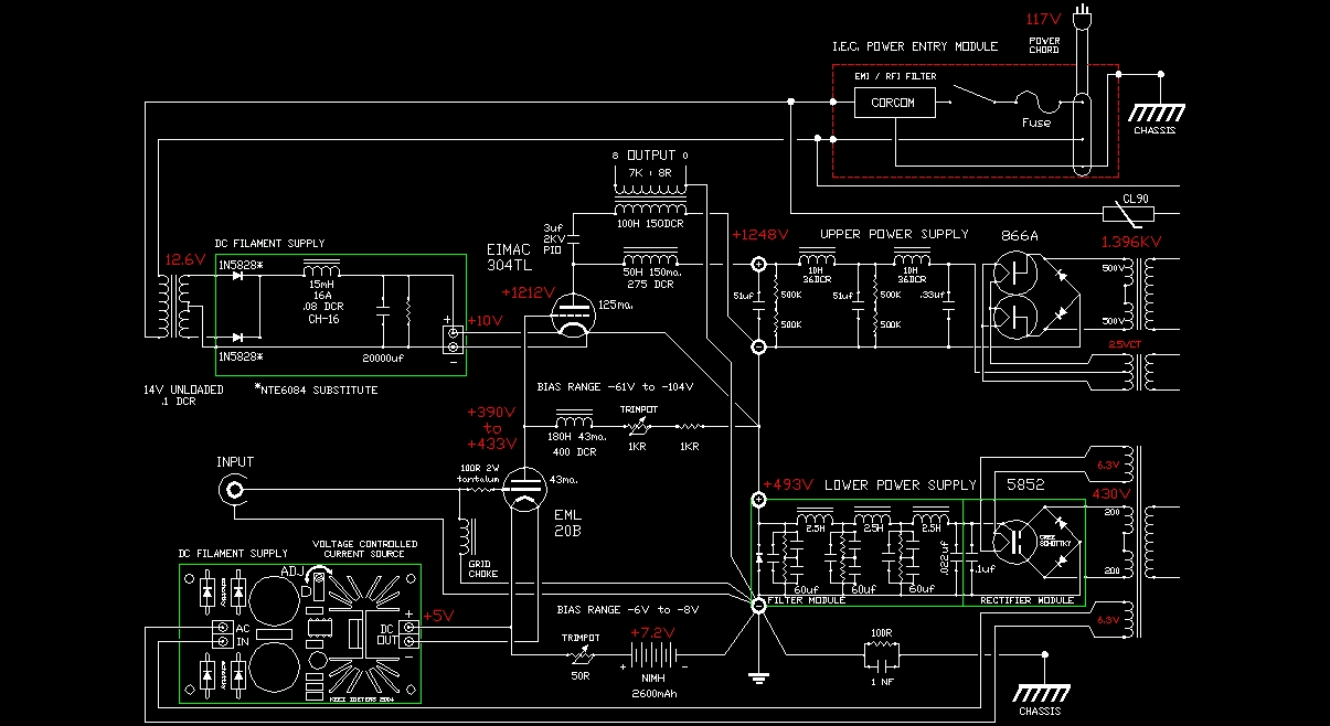

Another refinement to the 304 DC heater supply. Took off the amperage rating of the power transformer so as not to confuse it's max rating with it's actual output. I also noted the approximate unloaded measured voltage and its DCR.
I removed the first C, thereby changing it to an LCLC filter. I also inserted two .5 ohm resistor on each leg of the transformer secondary before the rectifier to increase the effective DCR of the tranny from .1R to 1.1R. Using PSUD, this lowers the voltage at the output of the filter to the 10 volts needed for the filament. After the breadboard is built, I will take actual measurements and trim the values to get the real world numbers needed.

Jeff, a couple of notes
That 10mH/12.5A choke will not work in that circuit at the input ... it should be gapped for 15A as a minimum as it will pass the DC for the filament and filter the AC. Used that way it will buzz and the filter will not work as L input but (kind) like C-input.
A 0.5 ohm resistor in the filter will wast 80W of heat, you are using two of them which is 160W and that is for one channel only. This is not going to work, you will melt everything.
For a 304TL heater you really need to have a multitapped power transformer to hit the 10V at the filaments with a reasonable precision (+/- 5%). That is a trial and error process and you really want to tune it on the real thing.

If I were to change the first choke to say.. 15mH / 16A (found one off the shelf @ 18lbs weight), could the second choke still be the 10mH / 12.5A? as the second choke does improve the voltage (on paper).
Bumping up th wattage on the R's isn't really an issue. I was just taking the RMS current at the transformer (as the value PSUD was giving) and using that to equate the wattage with ohms law. I arrived at 12.5 watts.
RMS current was about 5 amps, resistor is .5R so P=Isquared X R = 12.5 watts. I doubled to 25 watts for good measure as the resistor was not the final after rectifier DC load but a "pass -thru" of AC

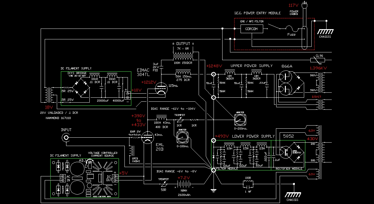

Then consider that 12.5A of current through 1 ohm will drop 12.5V leaving you with an 18V transformer that if it were to deliver 12.5A of current will only supply your bridge with 5.5V.
This really isn't that hard.
18V * .9 = 16.2V
drop 2.8V for the bridge = 13.4
12.5A through .22 ohms drops another 2.75V = 10.65V
If the DCR's of the chokes are rated at 20C when they heat they might go up a bit. You will also lose a bit of voltage in the wiring. In any case if you do find you need to drop the remaining .65V you need 50 milli-ohms.
If it were me and I wanted to lose a fraction of a volt i'd put an appropriately sized thermistor on the primary.

Here are my comments:
Average current will be the same 12.5A throughout this supply. That has some implications.
The FRED diode bridge is probably dropping ~4 volts at 12.5A average current once it warms up. It will need a big heatsink to dissipate 50 watts or more. I would look at the 1N5828 Schottky diode which will drop < 1 volt in a bridge configuration.
0.5 ohm resistors will dissipate 12.5^2*0.5 ~78 watts each.
I'm skeptical about taking the cathode connection from the transformer CT. That needs to be thought through as to what artifact will appear at that point. A related issue is the low AC impedance of the final filter cap across the filament, which puts it in the signal current loop.
After thinking about this and playing out all of your design ideas, I would go for a well shielded high quality SMPS with the 10-15mH choke in one line, with the opposite side of the filament used for the cathode connection. Alternatively you could get fancy and use 2 chokes and a 10 ohm resistor divider for the cathode connection. The choke on the SMPS output does 2 things; it filters out any noise from the SMPS (could use a RFC also if needed), and it provides a high impedance block to the audio signal current that will appear across the filament. This will additionally allow you to reconsider 5V operation.
The ammeter connections need to be looked at. The top ammeter appears to be shorted across, and the bottom ammeter seems to create a short circuit from driver B+ to ground.

Alright, another have at it.
Changed tranny to 12.6v.(.1DCR), Bridge is Half Wave using Schottky NTE6084 diodes (can't locate 1N5828's) each with a Vf of .55v (in spec sheets) so these are equivelent subs (according to Newark). Changed the choke to 15mH and 16A (found one off the shelf). One big Cap and a bleeder. This should get the voltage to 10. May have to tweak with a little R in the real world... Also wondering If I should shunt (C and/or R ) the diodes... and left the meters off the schematic for now.

12.6V *.9= 11.34 choke input
-.55*4=9.14 rectifier drop
- 12.5*.08=8.14 choke DCR
I'd be surprised if you got more than a 8V out of that filter. You could toss in an input cap to get the voltage up to what is needed but your original filter with 18V should be really close to spot on. Why don't you just clip lead the thing up and see... with jumper cables of course
