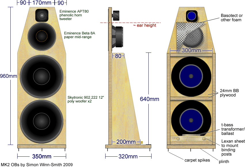

Hi Simon,
building your own loudspeakers is all about compromises and preferences. What will work in one aspect may make things worse for another aspect. And the sound that appeals to one man may make the next one run away.
So there is no need to obey anyone - its worse: For any one question you will get two divergent answers (at least). And you have to decide which one to choose. How about throwing dice?
Slanting the side wings is such a compromise. It could reduce a resonance, if you hear one. And it will reduce the bass level, but may be you don´t need that much. I believe this is a classic cardbord area: Try with cheap material what happens and decide for yourself.
I never experienced "strong U frame colourations" from my own dipole bass constructions, but I always made sure to avoid real resonance peaks (what your U frame does too) and crossed over low enough.
WRT a wider baffle I have just posted my thoughts at the Audiocircle OB forum. It would not make sense to repeat myself in this thread. And it concentrates on midrange and treble issues, which you already have nicely covered. I just mention it because the issue came up.
BTW: I never use MDF, because I simply don´t like the look and feel. Ply is what I prefer too. My local dealer has "silk screen ply". Don´t ask why it is called like that, but it is a much cheaper ply version that doesn´t care as much for looks as regular baltic birch ply.
Rudolf

Because of advice from guys here and Thorsten Loesch via e-mail I've decided to taper the wings quite a bit to hopefully reduce their audible degradations.
To (very slightly) make up for the reduced side wings I've made the baffles as wide as possible for my room - 35cm.
Also as per Thorsten's recommendations I will add some Basotect or foam with similar acoustic properties behind the mid driver to reduce excessive rear output. Being close to the rear wall necessitates this, I'm told.
I will be researching materials to experiment with behind the woofers to increase their effective Qts, as suggested by Graham Maynard. I'll try this on my current speakers (Qts = 0.40) first. I found through experimentation that increasing effective Q by inserting series resistance (in the low-pass coil) actually REDUCES apparent deep bass output, by some mechanism I don't well understand. With a lower DCR coil there is deeper, tighter, punchier bass.
I've now decided on 24mm baltic birch ply or maybe 24mm spruce ply to construct these from, which my newest diagram factors in.
Check it out, attached.

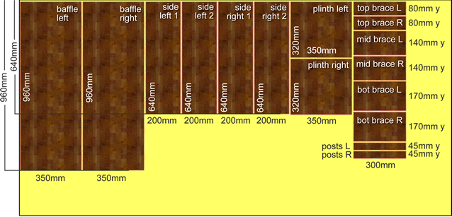

In case anyone's wondering how neatly that can be cut from a 2.4 x 1.2m sheet of plywood, here it is (accurate scale). It's something like £70+vat for a sheet from Arnold Laver!! I think it will be worth it though.

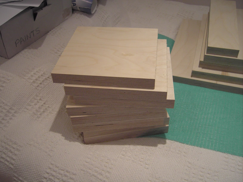

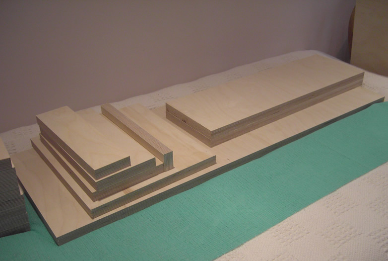

I bought the 24mm Baltic Birch (Latvian) plywood from Arnold Laver. They couldn't really tell me much about it and were stunned themselves at how much it costs but it's simply stunning! I paid £80 including cutting, which I think is reasonable. There was a lot of cutting to do, and those guys did a terrific job.
Although not specifically sold as void-free, it doesn't have any real gaps at the edges, and the knots have been machined out and plugged with wood.
Here's a pic of all the main parts for one speaker.

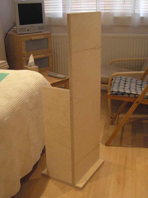

It has something like 17 plys and the finish on top is wonderful, I won't be putting anything on it at all - this is a bonus with this design as there's not much woodworking (other than what any timber merchants will do for you) and no painting or varnishing (I find varnish ugly).
Here's one speaker standing aided by nothing more than gravity.

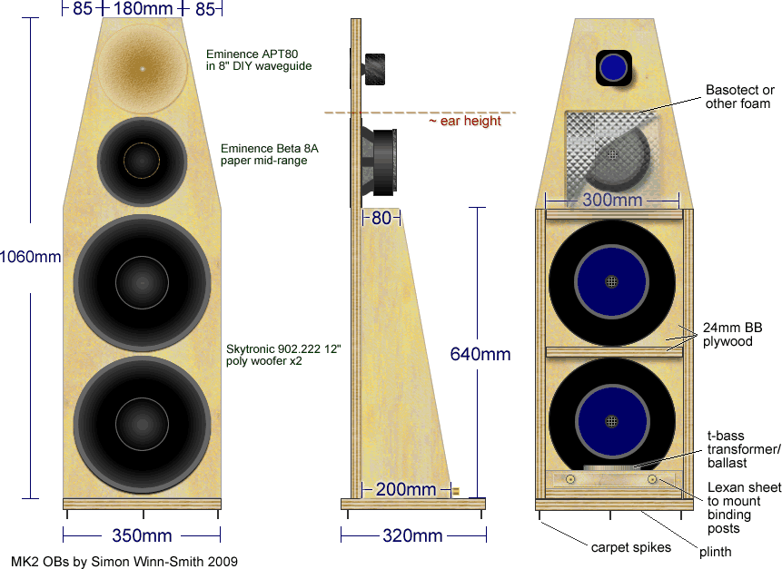

Here's a printout from the Excel spreadsheet someone provided on the "Geddes on Waveguides" thread elsewhere on here (will find link and credit later).
As per the instructions, I set the parameters in the spreadsheet to give it a 1" throat size and just under 8" overall diameter. It looks like it's only going to need three sheets of plywood to achieve the correct depth.
I want to use a waveguide to better match the dispersion characteristics of the midrange unit and lower distortion. Most importantly, Thorsten said I need one!
Here's a very rough mock-up of how it will look with the waveguides in place. Out of necessity it's quite a tall speaker now.
Depending on where the acoustic centre of each driver is determined to be in relation to the listening / ear height, the waveguide may protrude from the baffle slightly. This being the case, it could potentially overlap the mid driver a little - if this is deemed to be wise.
Your thoughts gentlemen.

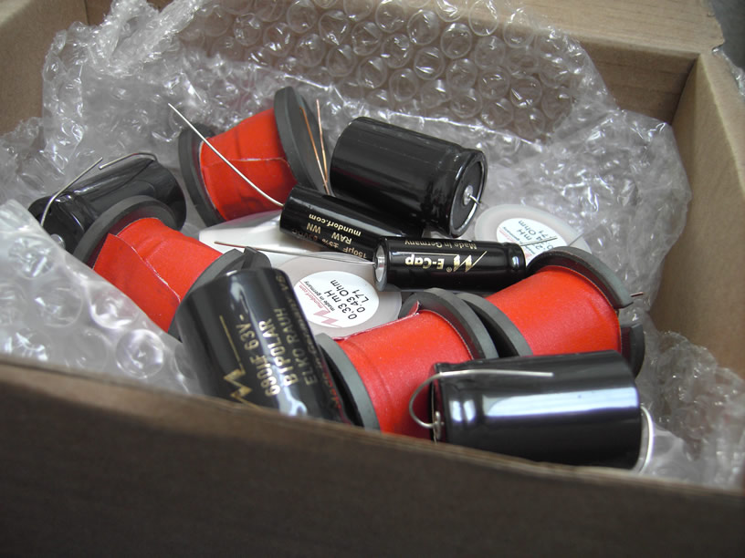

I get my caps and coils from my good friend Lee @ http://www.diyhi-fi.co.uk/
I'll ask him to show his face here, you'll need to contact him directly to get access to the full range of coils and caps - he can order anything from Mundorf (but they are a bit slow - WELL worth the wait of course). And bear in mind if you order elsewhere in the UK (I've tried at a couple of places) you'll also wait a long time because nobody (AFAIK) keeps stock of a wide range of Mundorf or other quality coils and large bipolar caps.
