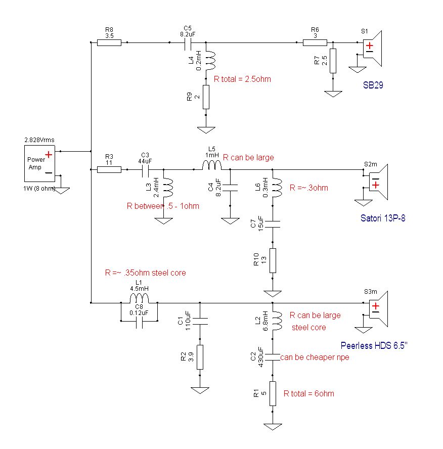

Right then, below is what I came up with.

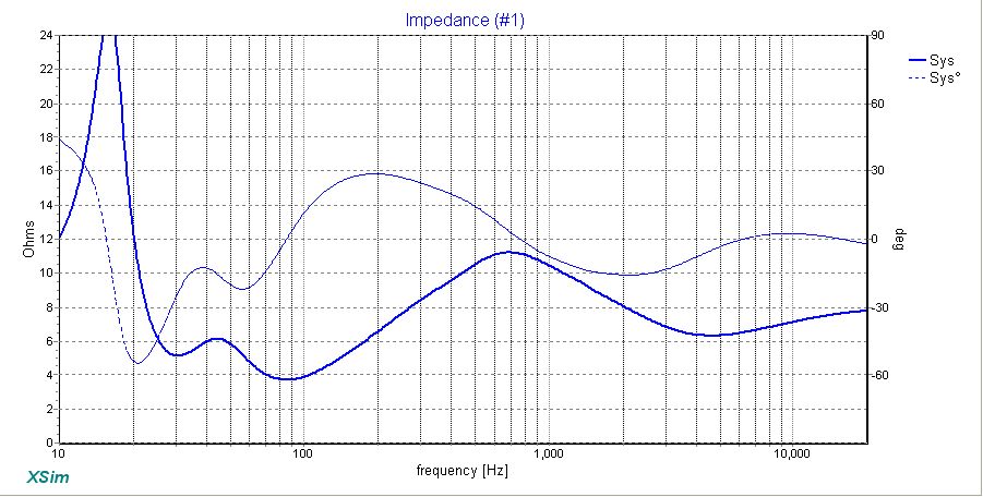

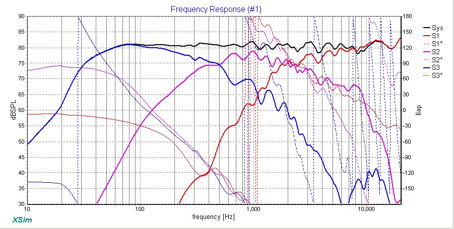

All acoustic slopes are LR2 with xo points at about 500Hz and 2200Hz. Mid polarity is reversed and phase aligns very well through the xo regions. Minimum impedance falls just barely below 4ohm at about 85Hz. That'll be no problem at all. I have targeted a flat response but if that doesn't work for you, you can alter the tweeter and/or the mid levels pretty easily with their series resistors. Both the tweeter and the mid actually needed a fair bit of padding. I used an L-pad on the tweeter and then added a small resistor up front (R8) that makes it easier to adjust. For the mid I liked the response better with series resistance only (R3).
I would suggest steel cored inductors for the woofer circuit. L1 should have as low resistance as possible, more or less, but L2's resistance can be as large as you want.
If you don't know, if an inductor is in series with a resistor, then it's only the total value of the resistance of the inductor plus the value of true resistor that matters. Or in other words, resistance sums in series. So for eg, in the woofer's LCR filter, the total R is about 6ohm so L2's R value is 1ohm. In the mid circuit, L5's resistance can also be large (in the sim I have it at 1ohm ) but if you change it, you also just need to adjust R3 accordingly.
Capacitance on the other hand sums when in parallel which is good to know when you can't find the exact values listed. Again in the woofer LCR, C2 is going to be fine using a less expensive capacitor like a non polarized electrolytic.
Measured responses btw were actually pretty close to the simulations but the acoustic centers of the mid and the woofer were both a bit different than a simple physical measurement would suggest and that meant several changes to the xo from my prior simulation were necessary to get good driver phase alignment. Best was that the tweeter went from 4th order electrical to 2nd order.
Set it up for yourself and play with the values so that you can see what everything does as well as see what variation in components values will still be acceptable.
I'd feel better if I was using measured driver impedance but once you get the xo together, you take another measurement on the tweeter axis of the whole speaker together to see how it corresponds to the sim. And of course, your ears are the final arbiter.

The FR graph looks very nice indeed and a flat response is something I wanted to achieve on this project! I'm impressed and happy with how that's turned out.
Polarity reversing isn't something I was expecting but its not a problem for me to implement. I was actually reading (a few days ago) a little on this subject and how polarity effects phase.
I need to digest all this info and get my head around some of it also :)
With regards to the inductor.. is the use of iron core purely a cost saving exercise or will iron core in woofer circuit provide better results than air core?
I think you have covered everything (for now) :) Do you have a copy of the XSim project files, so I can have a play?
Thank you once again.
I attached a copy of XSim with your 3rd measurements of the drivers and the manufacturers' zma files in post #204 on the previous page. I was thinking it would be good practice for you to put together the components to arrive at my finished results but here's a copy of the finished one below.
The air core is the better inductor to be in series with your woofer but the problem is that you need the inductor's resistance to be low, I would say somewhere around .3ohm. But to achieve high inductance, you also need more and more loops of wire and so to keep resistance low, the wire diameter has to get bigger and bigger too, so now you end up with a very big and a very expensive mass of copper.
However I seem to recall seeing some types of air core inductors out there that do a pretty good job of overcoming this problem but I can't recall now where or which ones they were. If you can find an air core that fits the specs and your budget and available space, then go for it but if you're almost paying more for a single inductor than you did for the driver, I don't think it makes much sense.
Some kind of metal core is still advisable for the woofer parallel inductor as this one isn't quite as important to the SQ.

Looks ok from what I can see except for that Jantzen 20AWG inductor. I expect its resistance value is going to be too high - locally, the same animal from Solen has an R value at 1.6ohm. I would be trying to stay down in the .3ohm neighborhood.
Also, I'm not seeing that tiny little .12uF capacitor that goes parallel to the woofer inductor. You may be able to get away without it but your woofer is the only driver of the 3 to have a bad resonance (up around 7kHz) and so I put that capacitor in there to bring it down a little more than the mild 2nd order rolloff does. Up tp you of course, but it's tiny and cheap so I'd say use it.
And I like the way you stocked up on the 1ohm resistors.

The coils in series with your drivers are the most important ones. So definitely the 1mH on the mid. Doesn't have to have a low R value though, just compensate with R3, also in series with the mid.
The other one is on the woofer. See my post above.
