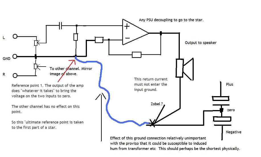

Administrator
Joined 2007
Remember this is for running TWO amps off a common PSU.
This is how I see it. We have to have a single point of reference for both channels. In a way this is a star in its own right. Nothing else should connect here.
Whatever output current the amp sources or sinks this can in no way alter the input reference point ( for practical purposes, as even the small current in the feedback return does flow down the blue connection to the star earth).
When all this is drawn out it all looks very straightfoward but as I keep banging on, to me this is so at odds with DSelfs layout.

The Blue signal ground is connected to a very low impedance.
Does this make it less susceptible to either form of magnetic/electric interference?
referring back to post 39.
The two input RCAs have to be commoned at the terminal panel to allow a single Signal Ground connection back to the two channel Audio Ground.
