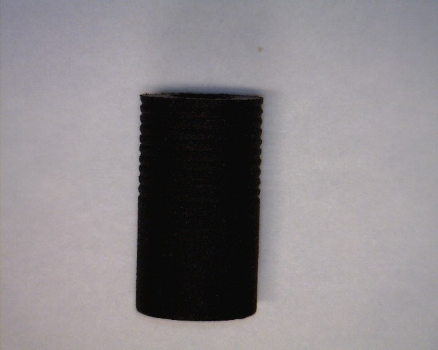

I've been loaned a Unimat micro lathe for awhile, and have been experimenting with making my own pulleys. The results so far are looking good. They seem to run true, and are snug enough on the shaft to not require a set screw. I might add set screws anyway, but I need to set the Unimat as a mill first.

I received the pulleys (ordered a 1/2", 0.75" and 1" for mucking around purposes) mentioned in my earlier post- can report that the standard delrin on brass versions fit the shaft nicely. They require a tiny bit of pressure to get on, but once on there's no play that I can detect, and snugging the grub screw is all that's needed to stop any slip or axial movement.

Gentleman, May I offer my services in machining These motor pulleys?
I have small precision lathe with adjustable Head stock bearings for very very round parts, remember these parts are only as good as your headstock bearings!, no engine lathe is good enough
Things I require are simple dimensional drawings "imperial" dimensions please,
another would be the actual Motor's themselves or the motor shafts, so i can make exact fit, no measuring tools will do, I have small bore gage's but not reliable enough, I have dial bore gage but way too big for this use. once I make and size the part, I can make up my own go no go pins and return the motors or shafts.
but I digress NOTHING is perfect but I can get as close as possible

Alright, need to study little more, I might have some other questions, Now I do not like the setscrews idea for the simple fact of de-burring the bore, its a simple solution, I get that but IMO an interference fit would be best, I would have to look this up in my machine hand book , but I understand if this set screw is what you want
making the tools 120deg should be straight forward, I wish they were 60 deg included angle as i have plenty of threading form tools
materials would need to be supplied of course and Delrin/acetal is best because of its dimensional stability plus it machines very nice good idea
I can also do one off if you need something special
