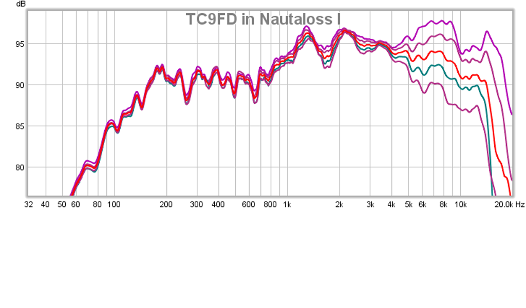

My favorite 3 inch is the Peerless TG9 or the Vifa TC9 (both brands were bought out by Tympany, which also owns ScanSpeak and maybe some other sompanies now). They're cheap ($22 / $12) and have all the right features. Xmax is good but not the best in its class, but that's a tradeoff with dispersion and cavity effect, when the cone suspension sticks out too far (like with the Daytons) the cavity effect shows up on the frequency response graph. They are some of the flattest drivers out there. Superb from 300HZ to 8kHZ, but not bad from 125HZ to 16kHZ. Metal diaphram drivers all have a big resonance somewhere which limits usable frequency response and requires a more complex crossover. They've got rubber suspension (foam disintegrates over time), well vented spider, vented pole piece, shorted turn on end of pole piece (for less distortion at high frequencies), and minimal frame edge so it can be as close to the tweeter as possible so acoustic interference isn't as bad. Roger Russel of McIntosh uses the TG9's in his $19,000 line array system, running them from 20HZ - 16kHZ (using active EQ). I'm using the TG9s in my holographic soundbar, and the TC9's in my computer system. Being able to keep crossover points out of the 1kHZ - 7kHZ range (where the ear is most sensitive and where we detect stereo image location primarily by amplitude comparison) helps stereo imaging significantly.
Their only shortfall, which appears to apply to all drivers in this class (small drivers with good Xmax), is effiency. It's about 85dB 1 watt/1meter. Most hi-fi drivers are 88dB - 92dB area. You could have to attenuate the woofer if the crossover is passive. Or you could design a passive EQ that only attenuated the upper frequencies of the woofer, which you'd probably want to do anyway. An 8 ohm resistor across a large inductor, in series with the woofer could provide roughly a 6dB rolloff from 200HZ to 800HZ, for example.
My favorite 3.5 inch full range driver too. Here are some frequency response measurements of this driver in a Nautaloss enclosure at different angles: 0 deg, 15 deg, 30 deg, and 45 deg. The red curve is the average of all 4 angles. 1/12th oct smoothing. This driver is also very low distortion with THD at -50dB or better above 200 Hz. There is no significant peaking here above 10kHz and peaks are in the 2-3 dB range. A very smooth sounding driver.

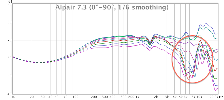

The real problem with the Alpair driver (besides the highly misleading vendor supplied magnitude response graph) is its off-axis behavior. A power response hole followed by a huge peak. Elderly listeners with age-induced hearing loss might find such a power response peak beneficial though.

-The lines you have chosen to encircle above do show a large dip in the off-axis power response. You appear to have inadvertently neglected to mention how many degrees off axis those encircled are. The graph isn't labelled, possibly an earlier version is, but I haven't got time to go back through the thread to find it. But what exactly do you expect from a nominal 4in wideband driver? That, or similar effects varying from driver to driver in location &c., is what happens when substantially off-axis.

The OP is presenting measurements which I think are very helpful to the DIY community in seeing the performance of a fabled driver with warts and all. His measurements are also seconded by measurements of Bob Brines. The main point I see being made is that the high frequency peaks as presented by the manufacturer are indeed misleading and quite different: I see a 5 to 8 dB peaks above 10khz looking at the MA plots. The OP's and Bob Brines' measurements show more like a 12 to 14 dB high peaks above 10khz. Now whether or not people will hear this or notice it is irrelevant to the fact that it exists and is a magnitude much greater than most people would care to want in their driver if they are aiming for smooth response in the upper registers. In reading this thread I do not perceive the OP as attacking the manufacturer other than to point out that the objective data presented by the manufacturer is very different than a purchased and measured unit. I do however see that, very clearly, that there is a circling of wagons around the OP and he is the one being attacked for being the messenger. I for one, don't see anyone showing measurable evidence that break-in will tame or cure the HF peaks. In fact, I would think that Bob Brines' measurements would indicate that this is not the case as those are probably broken in drivers depicted. Here are Bob Brines' measurements again:
Knowing what I know now, it gives me pause when thinking about buying this driver because I don't think an $85 driver should have 12dB peaks like that. If you think you can't hear this, listen to the amplitude when you do a freq sweep - it will clearly go up then down then up and down from the 10 to 15 kHz range - 12 to 14 dB is indeed very audible.

I gathered that; I was hoping you could indicate degrees to colour / line. 90 degrees for e.g. is of little more than academic interest. Up to ~30 degrees is about the typical range of use for widebanders; out to 60 degrees I concur has some relevance in multiway design, but not for drivers of this type.
