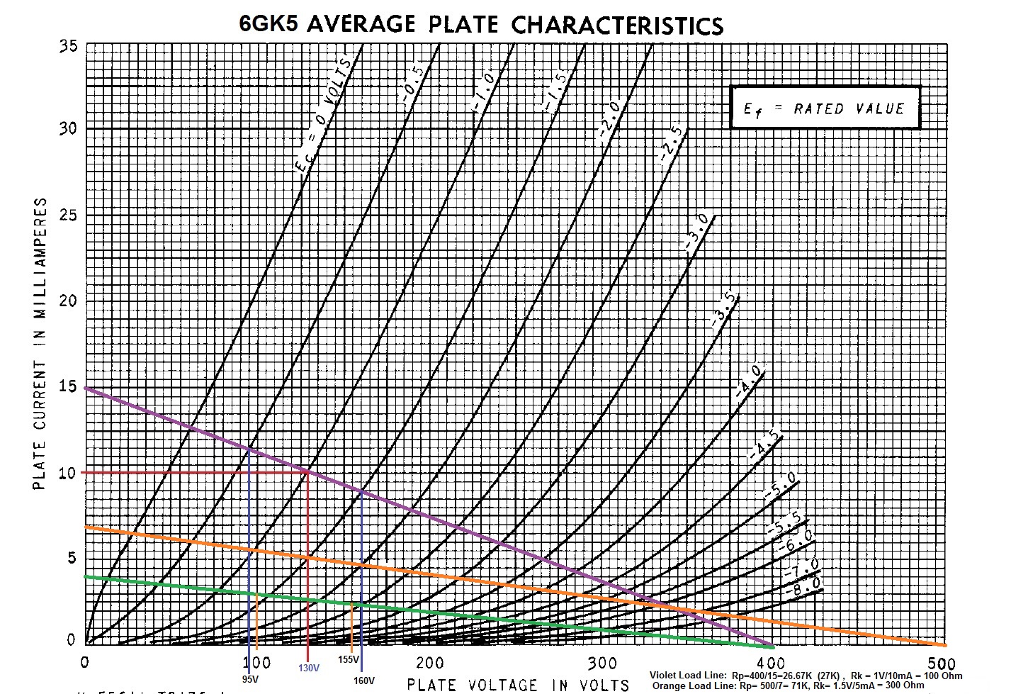

Have you ever built a circuit with 6GK5? I have. It looked easy at first but quickly became frustrating.
Go look at the specs and plate curves.
Max plate voltage 200v so only useful for lower B+ W-L. I know how you like low B+....
Worse still, look at those plate curves - Kinda hard to figure out a linear load line with this little vacuum of wonder.

We must be looking at different plate curves for the 6GK5. If used with a high plate load (ideally ccs or choke) at moderate currents around its specified operating point it is quite a linear tube: Certainly moreso than the oft specified T7. I can vouch for its sonic merit in phono stages and when used as described above.

You make a good point about badmouthing a tube. Sorry for that. Just because I could not find a sweet spot with this tube does not mean it does not exist. I have no doubt this tube is good in guitar amplifiers. I could never make it work to my satisfaction in phono, even at its specified operating point.
As you know, this thread is about directly coupled 2a3 amplifiers, so we probably need the input/driver plate at around 130V or maybe higher. The filtered B+ is probably 400V or higher.
I attached a few potential load lines. The first is unfortunately not so linear (Violet Line - 10 mA). It swings -35V to +30V on a 1VAC input signal. In addition, by my calculation, the "Triode Characteristic Factor" is only 2, so you will have to by-pass the cathode. You could of course use an infrared LED instead to bias it or use a 1V NiMH battery or even global feedback.. whatever floats your boat! It won't be linear though...
So, perhaps you might want to use a bigger Rp and bias for lower current flow? As you see with the Rp=100k ohm (Green load line) it's still not linear, swinging from -30V to +25V on our 1VAC input. Also it's not possible to calculate the "Triode Characteristic Factor" since on my GE specs sheet, mu and Rp values aren't shown for 3mA.
Hmmm... getting tough but let's not give up! Perhaps a much higher B+ would help? Indeed with a filtered B+ of 500V and an Rk of around 72K we start to get a more linear response (orange line) - it appears to finally swing from -30V to +30V on a 1VAC input signal. However by my calculations, the "Triode Characteristic Factor" only gets up to about 2.5 (still much less than 4) so we would still need cathode bypass, LED, NiMH Battery or global feedback loop. perhaps I missed something? Probably...
It would appear so. I looked at the RCA curves. There's also curves by GE, which are better.
The RCA curves are simply not for audio use at all. I wonder why GE and RCA have so wildly different curves?
The linear area is still quite small. It's apparent that the rp is not at all constant. I'd run it at 150V 15mA.
Doesn't need to be. If the plate load is >> rp, then what you care about is the variation in mu with plate voltage.

True. It would seem that drlowmu is looking at about 4 x rp as plate load though.
