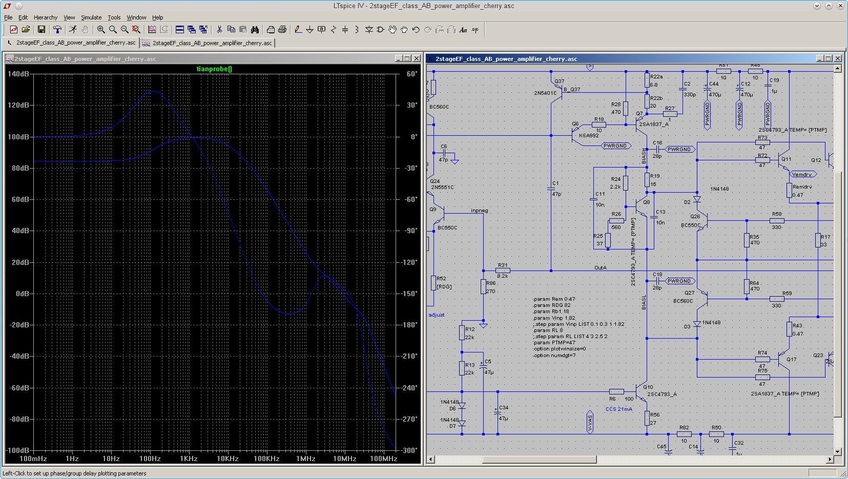

I hope Toni, tests my latest tweak to the Cherry version of his amp. If it works, I'll go into pontificating verbal diarrhea mode.
Of course I will do another "cherry" test. But may take some days...
My sim with disabled output zobels shows you have now achieved about 35 degree PM and 12 dB GM.
I have added 2x28p caps to reflect the long ribbon cable capacitance.
Please check attached sim if your tweaks are correctly inserted.
BR, Toni
BR, Toni
Yes. Everything looks good.Of course I will do another "cherry" test. But may take some days...
Thanks for taking the trouble Toni.

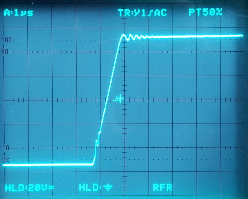

BR, Toni
... and here the result with added 10R as explained ...
Stability betters significant but is not enough for an amplifier to go into production! There is still tendency for oscillation. (See attached picture of 20kHz square wave test using long ribbon cable. Short ribbon cable shows a bit more oscillation).
Distortion level compared to TPC/TMC not so bad but not better as predicted.
long ribbon cable:
THD21k@200W@8R
0.00186% (bw 80 kHz)
0.00229% (no bw limit)
short ribbon cable:0.00186% (bw 80 kHz)
THD21k@200W@8R
0.00197% (bw 80 kHz)
0.00239% (no bw limit)
==> THD betters with longer cable!0.00197% (bw 80 kHz)
