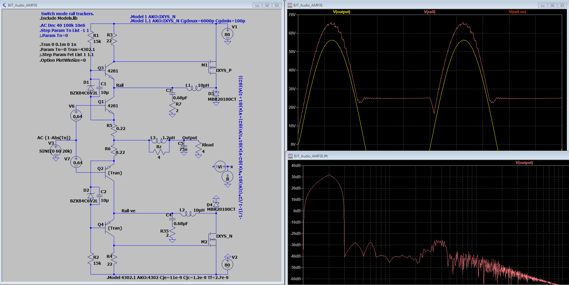

In the meantime here is the schematic of the outputs and switch mode class H.
Super simple, just the switch FET and one transistor to combine the functions of comparator and FET driver.
I use Bruno Putzeys' trick - the filter also contributes the phase shift that makes it oscillate.
*I missed the FFT frequency scale in the snip.
So, at 20 kHz and 400 W it's 60 dB down for 2nd and 3rd harmonics, open loop - no feedback at all!
With the front end and feedback it should be <0.001% distortion @ 20 kHz, if anyone needs a >400 W tweeter driver
Main issue now is to make the FET switch transitions cleaner to reduce losses.
If this is too hard then I can always have a classic, linear Class H supply for the low volt baseline before the switchers kick in.
The only downside is a small increase in power supply circuitry.

I should add that this is just a proof-of-concept schematic.
No attempt has been made to optimise the transistor selection, I just used the models I already had from my Class B+ amplifier.
The outputs can be lower breakdown Vceo and lower power so should be faster and more Hfe.
Similarly the comparator/driver.
The switch FETs have low total power dissipation but substantial peaks as they switch so SOA will be the limit, I haven't checked this yet.
The schematic uses linear rated FETs but faster, lower loss FETs may be possible, especially if a more sophisticated driver circuit is added.
Also the OPS emitter resistors can be reduced to further improve efficiency.

...I'd expect four supply rails...
Instead of 4 rails I have rails that track the output, the terms are used inconsistently but I call this Class H.
The rails are labelled on the schematic and their behaviour is shown on the transient sim attachment.
The trick is that the rails are driven by a simple switch mode down converter so they are quite efficient.

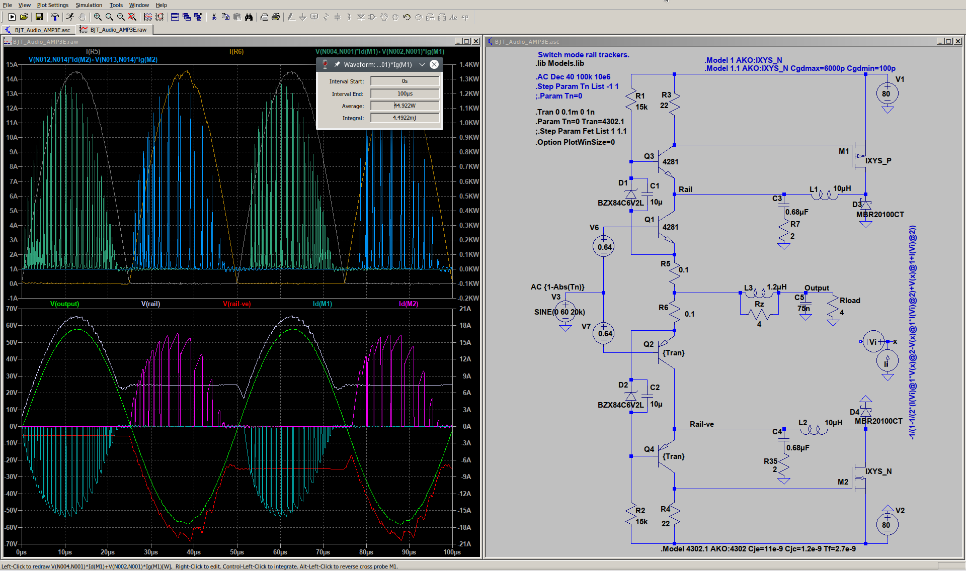

Clever tricks! Have you done some square wave simulations...
Thanks, there is a trade off between better filtered rails and slew rate.
So it's not optimised for square waves.
It is possible to have a separate fast, linear but inefficient path for transients.
Yamaha did this in some of their pro amplifiers.
In practice I will probably use this for the subwoofer and woofer amplifiers that are band limited anyway so not a problem for my application.
I don't need more slew rate than 600 W power at 20 kHz I think

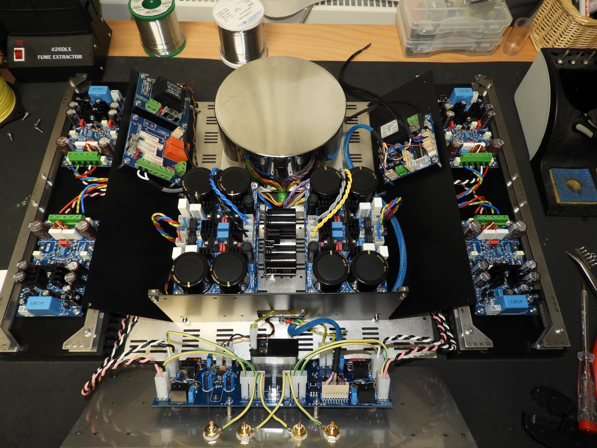

Perfect!
Maybe this project?
2stageEF high performance class AB power amp / 200W8R / 400W4R
Or a quad channel SA2014? (btw: pcb's are on stock for both project variants)
BR, Toni
That is a marvel of layout and enclosure work that I'd struggle to replicate!

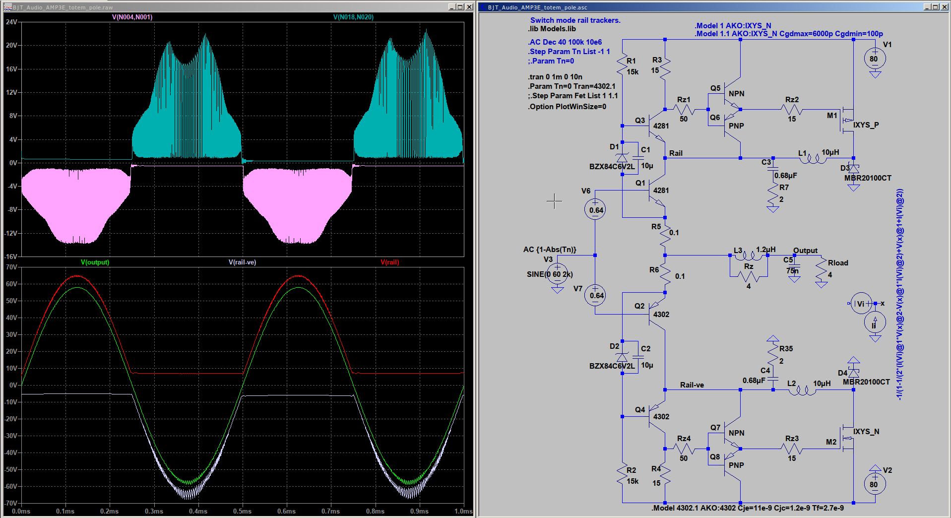

..Where are the FB loops? Which devices carry the supply current, the BJT's or the FET's?...
The attachment shows the Tian loop probe (the V sources labelled "X") in the positive side feedback loop, and the Return Ratio.
So you can see it's a nice oscillator with plenty of feedback
Basically Q3 and Q4 drive the FET and are driven by the output of the FET.
What is neat is that the Q3 (& 4) emitter current acts as a supply to the output transistor in parallel with the FET so there is no wasted current.
It is even possible for Q3 to supply any excess demand that the FET can't keep up with in a transient (needs a bit more complexity however).

...about a ~ 350 - 400kHz
With this simple circuit it's near 1 MHz and seems OK.
Need to find more suitable transistors before serious optimisation of the frequency to best balance rail ripple/noise and switch losses.

totem pole: maybe something like this - see picture. Unfortunately the switching frequency highly depends on input frequency and voltage swing too...
I have simulated 2k input and the switching frequency changes between > 2MHz and 500kHz. IMHO > 500kHz switching frequency may lead to very high switching losses in the IXYS FETs. The upper plane shows the gate voltages of the IXYS FETs.
The example is dangerous as the IXYS could be destroyed because the totem pole drivers deliver to high gate voltages depending on the rail voltages. We would need 2 extra supplies for the FET drivers.
BR, Toni
