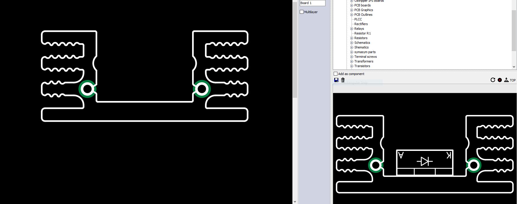

Before soldering the heat sinks place pvc washers between pcb and heatsink solder legs to avoid short circuit with rail voltages. Do this even if your pcb has a very good stop paint!
hello thank you for share your work question what is the part number of that heat sink? I was able to import the gerber to Sprint file today
