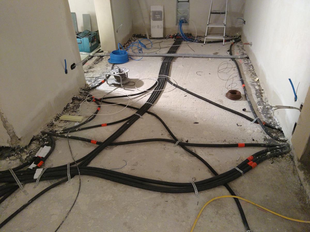

Off topic: new home cinema and laboratory
... cabling for ASTXLabs ...
