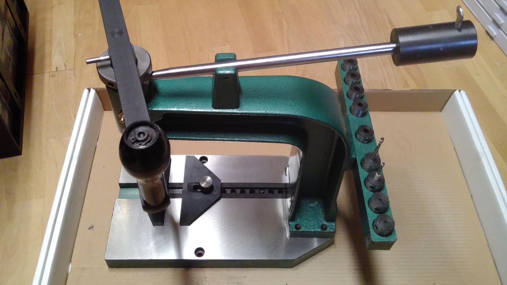

case preparation - tools
... after several years of searching I found a simple hand tapping machine which saves me a lot of time (19 kg; up to 190mm wide so I can prepare metal plates which are up to 380mm wide).
BR, Toni
BR, Toni

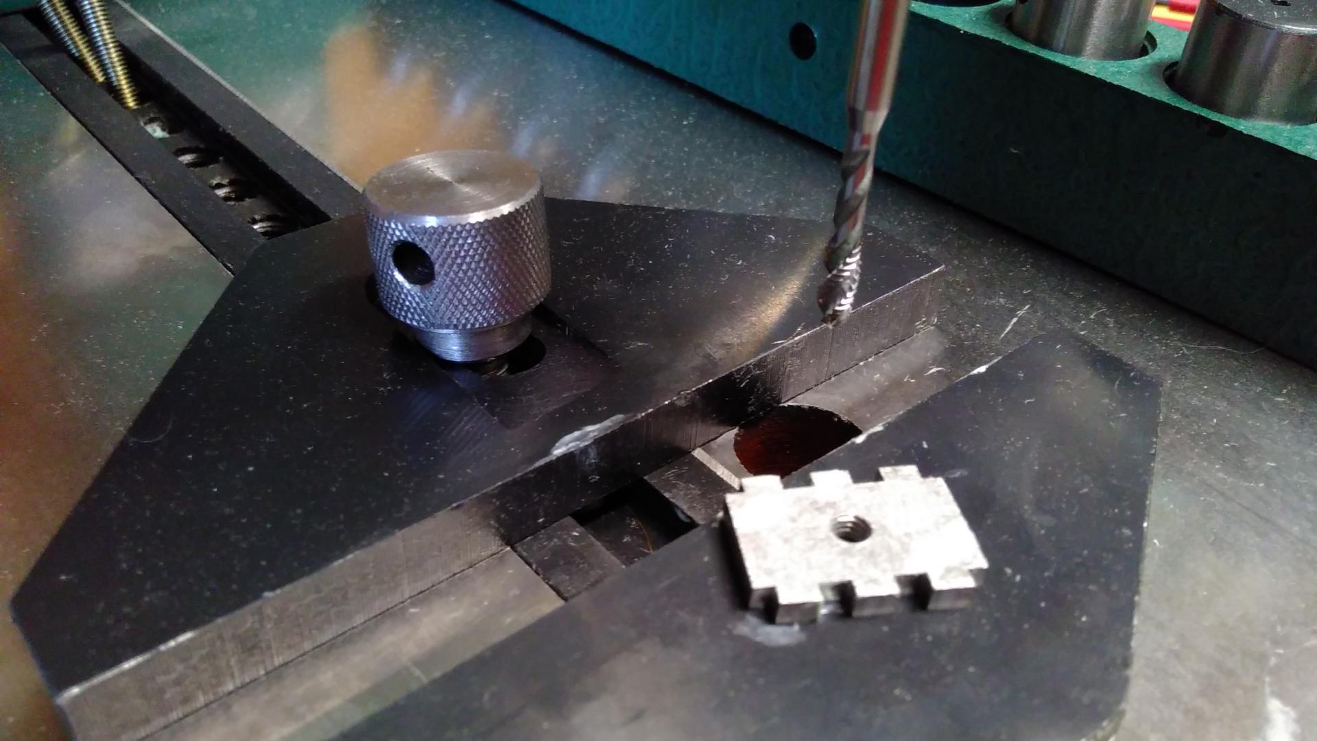

The small part I showed above is stainless steel 3mm thick. I have done a few with my li-on power drill but never got it exactly 90 degree...
Using a cordless drill oder li-on power drill for M3 is a nightmare because you can easy destroy your M3 tapping drill and therefore convert your expensive heatsink to cheap metal waste.

Sorry! I've never seen such a machine before but often searched for a simple tool. Sometimes you don't know the correct words to search for ...
I've bought it here:
https://www.zujeddeloh.de/produkte/...chneiden_--366/gewindebohrapparat--_5621.html
and found it here too:
https://www.amazon.com/Grizzly-G874...ref=sr_1_2?s=hi&keywords=Hand+Tapping+Machine
BR, Toni

How well does that work with small threads, such as M3?

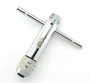

I currently use a T bar tapper as shown in the attached picture. That works fine although you need to be careful to tap straight into the hole.

I have the same tool and after tapping about 25 x M3 for my quad channel SA2014 I started to be tired and broke the M3 tapping drill ... heatsink useless ...

I do M3 in heatsinks all the time with no issues. There are a couple key things needed to be successful though. The heatsink needs to be real aluminum (T6063-t6) not the Ebay crap with all the garbage in it and it needs to be drilled with a sharp drill bit with coolant so the aluminum doesn't get hot and anneal.
The problem is not the heat. I too use a special drill lubricant.
The problem is the exact 90 degree angle and trembling fingers of an "old" man ... crack ... drill bit is gone ... heatsink too...
BTW: I do not use cheap heatsinks. They are made by cooltec and length cutted by them exactly for my needs! Best you can get!
I use a base drill and then,after drilling,a hand tool for tapping.The problem is not the heat. I too use a special drill lubricant.

I guess this depends on how often you tap holes. This is a daily thing for me for 25+ years. I can tap perfectly straight (or straighter than the threads on the fastener) with a Milwaukee cordless drill. It I try to use one of those crappy T-handle tap wrenches I get it crooked just about every time. The extra length of the drill allows me to judge the angle a lot easier.

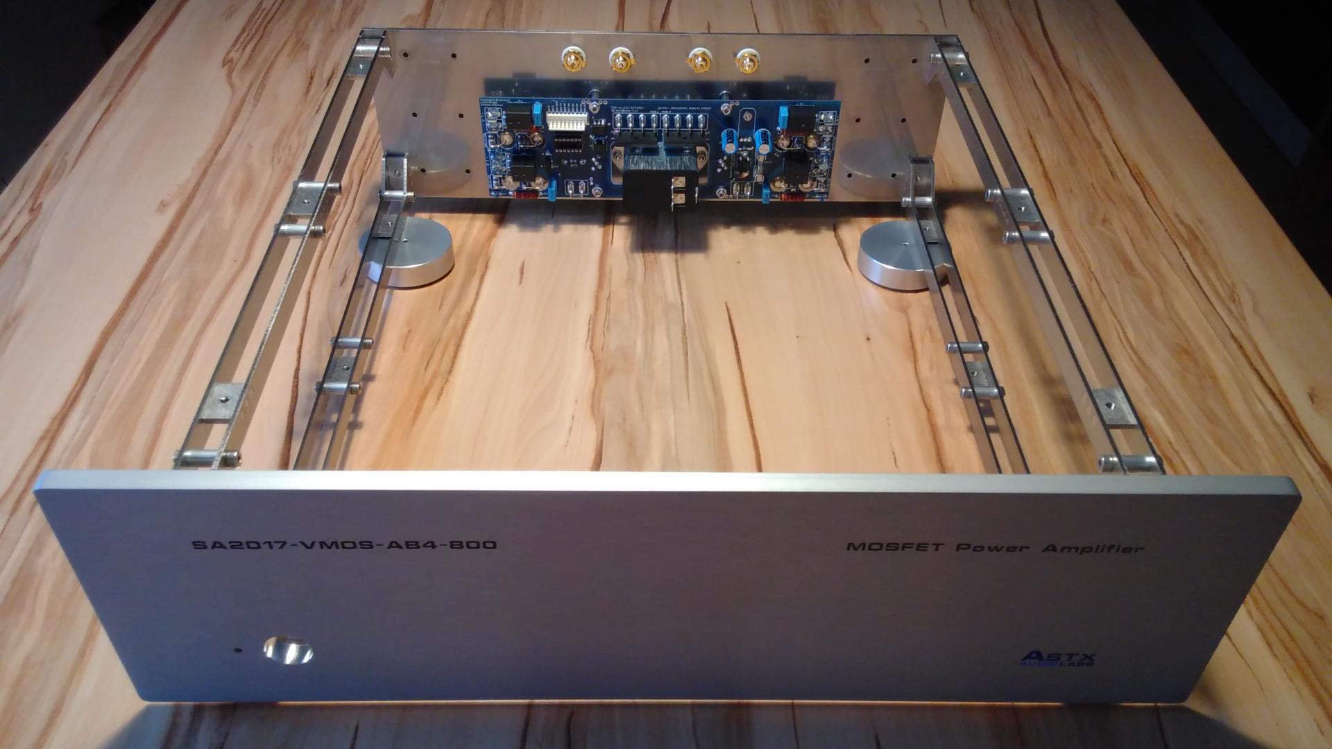

... frontpanel is inserted ... easy removeable ... all parts fit so far ... puuuh
A very-very well done diy enclosure!
