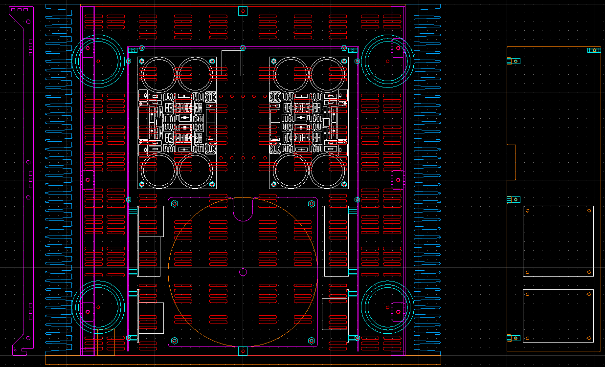

SA2015 4 channel VMOS - case layout
CAD top view.
All needed metal parts are now in production. Will take some weeks to get them all. Laser/CNC cutting, powder coating, anodizing...
CAD top view.
- red colored: bottom 2.5mm stainless steel plate with ventilation slots.

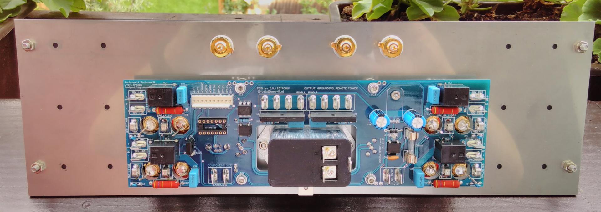

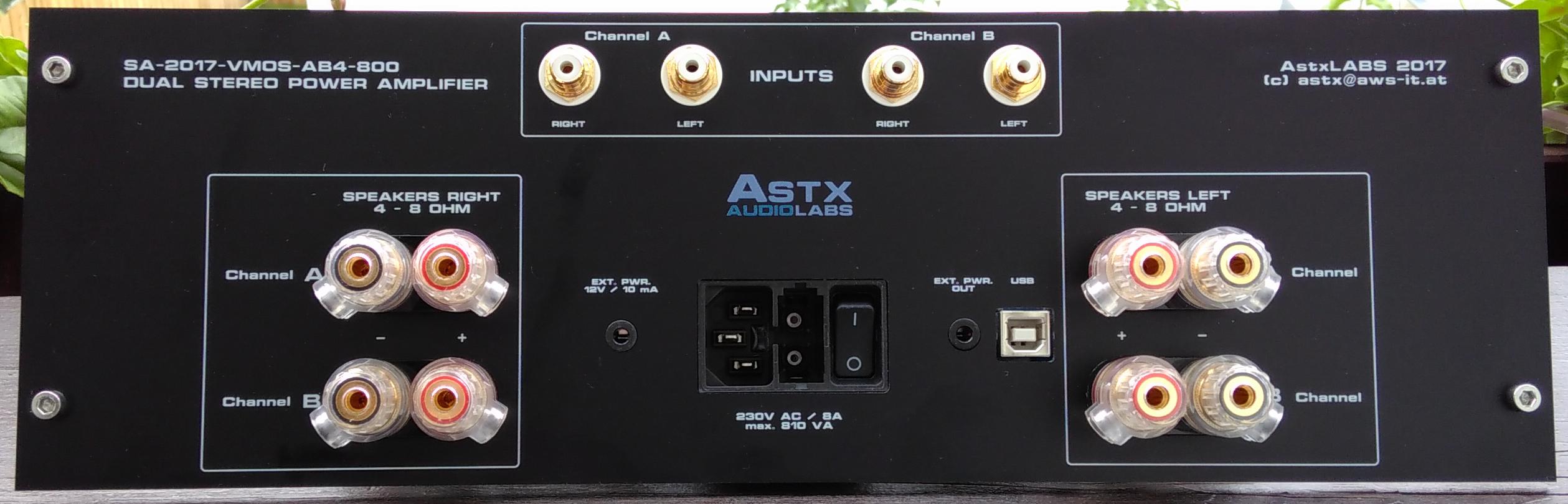

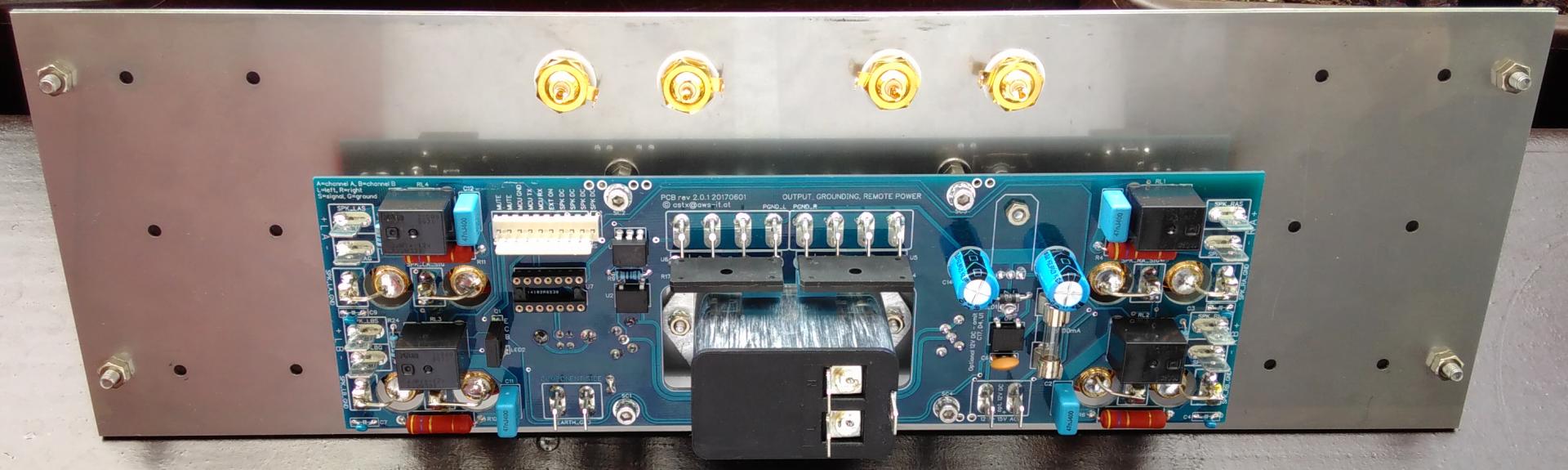

... backpanel assembled.

The amp is looking great so far! It's nice to see a chassis that is properly designed for an amplifier not a big box with parts stuffed into it.

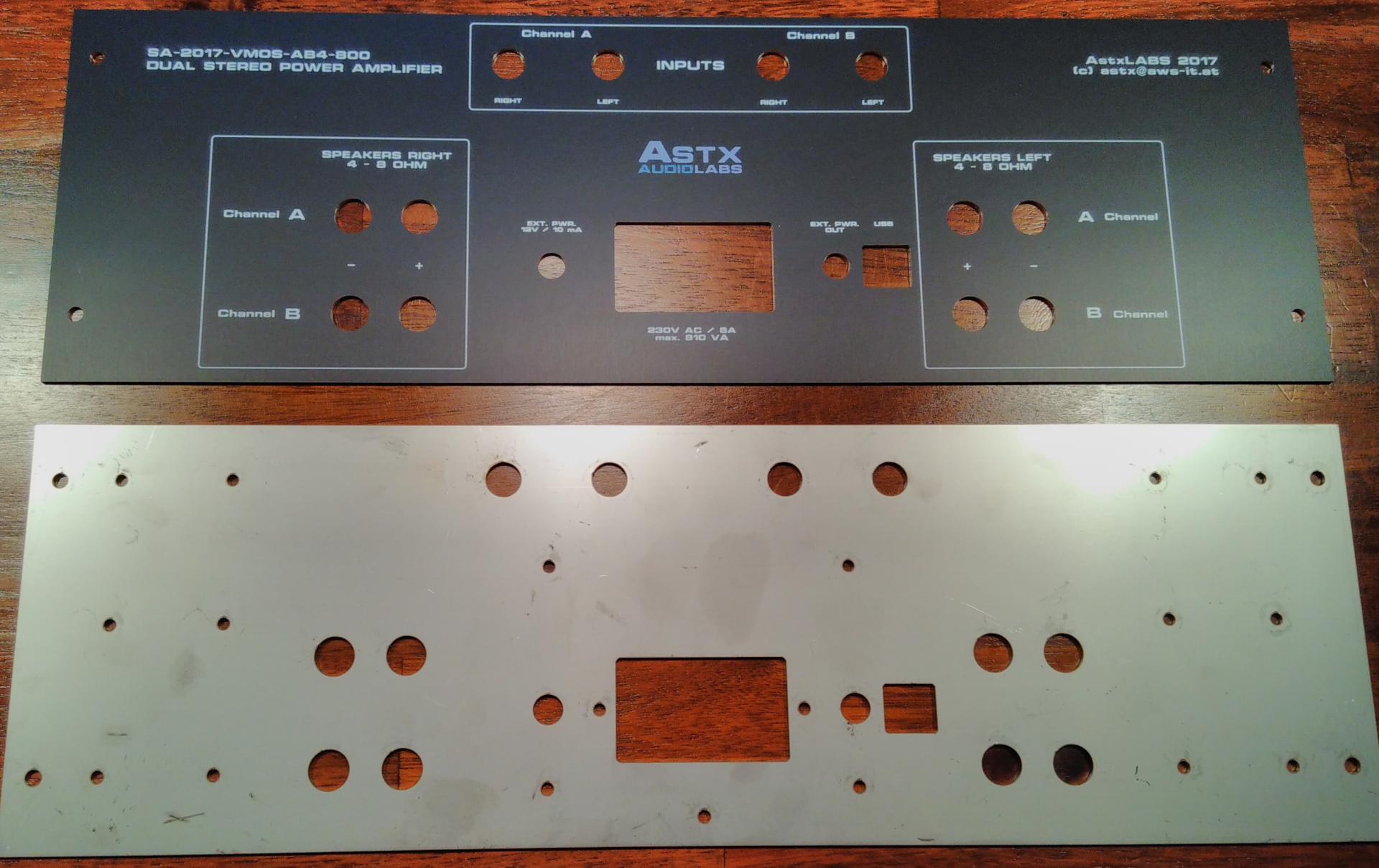

Nice. Why the stainless steel second layer?
The answer is in #2438.
Best regards!
Toni mentioned in an earlier post he preferred the double panel to conceal hardware. I mill my rear panels from 1/2" aluminum bar stock and use blind holes to do the same. The laser cut panels are a lot less work though.
Is the entire enclosure a custom build? I see you mentioned the heat sink and front panel mounting helpers are "universal". It wasn't clear to me that you meant they were purchased as is or designed by you and fabricated for you. I have spent a good while at times cursing the design and quality of Modu's case assembly fixings. Especially in a deeper enclosure where reaching the bottom and corner fixings is nearly impossible with anything installed inside the enclosure. I found myself resorting to J B Weld to bind nuts to their fixings so that the case could be assembled entirely from the outside and never did find a solution for the front panels.
Please show detailed pics of this as you proceed. Perhaps including a top down shot of the rear panel sandwich. I am intrigued how the outer layer will sit flush against the heat sinks given it appears from the photos that the inner layer is of the same dimensions.
Extraordinary attention to detail!
Many thx!
All parts are designed and (c) by me using qcad. Only the anodized front panel is original modu. All other parts are manufactured using my dxf files by different vendors:
The main reason to design a completely new case variant:
I don't like the top and back panels being mounted above or overlapped over the heatsinks.
BR, Toni
- heatsinks: cooltec.com
- heatsink cnc and anodizing: schaeffer-ag.de
- laser cutted stainless steel and iron parts: cutworks.com
- aluminium panels: schaeffer-ag.de
- powder coating for iron plates: wolfmair.at
BR, Toni

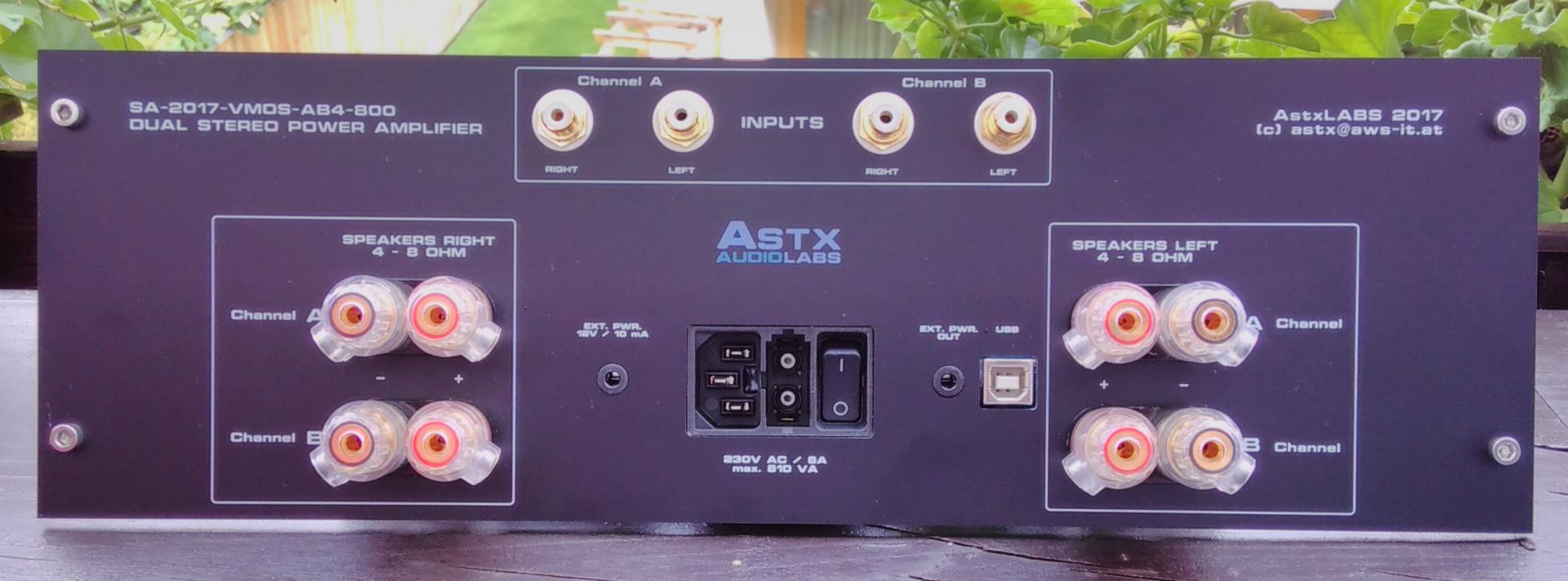

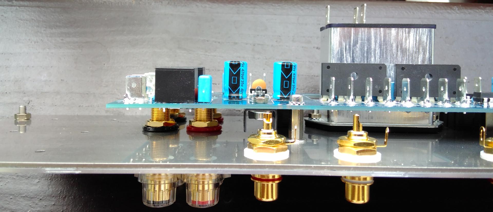

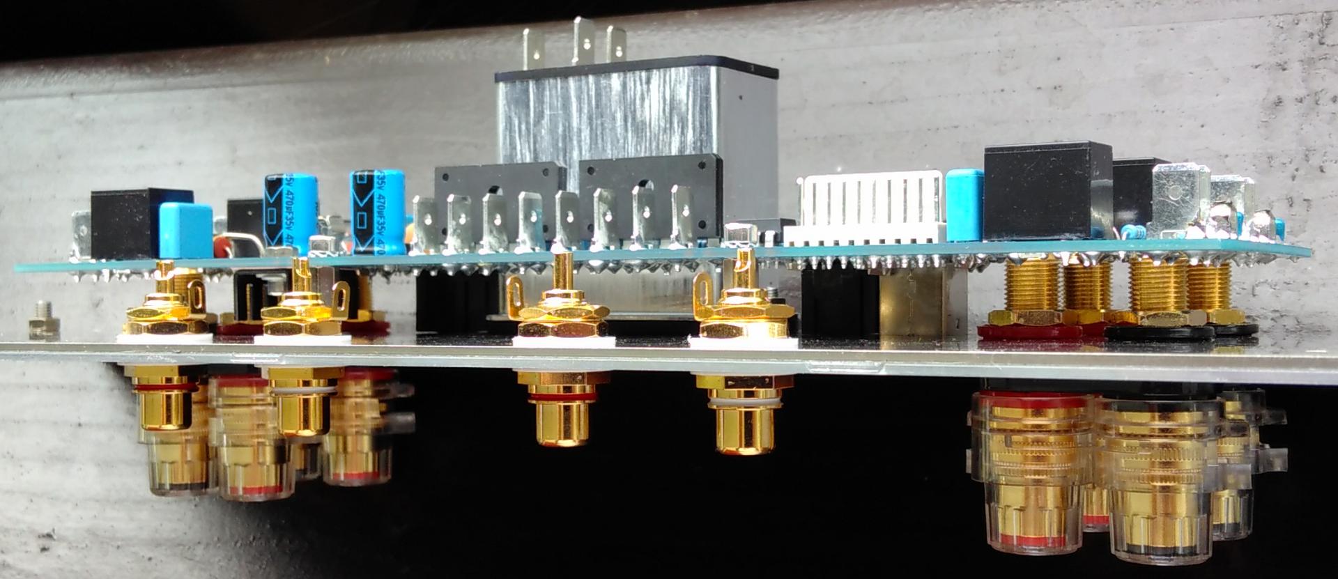

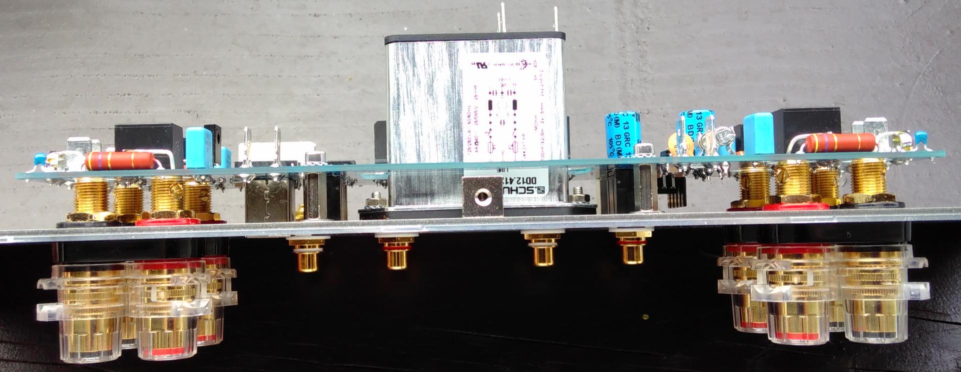

... more details from backpanel "sandwich" ...
Great work Toni!backpanel: higher resolution picture.
The dual back panel sandwich is a nice idea,especially when a lot of screws must be hidden.
Thx Jan and Thimios!
The backpanel "sandwich" is in sum 3mm thick and very stable. Of course you could do a 10 - 12mm thick aluminium backpanel and add blind holes to mount the parts. CNC milling the thick panel is more complex if you add those parts like I am using.(USB port; 3mm headphone socket; Schurter 230VAC EMI filter with fuses and switch ...) but of course would look also extremely professional.
The "sandwich" costs are moderat:
The 1.5mm aluminium backpanel cnc milled and printed in multicolor costs 80 EUR and the 1.5mm laser cutted stainless steel inner backpanel part costs about 30 EUR including shipping.
Have fun, Toni
