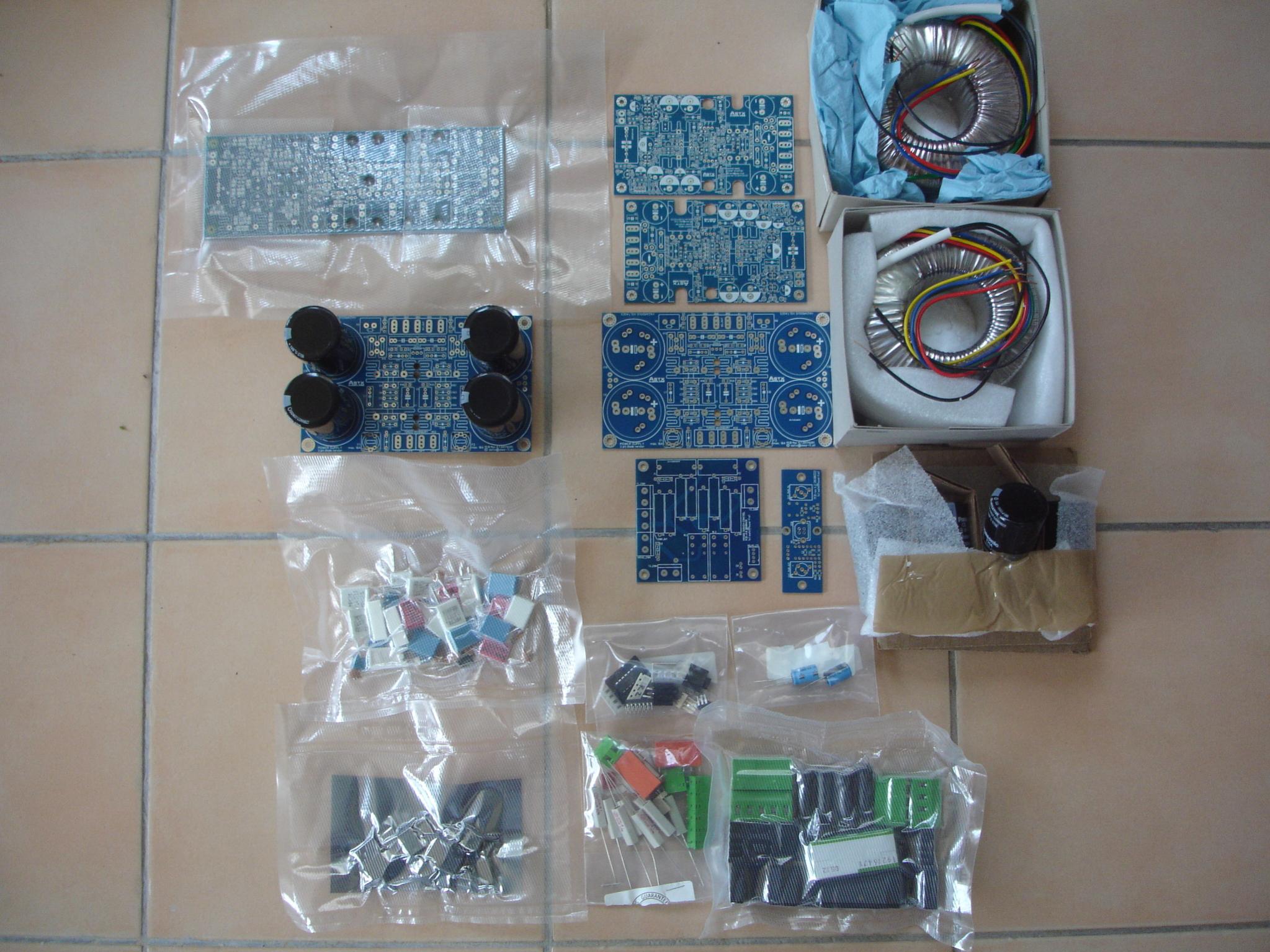

Just arrived
A lot of parts just arrived!:cheers:
Thanks!:wave2:
After a long period doing nothing,i'm busy again!
Waiting new boards for test and finalizing one amplifier at least...for now!
Not bad,not bad at all!

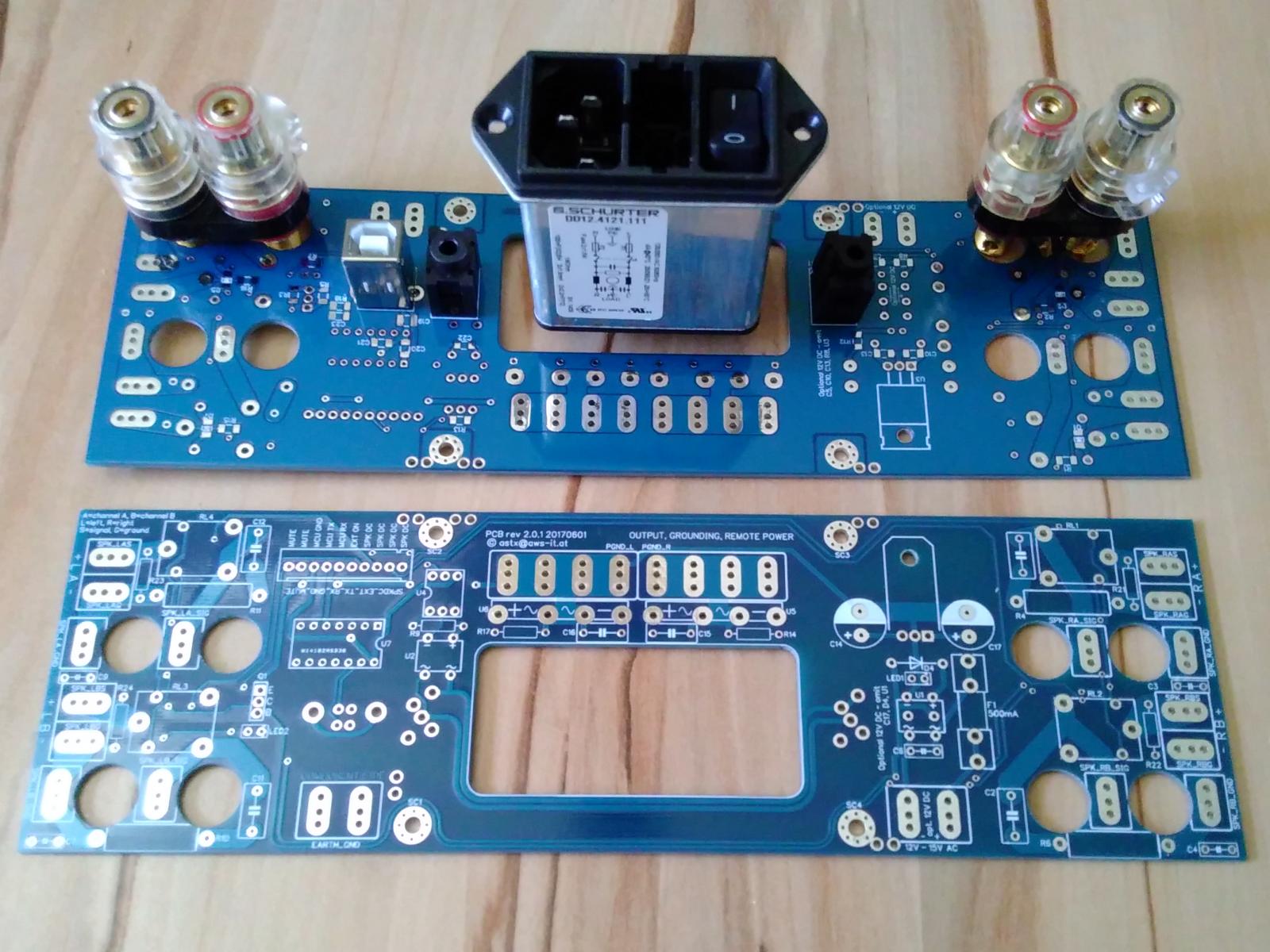

SA20XX 4 channel backplane ...
... got new pcbs for a reworked 2 - 4 channel backplane:
  • output zobel
  • dual ground loop breaker
  • dual star ground
  • speaker relay
  • galvanically isolated remote powering by 8 - 18V helper voltage
  • USB port to configure the MCU
  • 230x70mm
Needs external 12 - 15V DC or AC 150 - 300mA.
BR, Toni

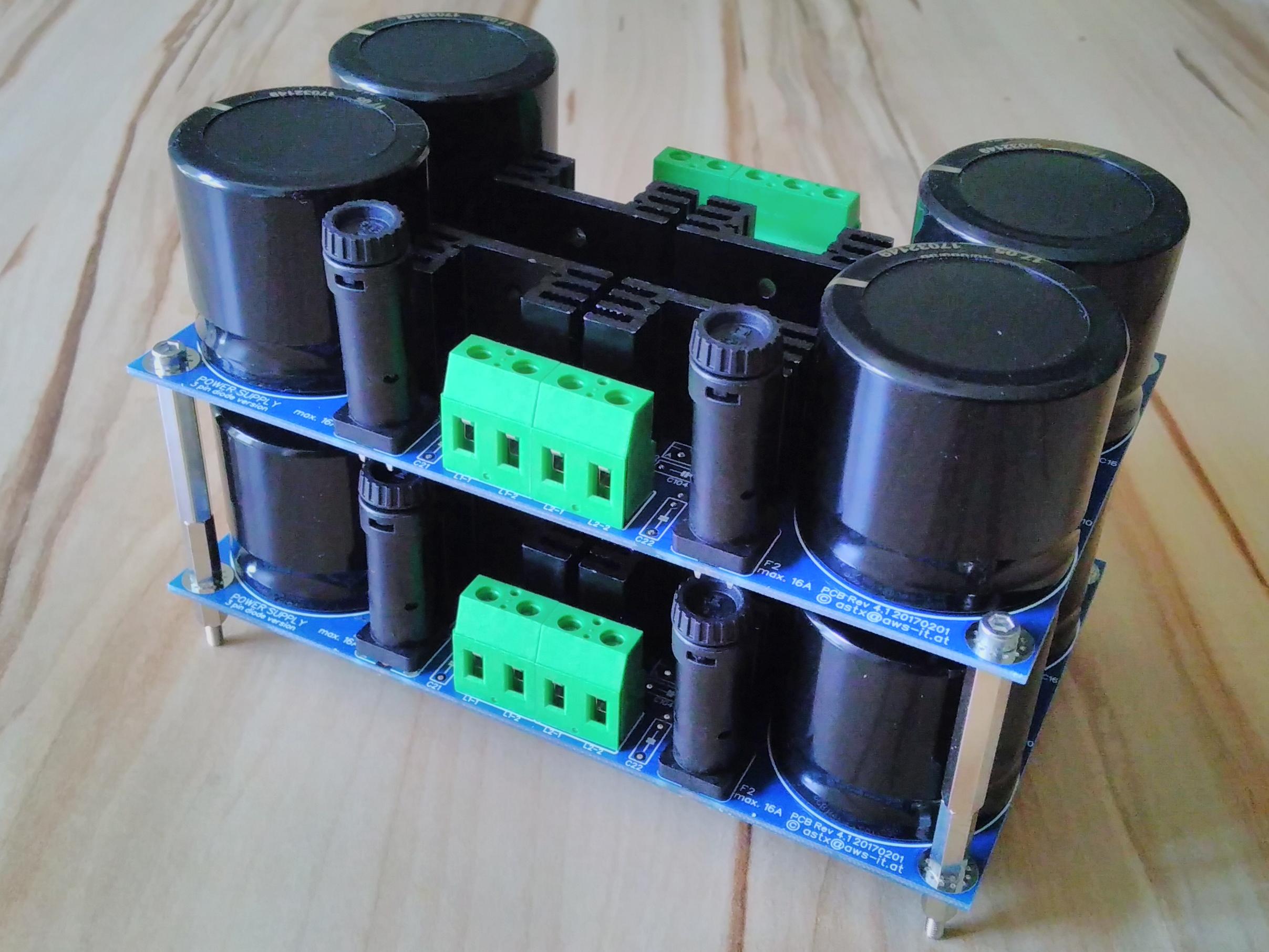

New "mains inrush control" pcb: I2C library ported to pic16f1829.
Prototype is working:
  • able to detect and feed data to LCD display
  • able to detect and read up to 8 additional LM75 temperature sensors
  • WIP for MCP23008 and MCP23016 port expanders
BR, Toni

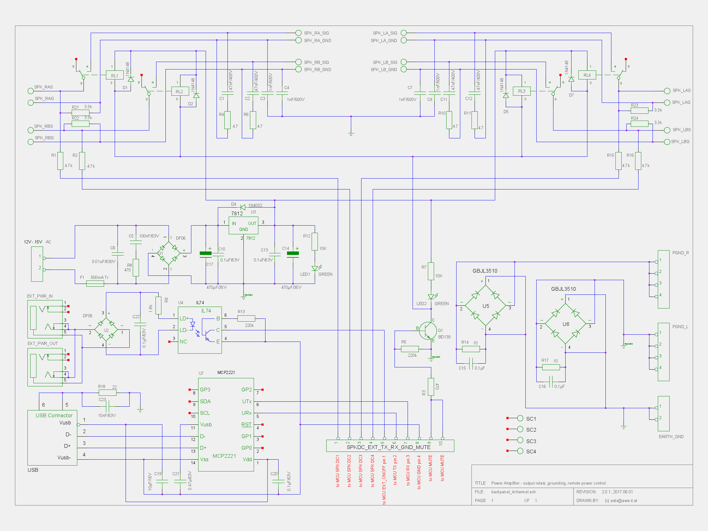

The new backplane for up to 4 speaker channels.
Note: Schematics are free to use only for non commercial DIY projects.
WARNING: I am not responsible for any costs, damage and/or injury using these schematics. Do not use this schematics if you do not have the necessary experience and knowledge.
  • backplane_4channel_schematic.pdf

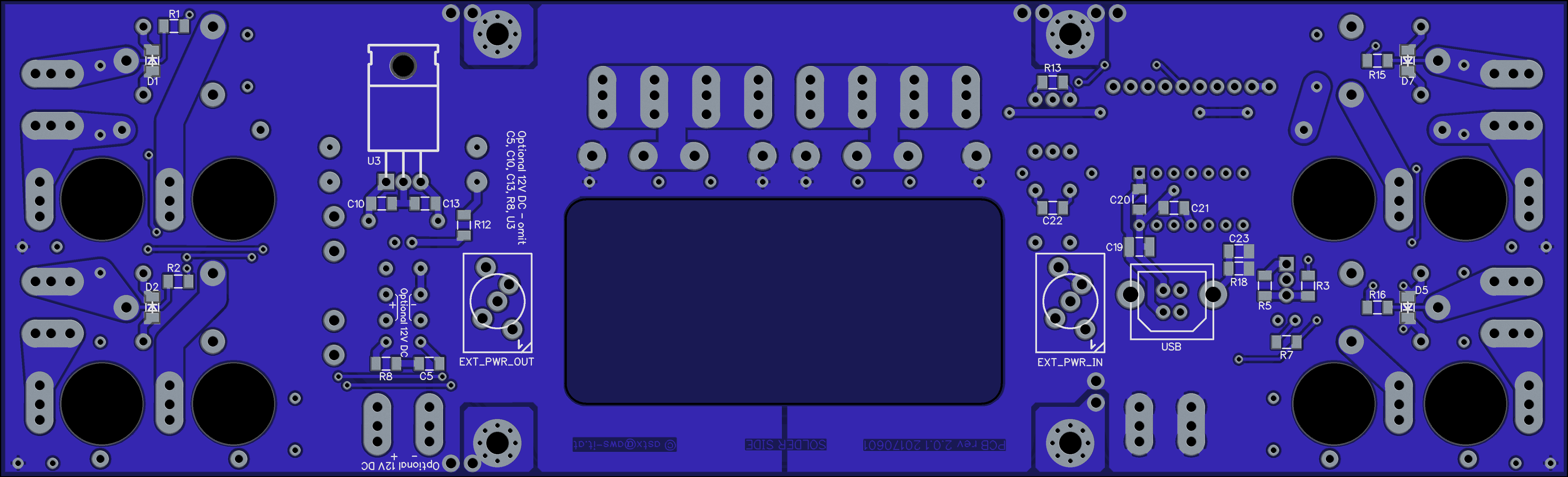

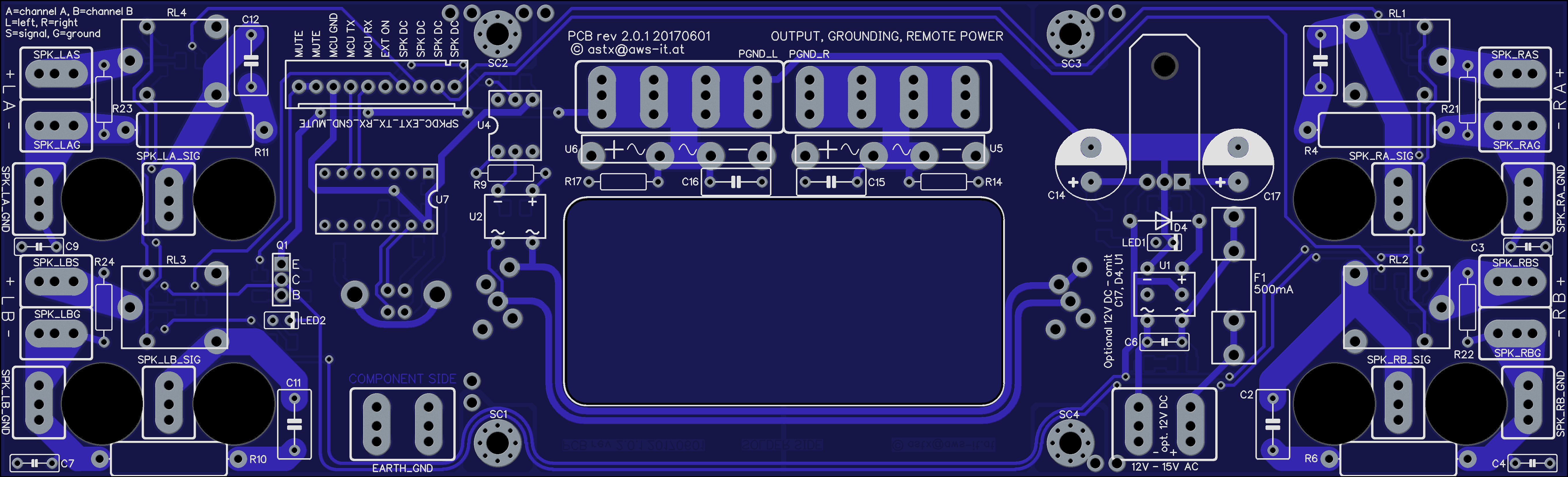

Joined 2011
Note: Gerbers are free to use only for non commercial DIY projects.
  • backplane_4channel_pcb.pdf
  • backplane_4channel_pcb.zip
