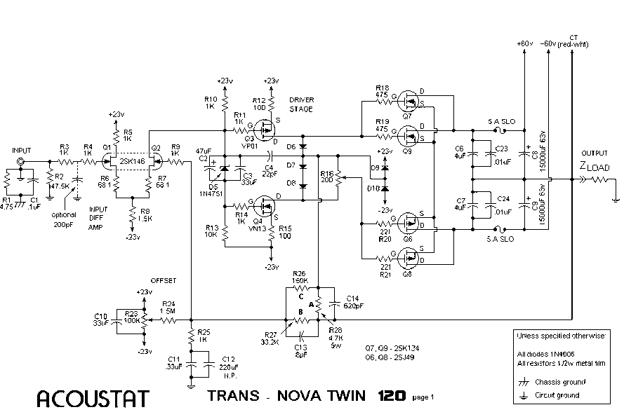

Jim Strickland's various Amplifiers with either 2SK135/2SJ50 series or the electrically essentially identical 2SK1058/2SJ162. Starting with the Acoustat TNT-120 and TNT-200 and the later Hafler Pro Amp's. I am attaching the TNT-120 for fun. Others can be found on-line.
Ciao T

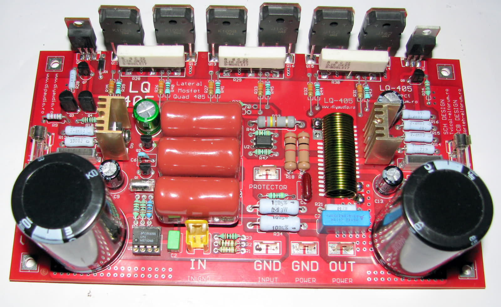

...... I have new reborn QUAD 405 with 2 SK 1058 and 2 SJ 162 and schematic diagram ....
Alex
