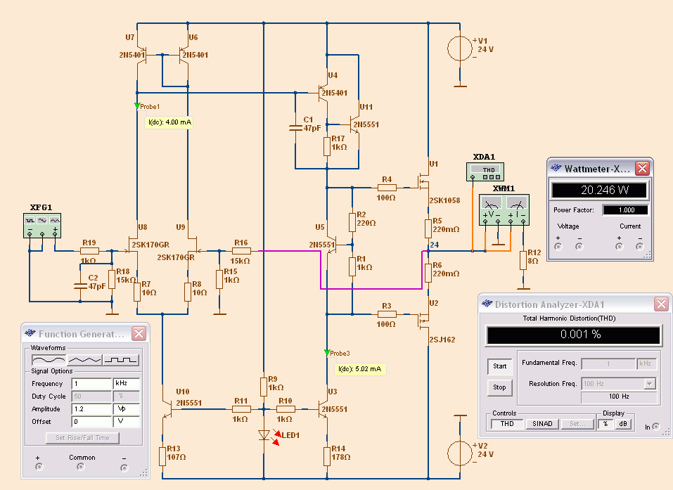

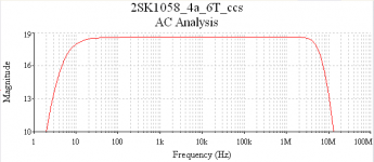

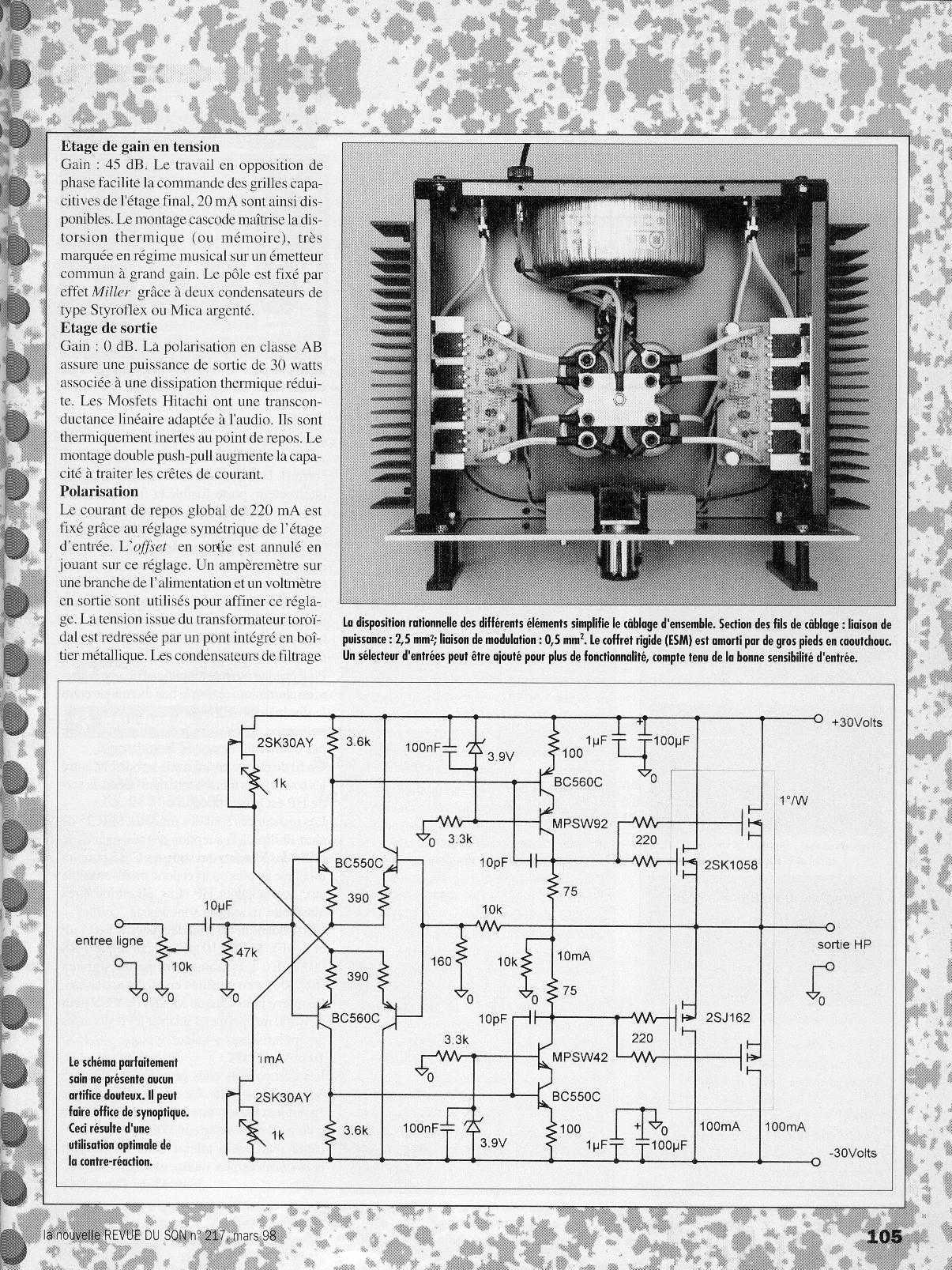

The first amplifier that crosses my mind is MJ Amp, that also uses 2sk1058 and 2sj162 pair.
That amazing amp is very hard to construct because its Class A and needs very good care to tune , i did some prototypes by burning out many parts of output transistor It must be about 30w, but for sure no one would be regret to do that amazing amplifier , it has very warm and natural sound as a Class A.
Here is the real schema and i also attached the one that i tried to improve over 30w.
