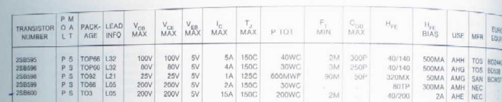

Here's another one, worst investment i made in the late 1980s.
A lot of the data in it is untrue, i prefer datasheets.
