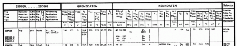

According to all available sources I have: CDrom and ECA book the manufacturer was Nippon Electric Co., Ltd. (NEC).
Here's all available data I have.
/Hugo :)

It looks like these have a beta code as well, thought they might. Thanks for the input Netlist! Now I know to have a heads up when buying sight unseen. Seems this transistor has some history to it and it might be easier to just stick with the Motorolas, which makes me all that much more curious about the NECs!

Hugo,
That's a great data book! Way more information than I have. I wish I could read German!
Jacco,
I get mixed up on the brands all the time. So I look at an original to figure it out. I still wish the Japanese book was written in English. There is so much more information in the book. I can figure out the numbers and headings but the text is beyond me.
-Chris

anatech said:
Hugo,
Chris,
One can't have everything, knowledge and data. That's where we complement. ;)
In fact, when you look carefully, the small text is written in English as well. All other data is quite universal EE-jargon. Too bad me and my scanner did a rather sloppy job.
As far as my German goes, Grenzdaten would be 'Absolute max. ratings' and Kenndaten would be 'Typical ratings'. Any German speaking member correct me if needed.
-=Hugo=-
