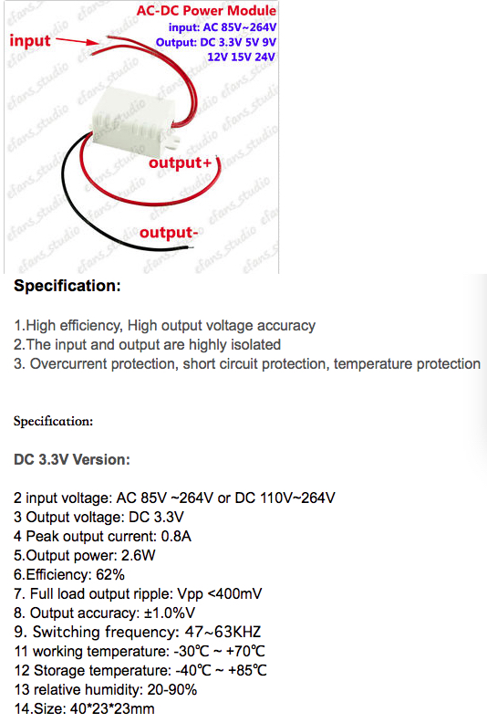

Since the filament current is 150% higher for the 2P29L I decided to try a cheap ($3.55) AC-DC regulated switch mode supply. The output is 3.3 vdc and I'm using a 10 ohm resistor to drop it to 2.1v.
From what I've read, I wouldn't be surprised if this filament supply didn't look too good on a scope. I don't have a scope, all I have is my ears.
I started with batteries, then went to battery in one channel and the AC-DC in the other, then both to the AC-DC. I couldn't hear any difference at all. Not saying there isn't any but it wasn't audible to me.
I added a 6800 uF 6.3v cap after the 10 ohm resistor to see if some filtering would be noticeable. I haven't listened to it with the cap much yet. I'll A-B it next week and see if I hear any difference but I figure it can't hurt whether it's audible or not.

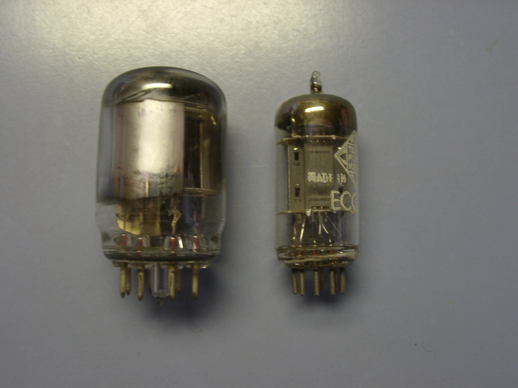

I'm not sure if anyone has posted this elsewhere but here's what the 2P29L looks like without the shield. Pictured next to a 12AX7 for perspective.
Oooo stubbies!

Consider discard the solid state transformer, surely it will generate lots of electrical noise and surely in few time it will explode. They had made with very low quality materials.
Switch mode supplies seem to have both supporters and detractors. I was skeptical but I thought I'd give them a try.
As I said, I don't have a scope so I don't know how much electrical noise they are generating.
I know I did not find any audible difference between them and using a battery on the filaments. Frankly, that surprised me.
I added the 6800 uF 6.3v cap just on principle and left it in even though, once again, I heard no difference. I figure it can't hurt. If noise is being radiated they are so small that they could easily be shielded.
As for their longevity, I guess I'll find out. I'd be more concerned if they were operating near their limits. But since they are rated (maybe legitimately, maybe not) at a maximum of 800 mA and the filament only draws around 122 mA, I'm willing to give them a try. Time will tell.

IMHO. He doesn't need to be undressed. Aluminum shirt performs the function of electrostatic screen.

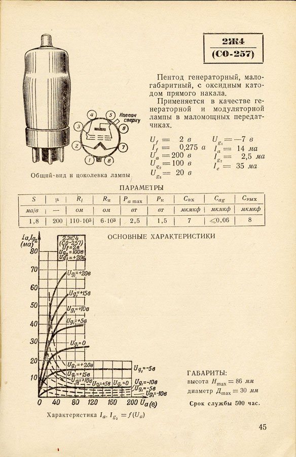

Daddy 2P29L is ancient SO257 tube

No. After WW-II German engineers re-designed for Red Army some Telefunken tubes that were designed and manufactured for Wermacht, to use in a mobile equipment. They were re-packaged in Loctal envelopes copied from US tubes. The exception was LS-50 tube that did not fit into an Loctal envelope.
electron Tube Data sheets - Wehrmacht Röhren
You can open both and compare.
Unfortunately, I am very sorry to open them.
But I will definitely clarify this issue.
https://frank.pocnet.net/sheets/043/r/RL2.4P2.pdf is the prototype.
SO-257 that had been later renamed to 2Ж4 was one of most popular pre-WWII tubes, particularly used in РБМ transceivers.

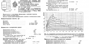

Look better, compare shapes of curves on the same voltages and currents, instead of looking at them ignoring different scales on the pictures.
Yes, new tubes were designed to replace old ones in new equipment. Like 6N1P was designed to replace 6N8S and 6N2P was designed to replace 6N9S, but nobody call them "Prototypes". SO-257 were very popular on Russian forum, most probably being advertised by A.M. Likhnitsky, so in order to promote 2P29L some authors compare them to SO-257 instead of original German prototypes that nobody knows.
Once again, German engineers were tasked to repackage German tubes for Soviet army; it would be weird to assume that they were tasked to repackage one Soviet copy of American tubes instead. Later Soviet engineers designed Gu-15 in Gu-50 envelope, but it was a total failure. It was not a German quality...

I've translated the graphs to about the same scale. Curves within the deviation of the parameters of two tubes of the same type.
