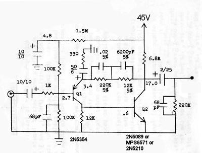

Here's the old Ace circuit:
I changed my output cap to 10uF/50V, the 6.8K to 12K and the 12K to 10K, probably for the zero distortion mod. Their addendum listed a couple of other changes as well.

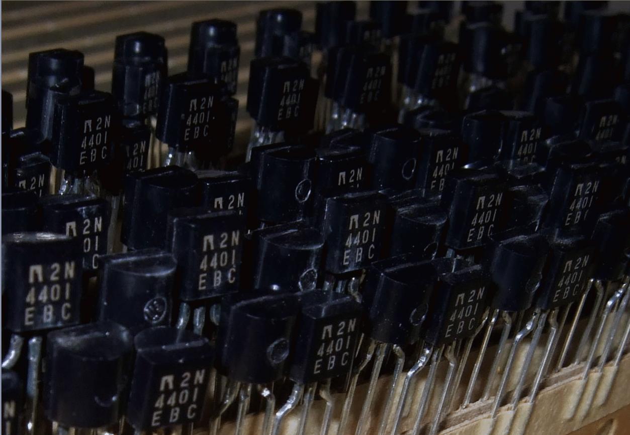

I grew up with the 2N2222A. It was my passion, my go to friend when I needed to design a circuit quickly and cleanly. With the 2N2907, not the 2N2907A. I found it unstoppable. The clean wave forms, the thousands of circuits, chopper, switches, audio amplifiers, and rf amplifiers.
I became addicted to the 2N2222A and 2N2907. Any US military servicemen, who served between 1959 to 1977. Came across countless 2N2222A circuits and equipment designed by me and my fellow workers.
There have been many good transistors, like the 2N2222A's close cousin the 2N4401. But still the 2N2222A out performs it.

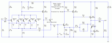

Got them for general purpose low noise enough use because its a competent classic BJT for almost no money. Got its 2N4403 PNP brother too. I have in mind to remake a classic British 70's BJT MC stage just for the sake of it, because I had made the MM version one when I was a teenager and gifted it away later on, so I remembered it and want to re evaluate, but with many crucial changes I thought of. I think that those transistors will show the trend in its head amp and I will not have to spare my few 2SC2545E on such fun tests, which would be overkill. Don't know if it will need changes in practice, but this is the theme I have in mind.
Ivey,
don't get me wrong - I love the good old 2N2222 and use them all the time mostly in the switching capacity as I mostly do digital design.
However there appear to be a range of transistors that are very good for audio work. For example the BC550. High VCE and low noise. (2.5 dB with 2K source). If you don't like high gain, don't use the "C" part :)
And the BC109 was used in a lot of low level audio circuits like the tape pre-amps where the noise really counts. Sure it has a low VCE (20V) but for the input stage it shouldn't be a problem. I didn't simulate your circuit but it looks like the collector of Q2 should be at about 10V DC.
