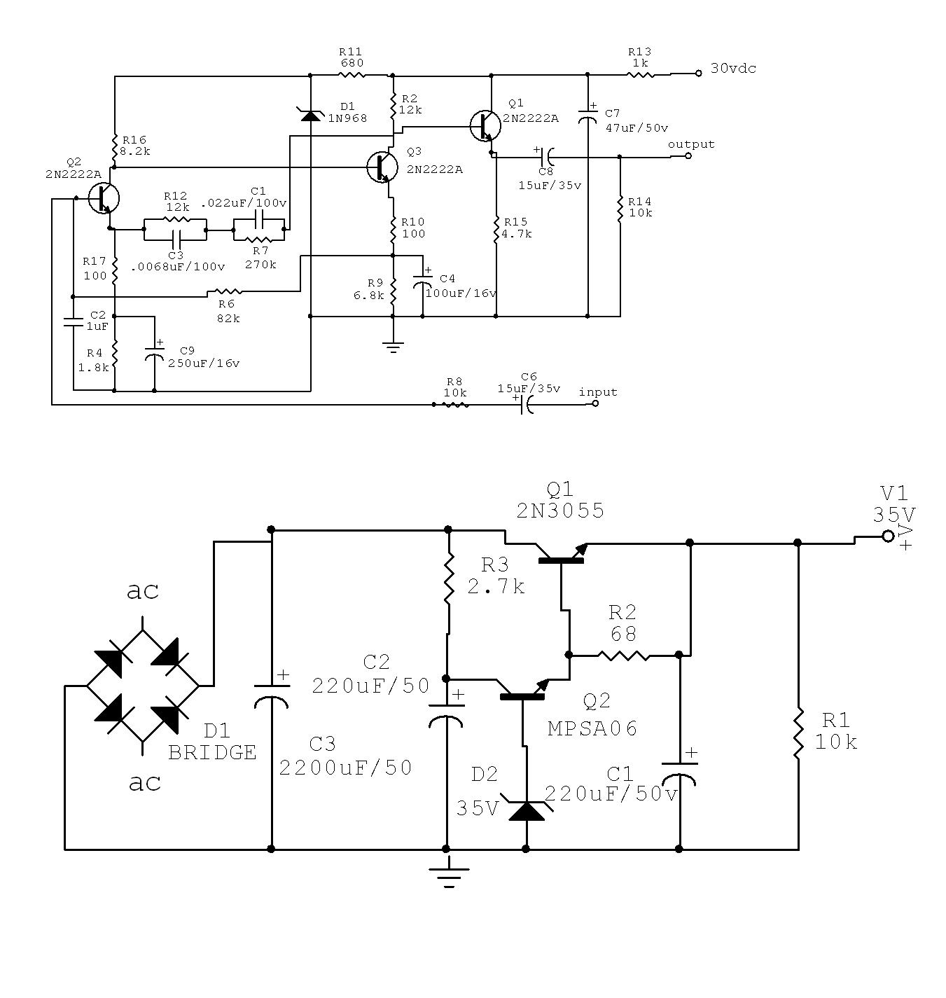

I am posting the drawing of the phono preamp.
But remember. Everyone.
This is a simple phono preamp. It was designed in the early 1960's. To us back then, it was something new. We kept it simple and clean.
I post this preamp not to show how smart we were. But to give people a look see as to how far we have come, from those early today in transistor technology.
Keeping it simple, is a very important issue. Us older guys remember when working on our chevys and fords was a pleasure. Because they were so simple to care for. Not like today, where you need a computer to assist you..., in telling you the door is open.
This is blast from the past. Showing that with a hand full of parts, that you can get at your local Radio Shack today. You can put a phone preamp together without pulling your hair out or wondering what all those blasted transistors are for. And do it for about $10.00 dollars.
To comment about the P-59. It was at Edwards AirBase, Calif. It flew and handled like a stone. Lockheed was given 6 to 10 months to come up with a better working design and plane. The engine that the Brits gave us was under powered and the P-59 was too heavy.
So they dropped the weight and trimmed it down and out came the P-80.
A better solution to a bad problem.
These drawing are uploaded as doc. But you first download the file. Put CircuitMaker 2000 extentions on the file. And open it up in CircuitMaker 2000. The pcb file is layout as an exploded view to let new comer to pcb layout get an idea as to how to began. But in truth, you can do as you wish.
Take Care
Ivey

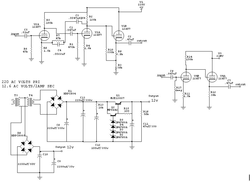

The Moderator is Correct
To all, I must say that I did it again. I screwed up the upload to the drawing. But I managed to work it out. I am re-posting the complete drawing.
The Phono Preamp and the LineAmp are mere simple circuits. They are not for the purpose of dazzling people with my skills or knowledge.
They are to provide a stepping stone for those who want to try out something new, different, and inexpensive. As a building block per say.
Most parts are easy to obtain, from Radio Shack, Mouser, and local Hamfest markets. With luck, it could be built (a stereo unit) for about $25.00 dollars.
You can use 120 volt transformers with a voltage doubler, for the HV.
The MJE13007, can be replaced with even another MPSA42 with a heatsink.
It may run warm. But it is a hobby. Burn it up. Start all over again.
Take Care.
Ivey

Analog_sa
Thank You; I was wondering about your comment, yet when I went back to check, I had input the wrong value for R6.
R6 value is 82k, not 1k ohms
I was trying to get it out quickly and over looked the feedback RIAA correction resistor value.
I am posting the new drawing with the correction
Take Care
Ivey
  • phono cor.doc

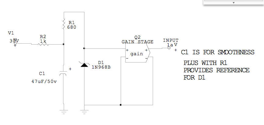

Bypass Cap.
At the time of operational testing, it showed that it was not required. In the early days of LP cartridges, some outputs ran high and others low. And the impedance on other were not so good.
But yes, you could bypass it. Yet the 680 ohm and the 47uf/50 does double duty for you in that area.
Check it out please.
I will dia. it for you stand by.
Take Care.
Ivey

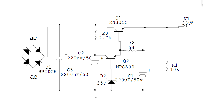

I have a good PSU for the 2N2222A
Allow me a few minutes to draw it up and I'll post it.
But here the scoop on it.
This circuit is good for low voltage and high current with very low ripple.
You can get everything you need at your local Mall Radio Shack.
I came across this circuit when I was building Class A's. It turned out to be pretty good. No dips when heavy current is called for.
This circuit may be used where high current is required, with a low ripple. The value of C2 smoothness , is about 48,000uf, base on the gain of Q1 and Q2 in their Darlington setting..
Take Care
Ivey

Mr MLLoyd1
No Sir, the 82k provides base bias for Q2, throught the feedback loop. The 680 ohm resistor, 1k resistor, the 47uf/50 provides reference for the zener.
the zener is used to provide reference to Q2's gain section, because you have two feedback loops to that section. The RIAA and the negative feedback loop of the 82k resistor.
If the reference voltage is lost, the unit could go into oscillation. When current demands are present.
I have played the phono amp without the zener, and it sounds muddy. With it, it is sweet and warm for a ss unit.
Take Care
Ivey
If i understood correctly, i should use the power supply on the picture and that phono stage and that's it? It's writen that power supply output voltage is 35 VDC. But input voltage for phono is 30 VDC. What kind of transformator to use? Secondary winding of transformer should have 24 V probably? How strong transformer to use?
greetings
