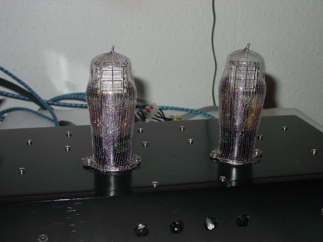

Hello
It is my fist participation in this forum.
Please look my 26 preamplifier. It is not ready now but sound like an angel and have zero noise and very low microphony.
In Filament i use Tentlabs modules made to 26.
Plate choke + 200H installed inside chassis
Output cap Mundorf silver supreme
Vintage Amphenol UX sockets decoupled from chassis
All Aluminum chassis
Separated power supply tube rectifier and tube regulated
Separated power transformers for Tentlabs
Shield wire in input
Fixed bias with 9V battery
For last and for me the most important thing i made in this project is shield the tubes (see picture)
