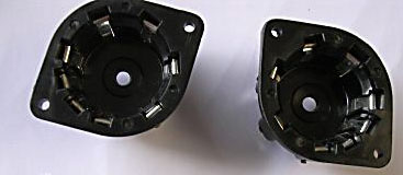

*There are 8 pin P-Sockets available for AZ1 if someone wants to utilize this sweet, open tone rectifier in a new DIY project. They cost about 3.5 EUR per piece.
I would be open to trying an AZ1 if you would like to find me one at a reasonable price and point me toward a supplier for the P-socket.
