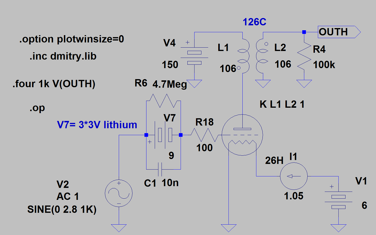

No need whatsoever for a input-capacitor if using the topology T.Loesch showed me.

This looks a bit foreign to my simple eyes. I can see -9v bias, but where does this go to ground? In the 100K pot that would precede this? Where is the input resistor, grid to ground?
Also, with 150v on the anode, 9v bias would give you over 7mA which is a bit strong isn't it?
Can you explain the circuit for my help!
Andy
Andy

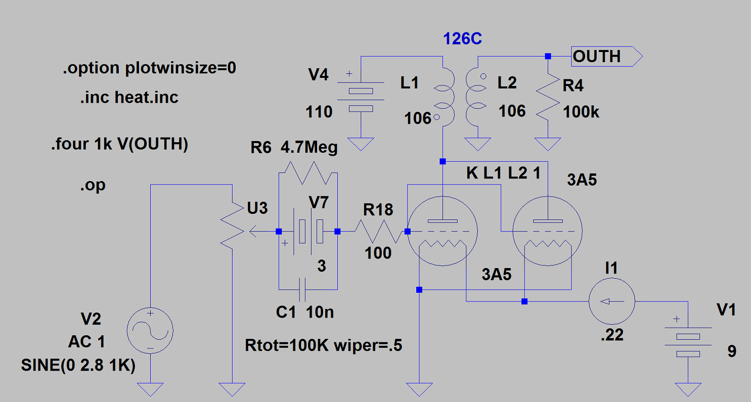

Hey Andy,
This was only done to show the principle of how it could be done. You are free to use whatever Ia or Ua you like. The only problem is that we can´t choose battery voltage so easy as the Lithiums are 3V.
As there is no grid current we can skip the cap.
Didn´t add the gridleak resistor as I thought it was so obvious it should be there. But it could also be the 100k pot you mentioned.
Below is how a 3A5 could be done. But I would go for a 4:1 on that one.
Just remembered that T recommended Silvermica for the 10n.
Certainly not original to Thorsten, I and others in my immediate audio circle experimented with this as long as 10yrs ago and I found the sound not to my liking, by the time it was the battery bypass cap was of comparable size and quality to what I would have stuck in there in the first place with conventional grid bias, and the problem gets worse the higher the bias voltage required. The sound quality seems to be very dependent on the electrical characteristics/internal construction of the battery chosen, and with the 26 an effective bias depending on plate voltage (6mA) varies from -8 to - 10V and multiple cells in series seem to compound the problem.
I experimented with fixed bias using NiMH and NiCad batteries in the cathode circuit and found this sonically inferior to LED bias in most if not all cases. (I use LED bias, but no batteries currently in sight.) The Sanyo Cadnica batteries seem to have the lowest internal impedance of the batteries I tried and sounded pretty good compared to anything else I tried, but a simple LED trumped them too.. IMO..
Again my comments are preference/experience driven, I think at some point everyone should just do these sorts experiments and decide for themselves. A really good battery (varta?/Sanyo) should make a significant difference in outcome. IF nothing else the learning experience is FUN!
