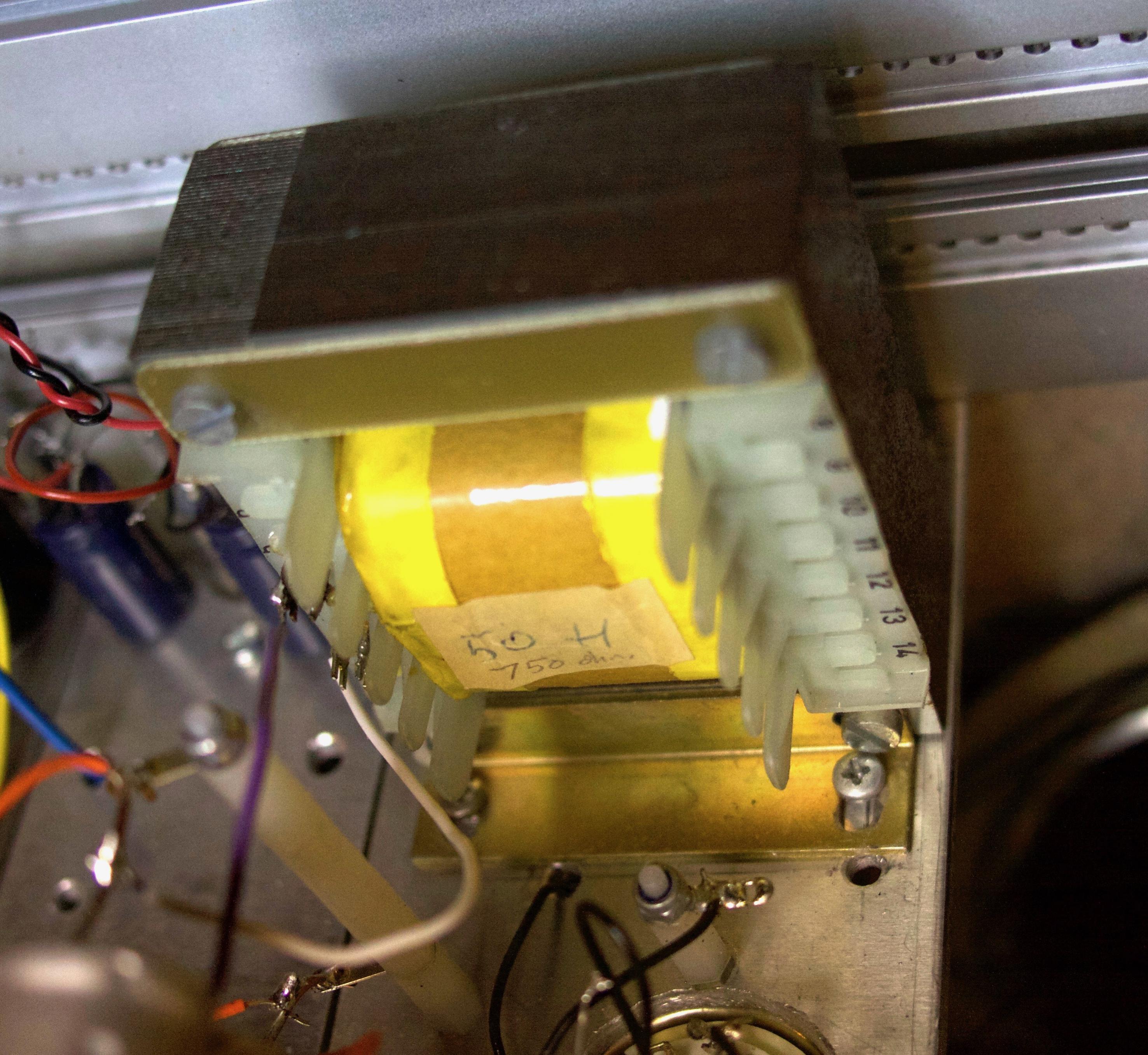

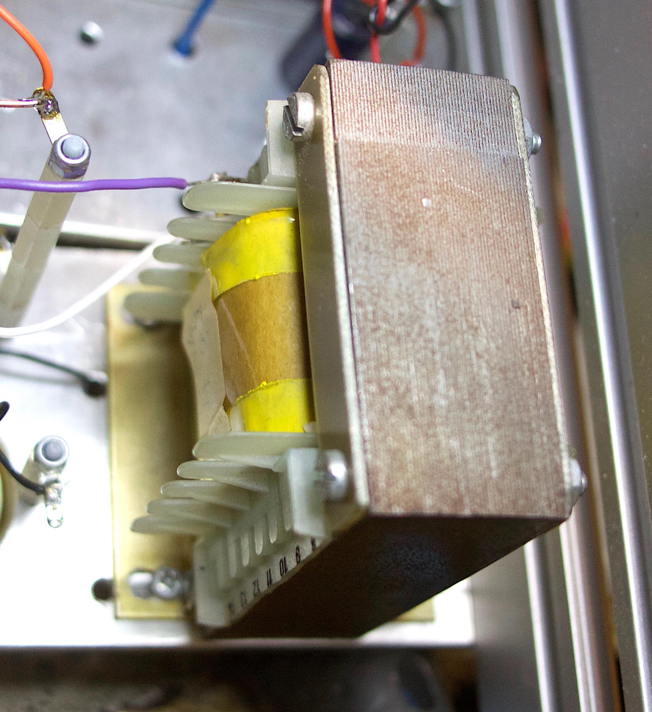

However, I just tested out a different plate choke with the 2P29L and that's as good as the 10Y with two 126C, maybe even a tiny touch better. So next is to try it with 10Y and see what that gives. There's no markings on it so I don't know the value, make or anything. I'll see if I can take a photo.
This would no doubt be the same for the 26 so that's an idea for a plate choke. I previously just tested the 26 with a single 126C but I'd expect the same gains with two in series.
My other plate choke is marked 750R and 50H - sounds great with a 2P29L (Ra 3K) but a little flatter with a 10Y, it doesn't sound quite comfortable with its higher Ra of 5K-ish.
I'd like to know who made this plate choke - looks quite generic but maybe someone knows. I think I got it off Thorsten Loach around 10 years ago. Measures 80x65x55mm
