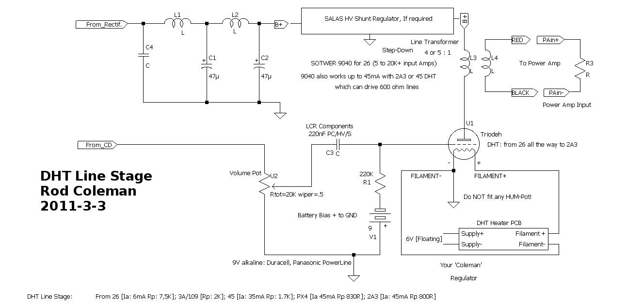

Thanks I see in the attached Rod Coleman schematic, but I want to know about subjective opinion of SQ?
Joined 2004
Which 1660 (core type: conventional or amorphous), which connection (Alt Q, or S or T). etc...etc.
#26 plate resistance is typical 7k3..7k6 (mean 7k5), so load will be greater than (2x) 15kOhm -better (4x) 30k -.
Z=2*pi*f*L (for the sake of simplicity DCR is omitted)
At 20Hz:
15kOhm= 2*pi*20Hz*L
L:119H
If you want lower output impedance of OPT based line, must use step down transformer, for example Alt Q wired 1660 (4.5:1).
Alt Q connected 1660 inductance only 100H, and recommended source impedance lower than 3k!
Alt S connection (4:4.5) has 130H inductance and source impedance is lower than 14k....but line amplifier output impedance will be greater than in step down case!
No free lunch....
