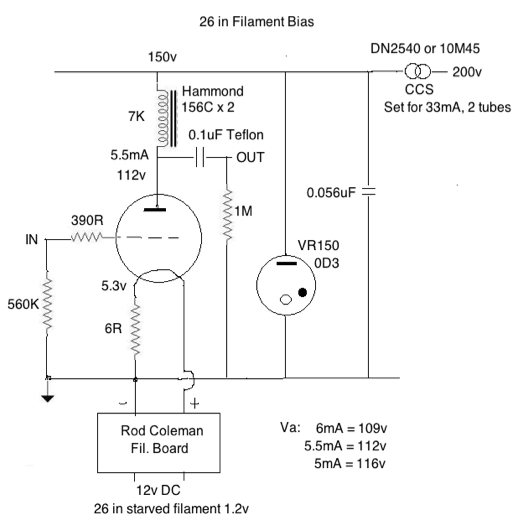

Hey all, I've been chatting with Rod a little bit about going with a filament bias config with a pair of his regulators, for a pair of #26 tubes that I plan to use.
I've got a few questions that I'm hoping someone can help me with..
Firstly, I'm thinking about bias point. I have a power transformer with 2 x 10VAC / 4A secondary windings.. This pretty much limits me to a max of about 12.3V for the raw DC supplies.
PSUD2 Sim:
The Coleman v7 reg needs 3 - 3.5V of headroom.. So with an ideal amount of headroom (3.5V) that puts my max regulated DC capacity at about 8.8V.
Because I want to go filament biased, and I need 1.5V for the filaments of the 26 tubes, about the highest I could bias the 26 tubes is 7.3V.
So my question is about bias point ultimately.. If I chose a bias point of -7V, and current of 5mA, is this a suitable bias point? I know a lot of people seem to like the -9V point, but I'd really like to use this power transformer I already have.
The absolute hottest signal that any of my sources could output is 2.0Vrms, which equates to 5.66Vpeak-peak, or 2.83Vpeak.. So I wouldn't ever get into a situation where I'm swinging the grid anywhere near 0.
Here's a schematic of what I'm proposing:
I'm setting current with a 10M90S IXYS CCS anode load.. So I can set it for 5mA, and that puts anode voltage around ~112V or so.
Any help is appreciated!

If it is 10V 4A you can use a doubler to get about 25V, and free to use any point you'd like...
Wouldn't that push my power transformer a bit too far? With a bridge rec, I'm running at 2.4A Irms on the transformer already, and I want to leave a bit of margin..
Yea.. just did a PSUD sim with a doubler, and it looks like the RMS current on the transformer would be 4.6A.. Too high.

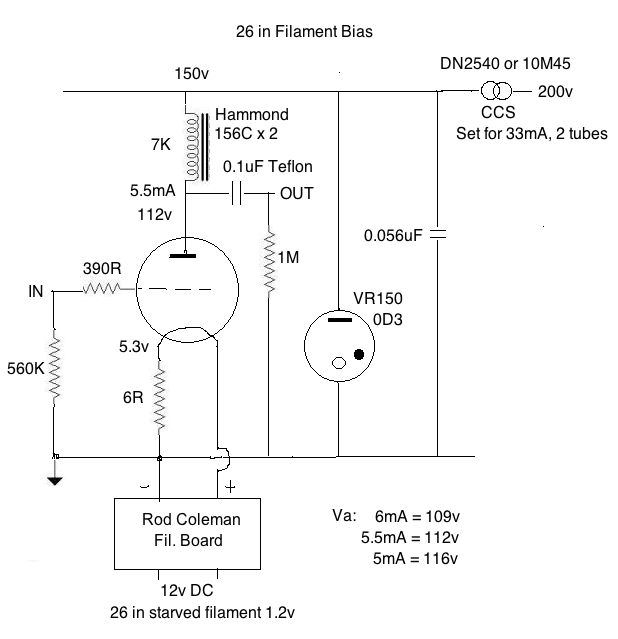

To me the -7 point seems perfectly fine, but I wanted to see if any others have run at this point, and see if there's some reason that I wouldn't want to do that..
Try it and see. I got good results with a 12v DC supply. This was my first 26 preamp way back around 2010. I don't see a problem. In those days Rod's regs needed about 6.5v headroom, so you have more flexibility.
So you were running at -5.3V.. How did you like that?
Also, I'm intrigued by this starved filament.. What benefits does that offer?
Just did some research.. Looks like lower THD.. So might be worth running them at 1.2V it looks like.. I'll play around with that.. Part of me wonders if getting a big beefy 20W rheostat or something like that would be worth it.. Just to make testing easier. (Though they seem to be pretty expensive with power ratings that high..)
With Filament Bias, I would try to choose the Bias Resistor like this:
- calculate the highest value that you might need, which will be with a starved filament:
say, 7V ÷ 0.8A = 8.75 Ω
5x 47Ω parallel gives 9.4Ω, so that would be an easy-to-buy starting point.
7V bias burns about 5.6W like this, so you could use Welwyn W22 (7W per resistor).
Adding a 100Ω resistor in parallel drops the resistance to 8.6Ω, which is near to your target; and adding another 100Ω in parallel gives 7.9Ω.
Or, you can swap one of the 47Ω Rs for a 100Ω part, to get a slightly higher value.
