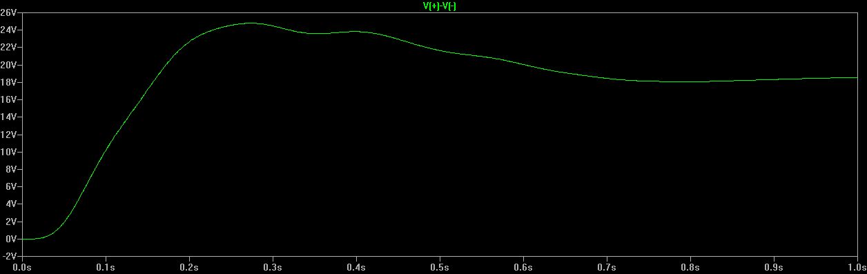

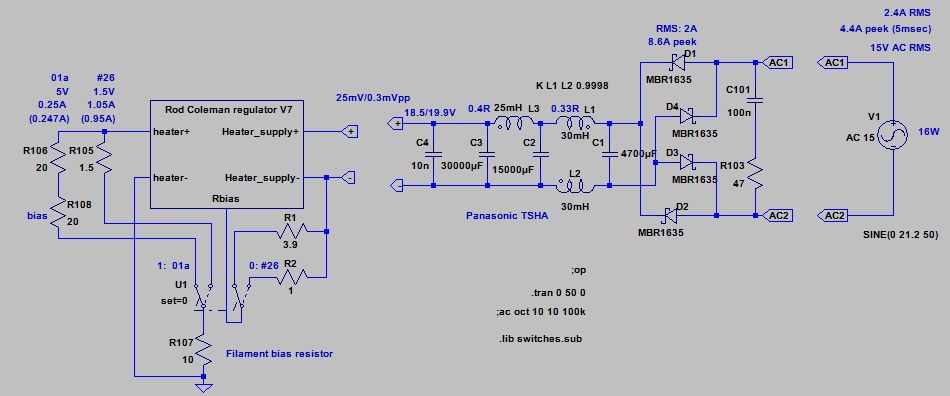

My question was actually prompted by noticing the raw filament voltage peaking at 24V before settling to 16V. If I opted for soft start in the PSUD2 simulation, it only peaked by about 1V. I wondered if that was a realistic sim, and if so would it be bad for the Coleman regs? I had a look at the regulator notes, but couldn't see an answer. Or if it's there, I couldn't understand it. :dunno:
It's no problem, if you use 35V supply capacitors.
As you can see in my simulation, if the filament is conducting (in the case of small DHT tubes it is 10-20 sec), the hump is about 500ms wide.

Phew! That's a relief. :) I hoped that might be the case, but it was worth checking.
