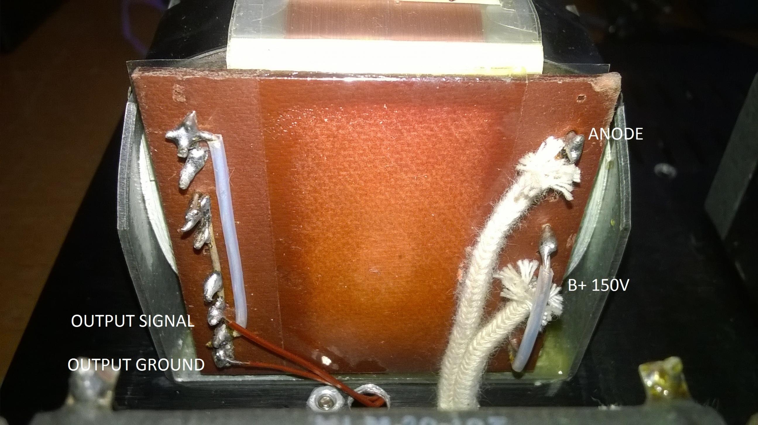

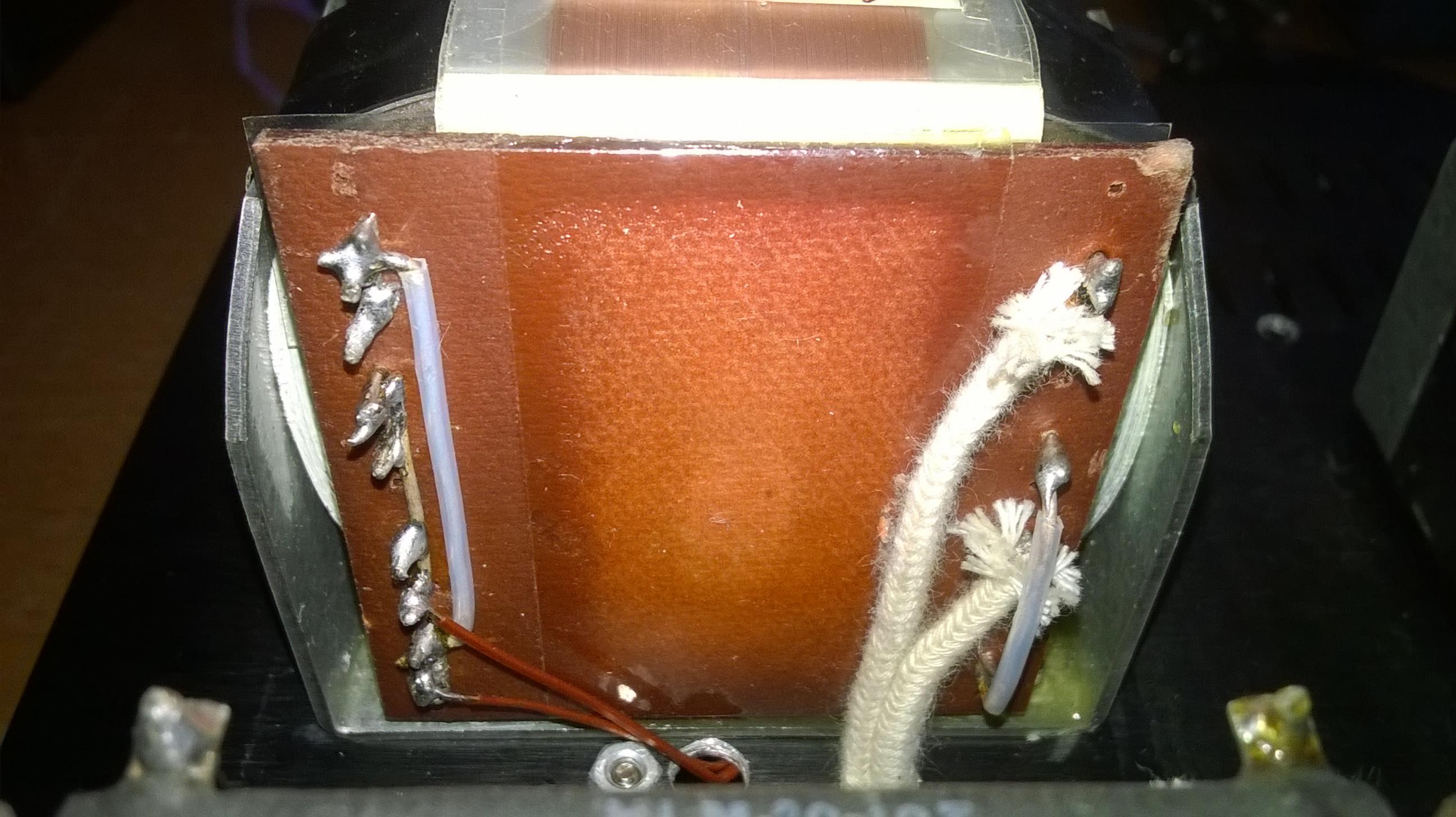

hi Felipe,

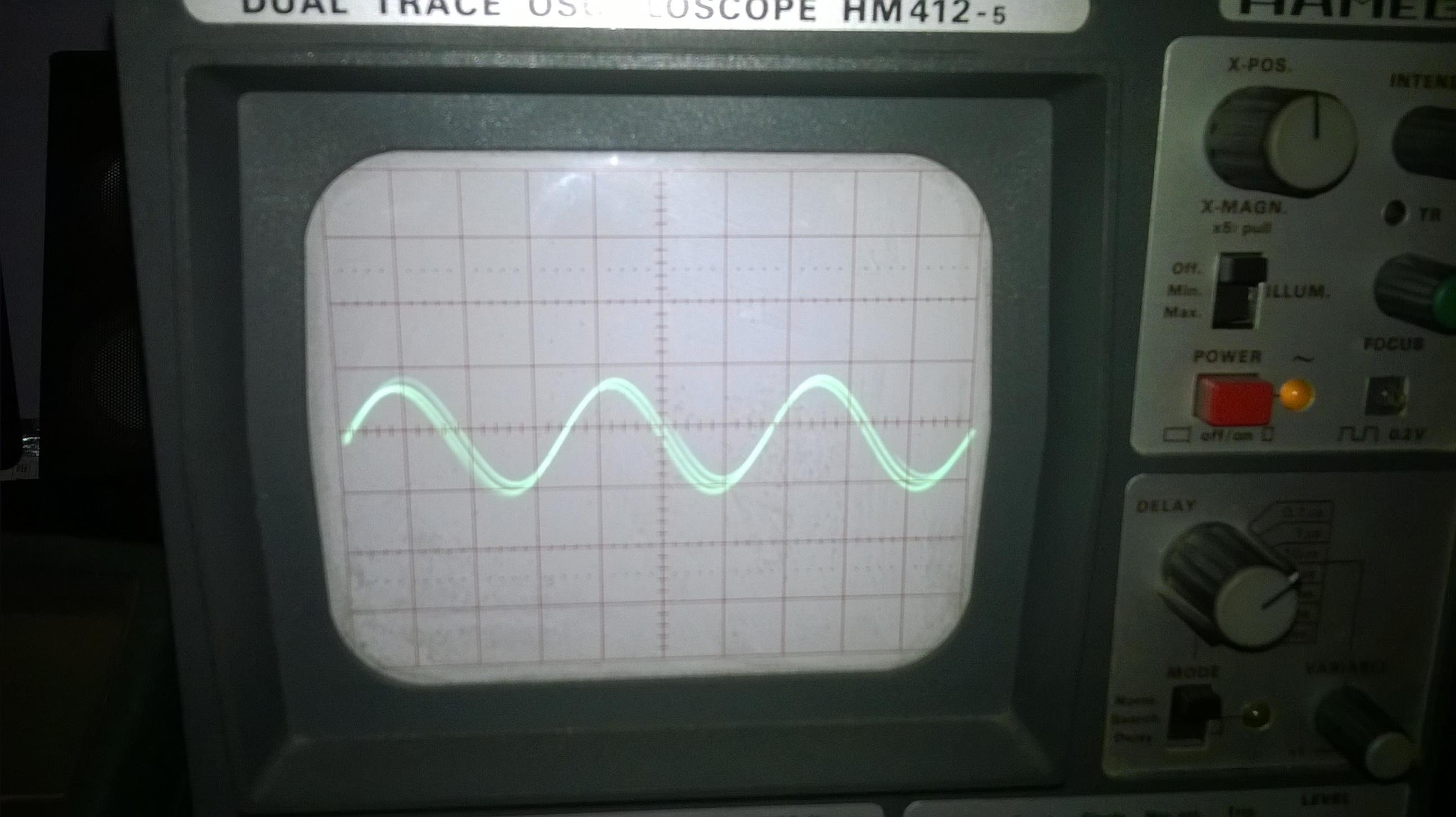

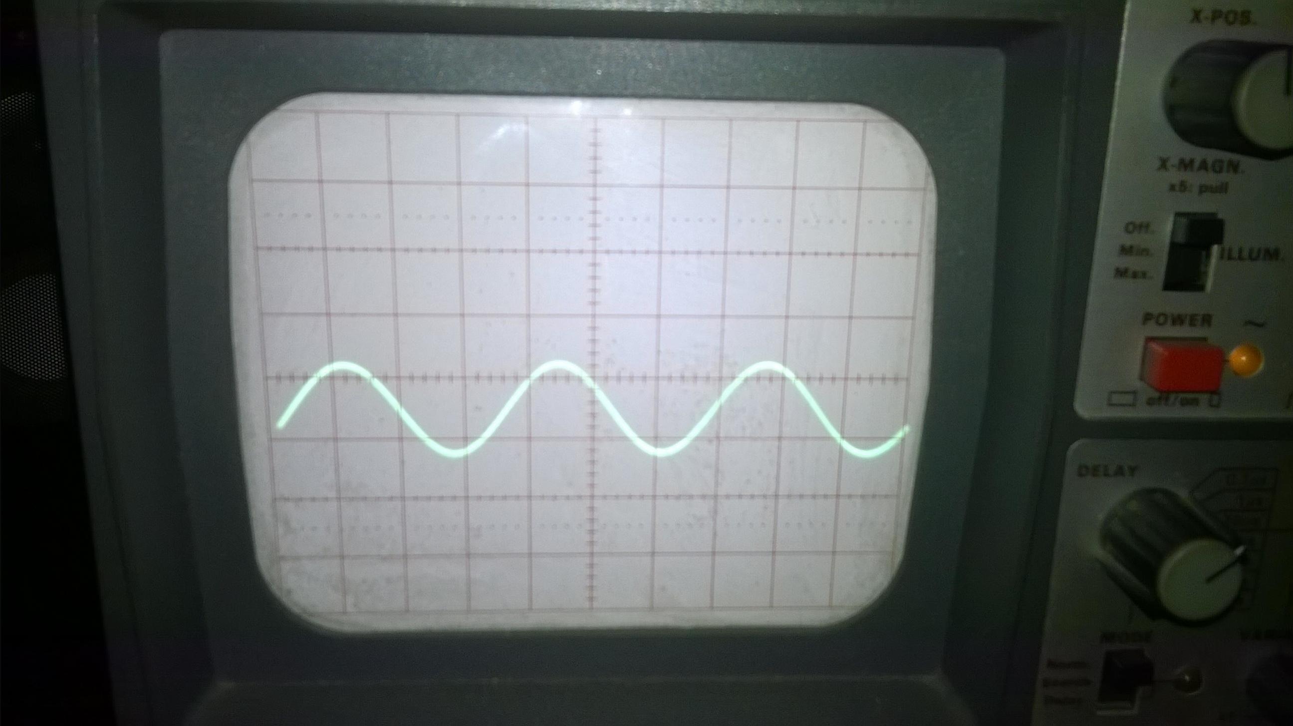

1. The scope pictures are input and output?

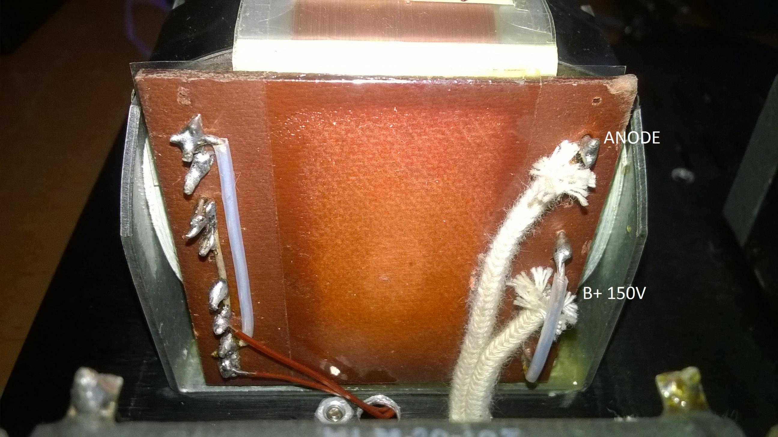

2. If the gain is not correct, maybe the transformer is not wired the way you intended. If you need help with the wiring, you must give us a link to the exact model of transformer you have, and draw exactly how the transformer has been connected. With Lundahl, it's more complicated than with other maker's parts.
Joined 2009
Interstage transformer pics, cotton wire are input/output to anode, red wire are signal output-

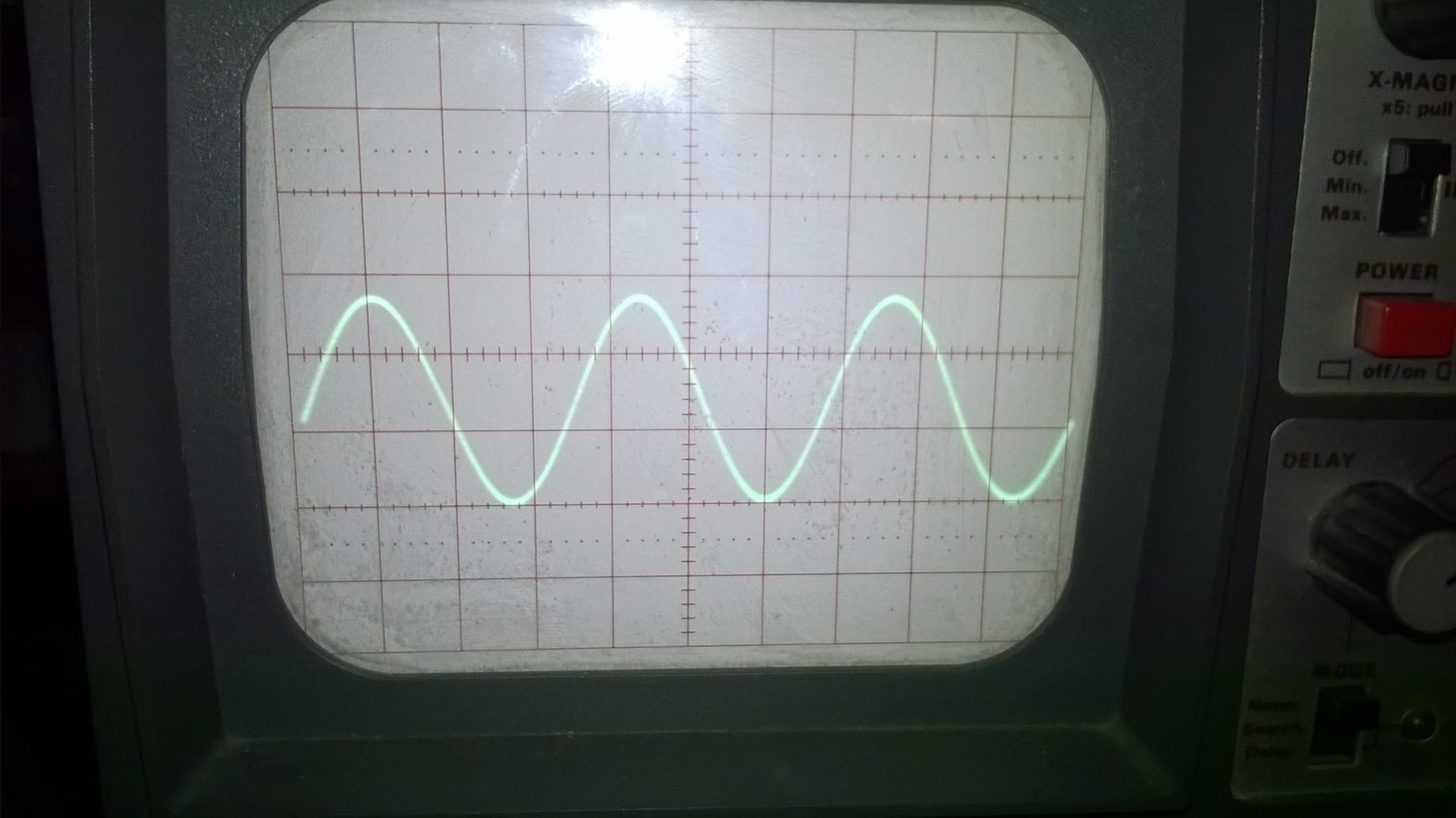

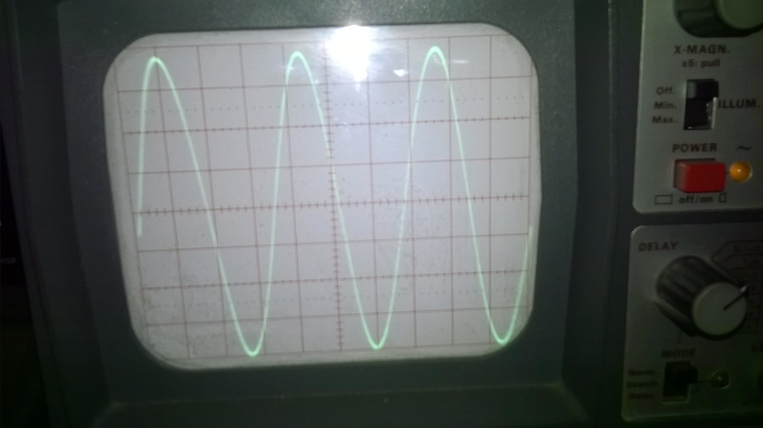

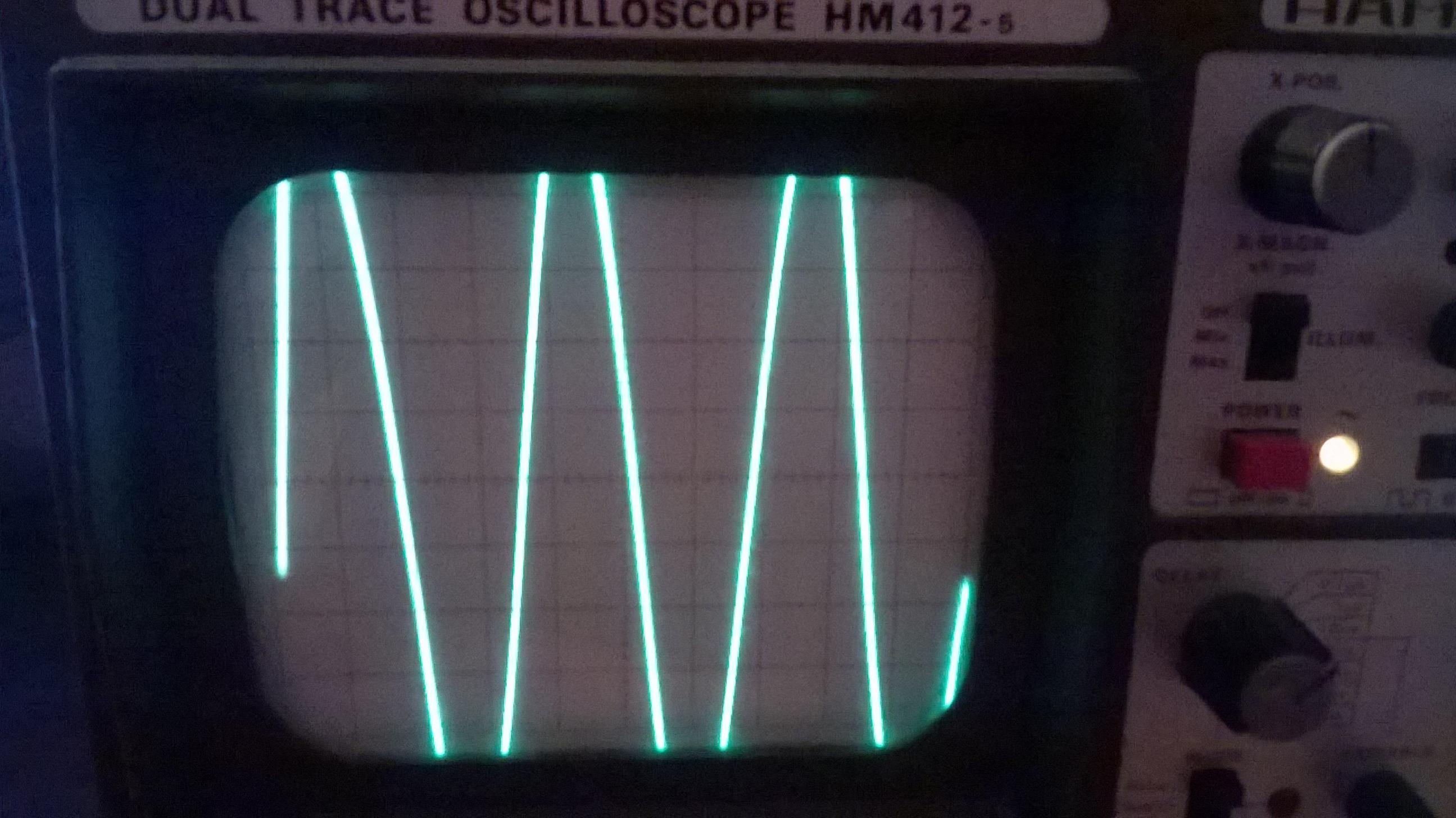

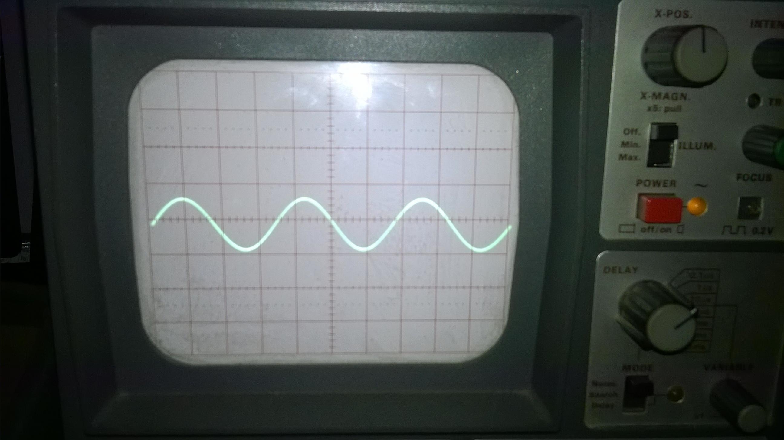

Debug in same way as any amplifier.
Measure all dc voltages.
Measure Anode current. Measure filament current.
Use scope to see ac waveform on grid, anode, and output.
1st scope pic AC waveform on grid, 2nd scope pic AC waveform on anode & 3rd pic AC waveform on output. Also pic with schematic with measurements. Of course all pics and measurements are of the right channel where is no gain.
