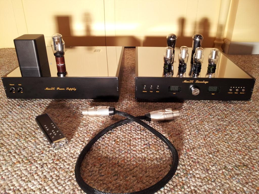

I prefer the sound with the resistor. Also I taked off the 100K grid leak resistor.
9R, the best of me. :D
Has anyone else experimented with Bent Audio AVC on output and as volume control?
Yes, my 26 preamp uses the Bent as the output "transformer" and as the volume control, laminations stacked 3x3 for ~150H primary inductance. I also use a Lundahl LL1676 2:1 step-down on the input through which I apply battery bias, so no need for an input cap, and the cathode is directly grounded. Output from the 26 is taken from the mu output of the plate CCS, so impedance is plenty low enough to drive the Bent. Details including frequency response at different volume settings are in this thread a few months ago.
It sounds excellent.
