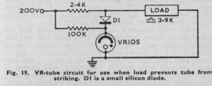

My preamp is a two chassis type connected via umbilical. One contains the PSU for B+, and the two filament regulators. The main preamp houses the HV Shunt Reg and the filament boards. The schematic is similar to this:

Probably oscillating. One, or some, or all the regulators.

You would need a scope to check for oscillations. Even with the K&K shunt you are dissipating a lot of wattage, can you adjust the output voltage to see if it is working, also check the shunt milliamperage?
The other thing is the choke input supply, these can be troublesome.
If the motorboating is of low enough frequency you can use 10 ohm resistors in series before and after the shunt and check for AC with a multimeter.
I would also double check grounding, with my dual case build I put the star ground in the power supply chassis, I vaguely remember having motorboating and it was a scatterbrain grounding mistake.

Please make sure that the last B+ cap (C2 in the schematic) is located in the Signal-chassis. It should be mounted near to the CCS-input for the Shunt Regulator.
In the same way, if the supply cables to the fillament Regulators are long, a 1000uF 35V Panasonic FC or similar (low impedance) cap should be used at the input of the regulator PCBs.
And to answer an earlier question: the input-output voltage of the filament regulators is too high.... 5V is ideal, there is little to be gained from increasing above 5V, and the transistor Q5 will get hot above this. If you have raw dc-to-output difference of 10V, this must be reduced, to 5-7V.
As others have mentioned, please check that Ground-Central is on the signal chassis, near the input socket.

Hello Abe, I think the quickest item to try is B+ regulator stability. Please add some HV capacitance located near the input circuit of the B+ CCS/Shunt regulator. 22uF or more for preference, but even 10uF may be enough to stabilise it.
Before using the amp for a long period, the input-output voltage difference for the filament regulators (10V as indicated) must be reduced to 5 .. 7V, or the transistors may suffer from overheating.
