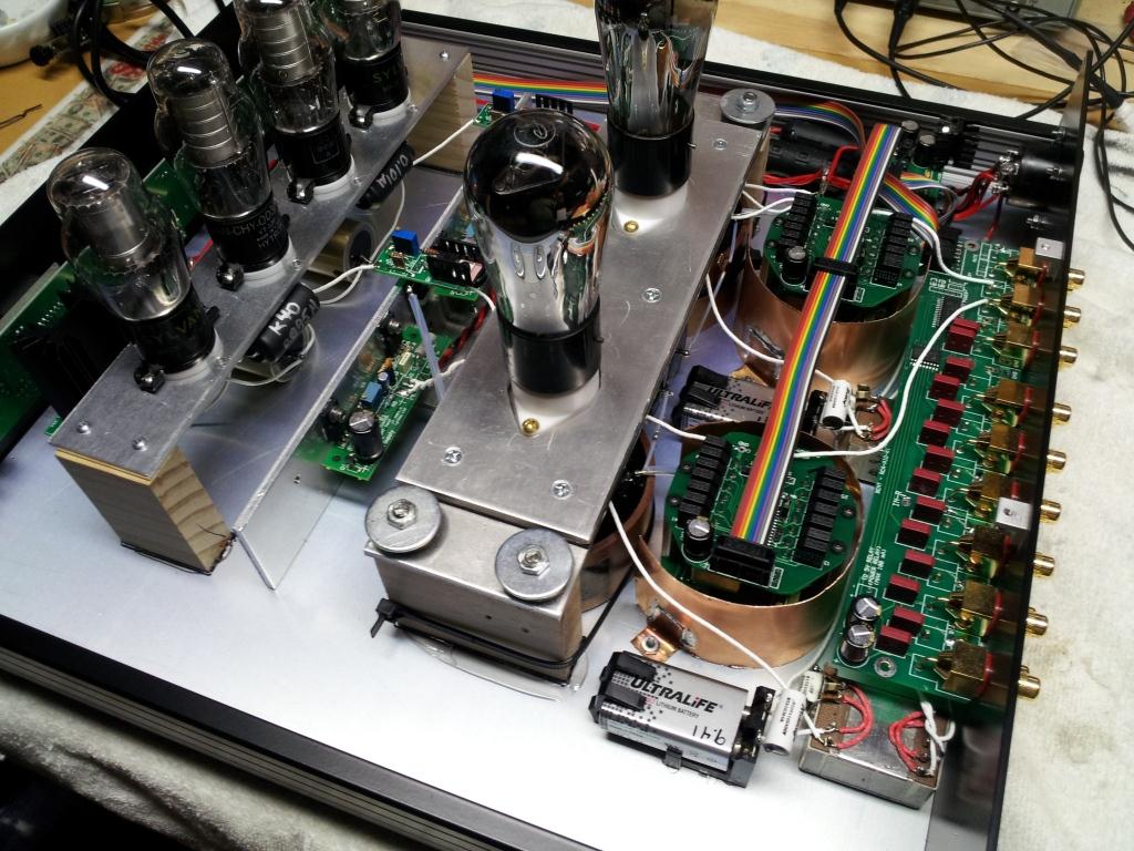

I always go through the same routine with filament supplies.
1. On the bench, test the Reg (with heatsinks) connected straight to the two filament pins of a UX4 socket with the 26 in it. I have a bench supply of 30v, 2A (Thurlby Thandar). I gradually increase the voltage up to 5v above the filament voltage - in this case up to 6.5v. I read off the voltage on the filament pins while I'm doing this. I also read out the current on the bench supply, which has a digital readout for volts and current in two separate meters. I wil use a 26 tube that gives me around 1.5v and 1 amp, so I know the tube is in good condition. I then adjust the voltage reg so I get the desired voltage on the filament pins - shall we say 1.5v. I might settle for a starved filament, like 1.4v. I'm now good to go - the filament reg works correctly with an input 5v above the output.
2. I now disconnect one side of the filament wires and place the cathode resistor between the wire from the Reg and the filament pin on the socket. I now have filament bias. I calculate the supply from the Reg that is needed. A 10 ohm resistor at 1 amp gives me 10v bias. Add the 1.5 ohm filaments and we have 11.5v which the Reg needs to supply. So the input to the reg will be 16.5v. I gradually increase the bench supply voltage to 16.5v, measuring the voltage across the filaments of the 26. I'm again aiming for 1.5v. I trim the Reg to get this voltage (or 1.4v etc). This tells me that I'm good to go with a 16.5v supply.
3. I then connect the actual filament supply instead of the Bench supply. The actual supply has to give me something in the range of 16-20v. I will have calculated the size of the transformer needed for this. In my case I use choke input (Hammond 159ZC) so I've factored in the voltage drop for the DC resistance of the choke (0.7 ohms), and I'm assuming the usual calculations for choke input. I connect up the filament supply. I tweak the supply with a small capacitor in front of the choke to get a supply voltage close to what I want - 17-18v will be fine. I'll try caps in the range 100 to 1k ohms, and the voltage will increase with the size of the cap. When I have 17-18v I'm good to go. I then measure the filament voltage and again adjust the Reg so I get 1.5v (or 1.4v etc). I've now finished testing
4. I install the Reg in the preamp chassis. I measure everything again - filament voltage, bias voltage, supply voltage etc. I then leave the supply running for 30m to make sure nothing goes down.
I see numerous posts about problems with implementing filament bias. I strongly urge you to buy and use a good bench supply. A 30v, 2A one is great for this, and it should have two meters - volts and current. You have to constantly measure volts and current when you are building filament supplies for filament bias, and you have to make a number of fine adjustments. Do it all on the bench first and save yourself grief. You must KNOW all the voltages are correct before you install your filament bias supply in your chassis. Follow the correct procedure step by step, be careful at all stages, and measure, measure, measure.
If you use Rod Coleman regs which I and many others recommend, make sure Rod gives you the right resistor values for the filament bias you intend to use. Tell him when you order. The resistor values differ according to the supply voltage you need to provide. He is well aware of all this and gives detailed instructions with his kits. Rod is an uber-professional guy!
I attach a picture of the bench supply type I use. You can use something similar with dual readouts for volts/current. Should be plenty on ebay, new and used. Like I say, 30v at 2A is good for filament bias. I use filament bias for ALL my stages - even the outputs which are parallel 4P1L in PSE. The supply voltage for those is 28v at 1.3A with a 15 ohm cathode resistor. In actual fact, I have a few Thurlby bench supplies and as we speak my PSE 4P1L outputs are running off two 30v 2A supplies into Rod's regs. If you have a couple of bench supplies you can be lazy and use those. They sound great.

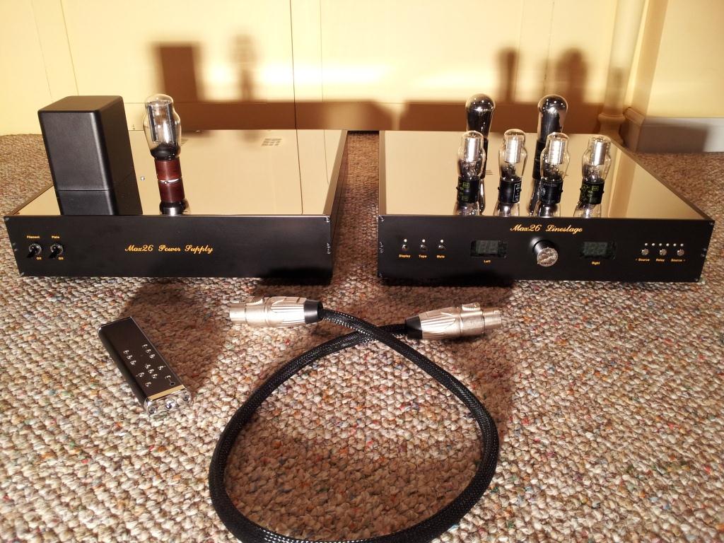

Hello guys!
Thank you Andy for your valuable time and tips! As always, It is so easy to understand how you explain things to me.
Anyways, I now have 1.48Vdc at filament for both tubes(measured between pin 4 and 1) and 9.67 Vdc and 9.9 Vdc on each 10R cathode resistor. Also, I have from CCS/Shunt Regulator measured 150Vdc regulated after CCS at 30mA resulting to 145 Vdc for each plate of the tubes. I kept this figures for about an hour and re-adjust a tiny bit on the filament voltage to where each are sitting now at around 1.48 Vdc. I am good to go!
Just waiting for my input selector rotary switch and I will take a listen probably tonight or tomorrow. I will get myself a decent power supply for setting the filament bias boards.
